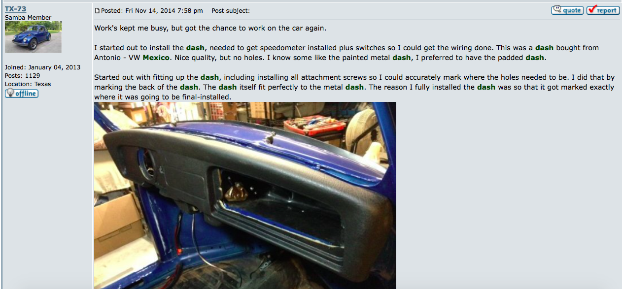

PostPosted: Thu May 09, 2019 3:57 pm    Post subject: Re: Jbugs or Cip1 for new dash pad?? Reply with quote
I sold to TX-73 (Samba member) one genuine VW dash pad, he had to cut perfect holes to install the switches.

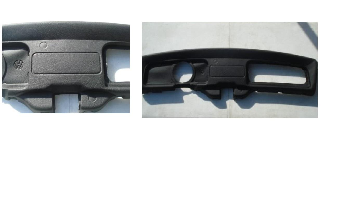

As far as I know, Wolfsburg West does not make a dash pad for this car. Most shops sell the West Coast Metric reproduction, which is the best thing that’s available in a quantity large enough to stock it. For many parts, an individual person can buy NOS, but 100 people can’t.
I have seen a cheap alternative but wouldn’t think of buying it. The Empi 4436 dash pad has the vents moulded into it, unlike the original. I’m not sure if Empi or Dashes Direct manufactures it. See the reviews here.
https://www.amazon.com/Replacement-71-76-Super-Beetle-71-72/dp/B00BJPY7K4#customerReviews
The best answer for an individual is to buy the NOS VW Mexico part and cut the holes. When the stock runs out, then everybody will benefit from others’ experience fitting the WCM reproduction.
