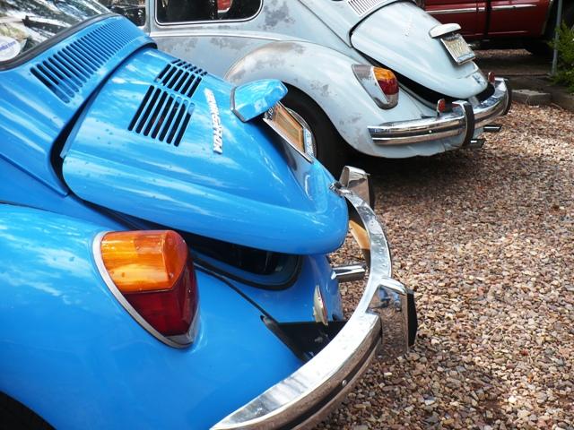

Here is my resolution and it does lower my oil temps by fifteen degrees, rain or shine.

I had an issue once in over 3 decades with lid standoffs and rain, but that was torrential, and dried out enough to start the next day. Yes, I'm in Arizona. 2 VWs with lid standoffs.
But I never had any issues driving through a rainstorm.

Ok, I'll ask. Why did you put these on? Your bug appears to have the four rows of vents in the engine lid. Are you still running that aftermarket air filter?
Most people install deck lid stand offs due to having bugs with no vents in their engine lid. Getting more into the engine can be very beneficial for folks who live in hot climates. My 67 bug in Arizona ran a bit hotter than I liked. So, I tracked down a 67 convertible engine lid with the vents in the lid. It dropped my engine oil temps 15°'s.

You should ditch the aftermarket filter. They are nowhere as good as the Original oil baths or original VW air filters.
The stand offs were also a "kewl" feature that the California look bugs ran on their VW's back in the 80's. Again, it let more air into the engine compartment to help with the temps. Most folks using the stand offs where running much bigger engines with dual carbs, dual mufflers and other race features. I liked the look of them and ran them on my bug back then too.
The downside is the engine would get really wet when it rained. As time ran on into the late 80's and 90's, people tired of their wet engines and started buying convertible deck lids with rain guards. This allowed the additional cooling air into the engine compartment and the rain guard kept the engine dry.
