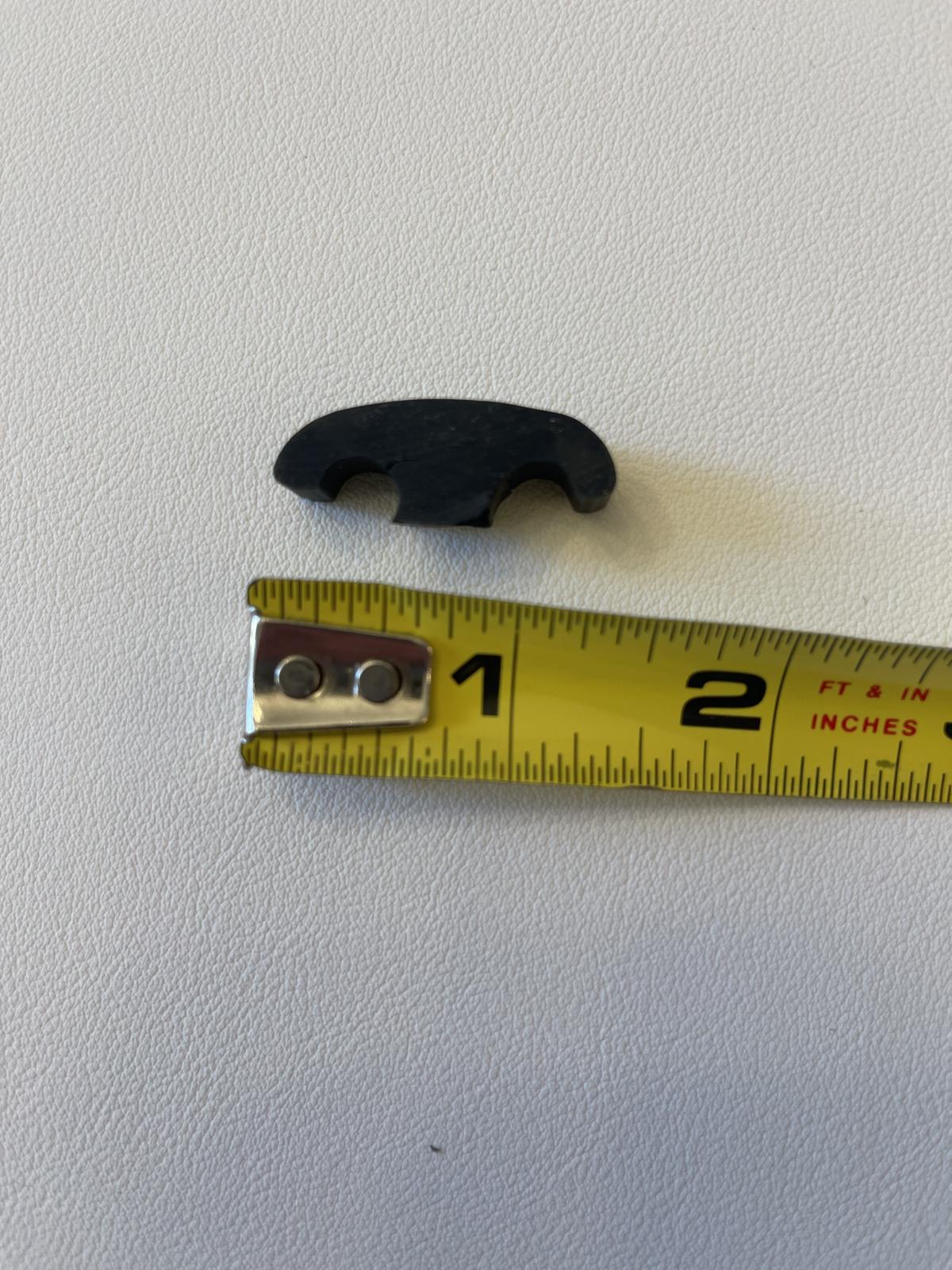

Found this in the rear cargo area of my 1974 Bay Window Westfalia. Is it a bus part? It is made of hard rubber/plastic and appears to have broken off in the middle. Thanks in advance.

Looks like a broken snubber for the rear hatch springs. Part #19

@SGKent, you're definitely right. Where did you find that schematic? Thanks!
Looks like the part number is 211-829-147B

https://www.vw-t2-bulli.de/michaelknappmann/fiche/bildtafl.htm
