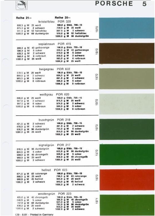

PostPosted: Tue May 05, 2020 1:13 pm    Post subject: Re: Paint code Reply with quote
Maybe this will help. Porsche used Glasurit paint at the time. Glasurit has a pretty extensive website to find color information too.
