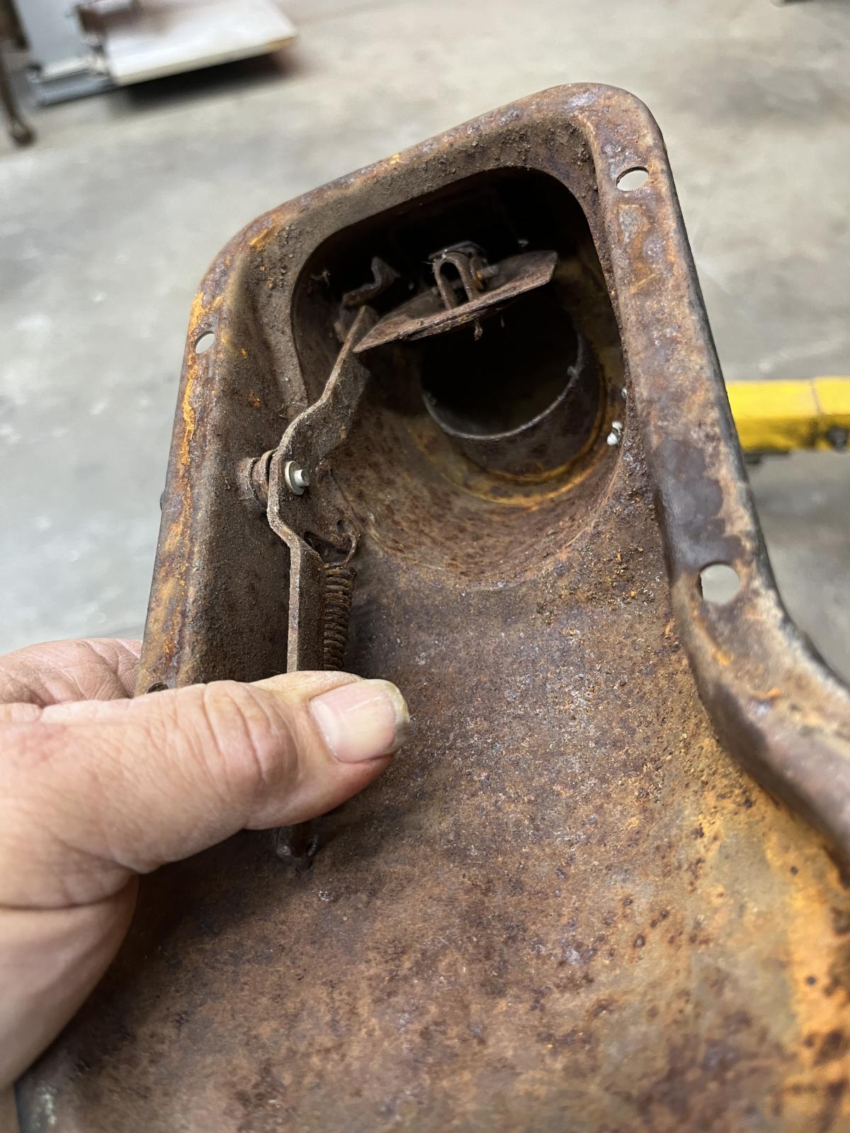

alex857 wrote:
Hey Jimbo,
great work.
Concerning your picture:
check the flaps on the letout: It looks like there is an asbestos layer like on later heat exchangers. And it looks like the asbestos is already ruffled. You don´t want to breathe in asbestos when turning the heat on.
The problem is common on later heat exchangers (63 up) and might be the same here: When those flaps get old, the asbestos layer disintegrates. Sad
Think about ways to neutralize it. Quick and dirty might be to paint it thickly with heat resistant paint to kind of glue the asbestos fibres together.
Thank you Alex! I was wondering if the remnant bits were asbestos. I will get that taken care of before moving further along. They are not in good enough shape, plus I do not need anymore exposure than I have already been exposed to (General Contractor)!

RustPatch
Joined: August 07, 2007
Posts: 137
Location: Maple Ridge BC Canada
RustPatch is offline
PostPosted: Mon Oct 21, 2024 9:17 pm    Post subject: Re: Jimmy V's 54 Oval Project Reply with quote
Curious about what you're gonna do there ... can we just go gasketless? I haven't found much on the forum (or anywhere else really) about what to use as an alternative.

VW_Jimbo wrote:
today I spent 6 hours troubleshooting a 4way switch issue. Turns out the electrician that swapped out this customers panels, fried some lighting circuit wires, IN THE WALLS! Took me 5 hours to find out which one in a 3 light, 3 switch, 4 way circuit, buried in one other lighting circuit and 2 other duplex circuits, was the issue! By the end of the day my mind was done!
This sounds like an absolute nightmare ... You must have some serious patience.
VW_Jimbo wrote:
my first thought, is to incorporate a soldering mat or welding blanket material into a thin pliable seal. Maybe even the material (leather) welding gloves are made out of! Bet any of those would work! Thinking the leather may be the best band for the buck. It is just an endurance question, now. How long will leather hold up in that type of environment!
Great ideas! It's a pretty thin seal, There's about a 0.050" gap it fits in. I had considered graphite but graphite dust is apparently pretty bad for you.

RustPatch wrote:
Serious patience for trouble shooting odd stuff! That is what makes me the most money! No one likes trouble shooting. I do it a few times each day! Love using my brain and connecting dots, then proving I was correct!
Yep. Just about any metal is a serious health concern if ingested. Be sitting in your GI track or in your airway. It always is a bad thing. That’s why I was considering leather. It can be purchased fairly thin and is pliable. Holds up to heat okay and can be glued with nothing toxic, like Elmers! it really boils down to the heat. I have never measured the temps at that point in the heater system. So, that would be the thing to do. Hopefully not too high.
