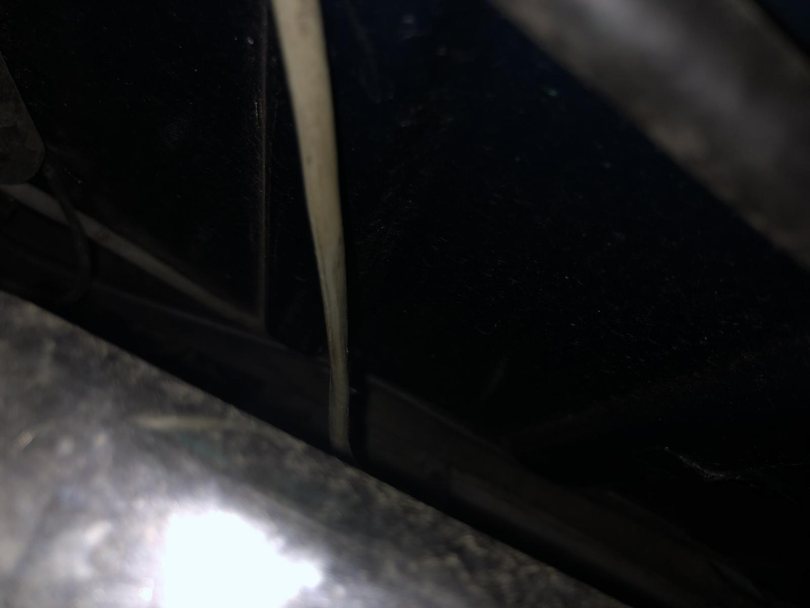

See how well you can observe details in the engine compartment with the camera flash on? Very Happy
With so many cooling tins missing from the rear of the engine, I wonder if the cooling tins are present on the FRONT? The fan shroud and cooling system on your engine is "most likely" a "doghouse" system. The engine oil cooler is positioned on the left half of the engine. The hot air coming off the cooler to the left is diverted downward and forward via 2 sheetmetal ducts. You can easily feel for these ducts (engine off and cold) by reaching over the top of the left air cleaner towards the middle of the engine. You can also aim the camera in that area, and we should be able to see if the 2 ducts are in place. Hopefully so.
Here's a shot of the 2 ducts in place- the "triangular" duct above the "exit chute".
If those 2 ducts are not in place, you can see/feel the oil cooler inside its shroud cover-
4 of the 6 missing engine tins noted beforehand can easily be installed with the engine in place, using just a flat-blade screwdriver and those tin screws I listed before. One of the 4 tins requires removing the crankshaft pulley, so that you would need a large socket or adjustable wrench to get the large bolt off, then a pulley puller to remove the pulley without damaging it. You can keep the current, chromed fan shroud and cylinder cover tins for now and enjoy driving the car for the summer.
You can also fit an engine perimeter seal which does not require the engine to be removed. You first fit the 4 pieces of tin, then push the seal down into the gap between the tin edges and the body. Its a foam seal with an "H" profile, that you turn sideways and push into the gap. It's from a VW bus. This seal is about 3x as $$ as a proper Type 1 rubber seal, but for that you need to remove the engine. This bus seal is just as effective, and will get you driving with much more peace of mind much quicker. http://vwparts.aircooled.net/Engine-Compartment-Se...11-225.htm

Wow thank you so much for your informative post! I did try to take some pictures aiming down the back of the cooling tin but not sure what you can tell from these. I will try to get my arm down there to feel for what you mentioned.
I think I will attempt the stock muffler i bought. Any ideas what to use to plug up the holes for the heat risers I wont be using? Or if you even have to plug them?

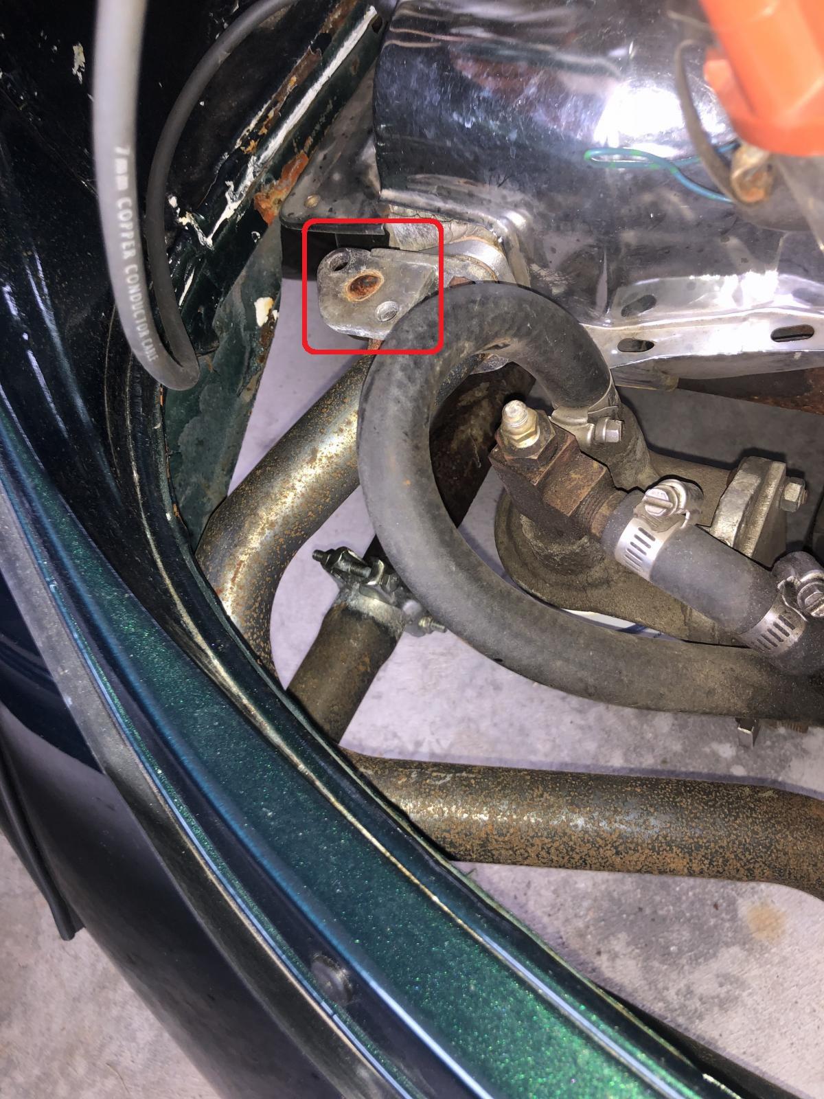

Thanks! So sorry to be dumb, but where do you see the heat risers not blocked off?
In this picture, just left of the large black hose. See the silver 'plate' which has two holes through it on each side with a rust colored center spot? It is connected to the silver exhaust pipe. Just to the rear(towards rear of the car) of the shiny chrome cover seen in this picture as well.
That's the heat riser. Also there is one on the other side.

No front engine cooling tin either, or thermostat linkage, likely no thermostat or flaps. Again, your first stop should be http://awesomepowdercoat.com/. There's no avoiding this.

Heat risers are closed. They come that way so you're OK.

Your aftermarket exhaust has heat risers, but they aren't blocked off. I think that's part of your noise problem. I have the same muffler, and it is pretty loud, but yours isn't completely "muffled" with those ports open. Block off those ports and see if it helps the noise at all.
That's something easy to try first.
heat riser block off plates:
https://www.jbugs.com/product/3447.html
Lots of times, on aftermarket headers, these risers are there but have to be drilled out to be open. It also looks as if they have been welded up. THe lack of carbon/soot suggests that these have not been drilled so there is no reason for the block off plates.

But if he replaces the existing muffler with a stock muffler the heat riserconnection will have to be blocked because his intake manifold lacks the connections.
I would suggest cutting two sheet metal covers to fit and use the gasket that comes with the muffler

^^ I agree. However, you still have the "chore" of drilling two 1/4" holes in each cover so that you can fasten it with two bolts into a stock muffler. Factory bolt size at that location is M6 x 1.0, about 3/4" long. Or, you can buy this cover set, made out of approx. 1/8" metal and already drilled for the mounting bolts.
http://vwparts.aircooled.net/Pre-Heat-Riser-Block-Off-Kit-Pair-p/pre-heat-block-off-kit.htm

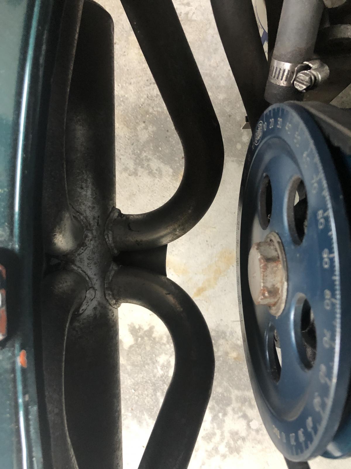

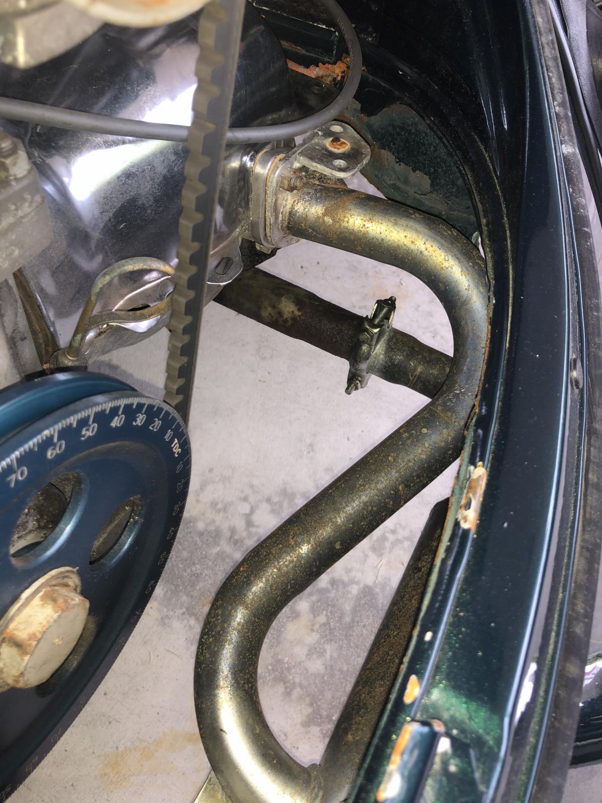

OP, you photo'd the right side of the engine and shroud. The oil cooler and cover tin are on the LEFT side towards the front of the car. Just stand at the left rear fender and aim inwards, mirror image of what you did on this last set of photos.

Ok not sure if these pictures did the job or not.
I also think I have bigger issues then the Air Tin and muffler swap. Took her for drive tonight and lots of sputtering when accelerating in all gears with gassy smelling exhaust after the sputters at times. It’s much cooler tonight here then any time I’ve driven it if that matters at all.
For more reference, I found out the seller restored the body but the engine was in the car when he got it.

That bottom photo shows an exposed oil cooler, which means more missing tin work.
Your best bet, as others have suggested, is to remove the engine and get all the tin on it properly.
I know it seems overwhelming, but it is not terribly hard to do. We aren't trying to overwhelm you, we are all just pointing out problems that are solvable, and that will help your experience be enjoyable! It will take a little bit of work to get there, but then you'll have a bug that is dependable and fun.
