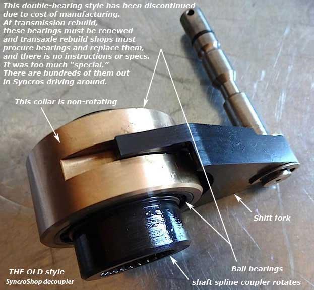

^^Here's a pic of an old-style Syncroshop decoupler that engages/disengages the splines. These spline-engagement decouplers have been in-use for over 15 years and there are no reports of any spline wear.

^^ Above is a pic of the "old style" shift-mechanism on the RMW decoupler. Its from a few years ago.
^^ Here's a pic of the new style since appx ~2015.
Its a normal shift fork like the others (not de-spun on bearings) Look at the little nubs on the shift fork. The spline collar and shift fork are 4140 steel. Beautiful stuff, CNC components worthy of an $8,000 transaxle.
