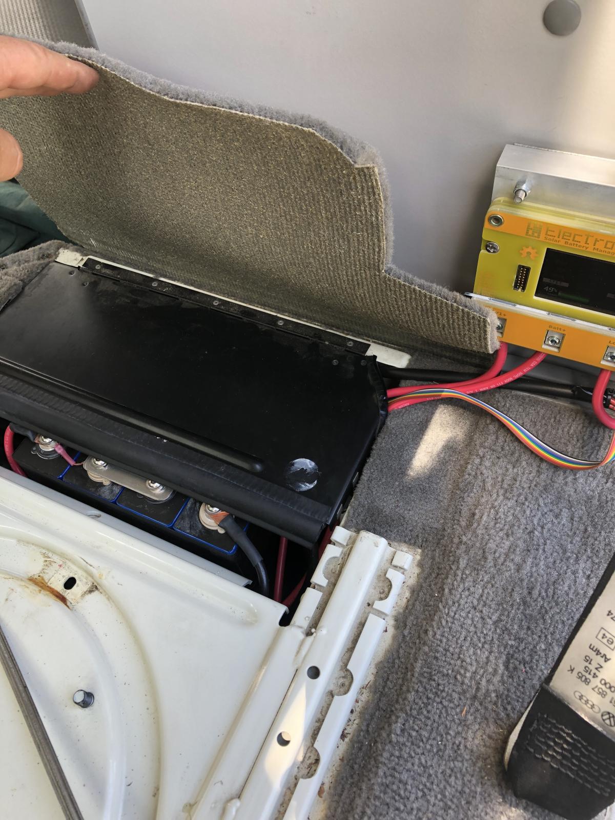

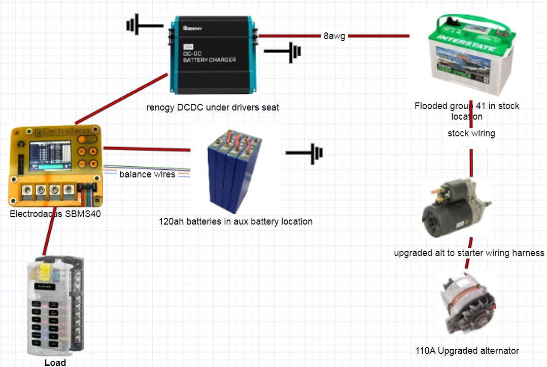

Wanted to share my latest and greatest setup.
4x 120AH LifePo4 Prismatic cells that fit very nicely in the AUX battery space. These are made by CATL which is a huge Chinese Lithium manufacturer (OEM supplier for BMW and a number of other large EV makers). I have measured over 120 usable hours using conservative voltage cutoff settings on these.
These are industrial cells (they tend to look a little rough) that can be sourced on Alibaba and the like for around $500 (don't forget those tariffs). One of the issues is that they are drilled for M4 studs at the factory which is pretty small, and a lot of resellers are redrilling them to M6 (so check if you are going to order). They also tend to have the serial number scratched off. I have been told that the production lines are used for major contracts during the day but they keep them running at night for non-OEM resale, presumably the profits on these are pocketed by management and serial numbers are removed to avoid being traced. Don't know how true this is but it's a story I heard from multiple suppliers and the serial numbers are consistently removed.
I am using an Electrodacus SBMBS40 to control the pack - which is an incredibly powerful and flexible piece of hardware. It balances the cells, provides a real time State of Charge Meter (similar to Victron BMV). Will shut off charge if temperature drops below a certain level. Will shut off the alternator charge once cells are full, and will disconnect the load if the cells are drawn down too much. It also has WiFi, logging and is almost infinitely customizable.
Because these are Lithium, there are a number of major advantages:
1 - Huge increase in energy density. My batteries weigh 25.2lbs , are smaller than the starting battery, and store more (usable) energy than 2 GC2 deep cycles at 140lbs
2 - Faster charging. These batteries can be charged at 40A+ all the way until full. No float or anything else to deal with - so you can go from empty to full in ~3 hours.
3- Huge increase in cycle life. These are are rated for 3000 cycles so they should outlive most of our vans...
There are also some drawbacks:
1 - Need for a Battery Management System. A BMS is a somewhat lose term with no defined functionality. Ideally it should do the following:
a) Balance the cells - unlike lead acid the cells are not self balancing, a BMS will reallocate energy from the the cell with the highest voltage to the cell with the lowest.
b) Provide overvoltage/undervoltage cutoffs to ensure you get the cycle life that you paid for
c) Disconnect the charge source if temperatures drop below freezing (Lithium batteries will be permanently damaged if you charge at sub zero temps)
2. Another item to think about is alternator charging. This gets a little controversial since there are a number of drop-in LifePO4 manufacturers that say this is ok to do (battleborn being one of them), The problem with this is that these LiFEPo4s will essentially max out your alternator (they could easily pull 70+amps) and this will take a pretty heavy toll on our aging electrical and alternator systems. The other issue here is making sure that the requisite 14.2-14.6 volts are delivered to the battery and the last issue to solve for is how to disconnect the battery from the charging source once full... I use a Renogy 40Amp Dc to Dc charger to ensure that all of the above needs are met, but others have bypassed this step...
Lastly, a Lifepo4 setup can be achieved on the cheap if one already has an adequate solar setup... A victron or similar MPPT controller has LifePo4 setting, has a temperature input and can be programmed not to charge below freezing. At that point a basic BMS can be sourced for $25 https://www.aliexpress.com/item/32875971231.html add a Victron Battery protect for $40 to disconnect loads if batteries get too low and you have a relatively cheap and fully functional Lithium system (with no alternator charging)
For those interested in the subject I recommend Will Prowse's youtube channel and website
https://www.youtube.com/channel/UCoj6RxIAQq8kmJme-5dnN0Q
https://www.mobile-solarpower.com/
(renogy DC to DC 40Amp charger under the swivel seat)

Nice integration!
I've also played with 12V lifepo4 cells in the past. A BMS is not a necessity if you understand the cells voltage and have a charger to equalized the cell one by one fully charge before connecting them in serie.
To protect the cells from over charge I use a DC-DC* with 14V output (3.5V per cell), but an adjustable MPPT controller can do the same.
*in my case 360V dc to 14V dc.
Depending of the cell quality, it could be need to redo a top charge once a year or less.
Protect the cells from low voltage and low temperature is important, but LFP cell are pretty safe and robust. Accidently, few years ago, some of my cells on a project were drop to 0.1V during few months, bus despite that I was able to recover many with still 80% of the original capacity.

Correct - I chose to go this route because there wasn't anything even at 100AH that would fit that space in an integrated solution (hence gowesty sells a 50AH lifepo4 kit)
Also I found the internal bms solutions somewhat lacking. many don't have low temperature cutoffs, I didn't like some of the parameters being used as well - for example many won't disconnect your load until 12.5V which is already doing damage to the battery. There is also a lack of disclosure as to exactly how these internal BMSs work (ie will they disconnect when individual cells are over discharged or the entire pack is below a certain threshold and thus individual cells may be significantly lower/higher).

i just want to add that using a DC to DC charger such as the Renogy DCC-1212 is THE correct way to tie a house battery together with a starting battery. it provides isolation, charge current limiting, and the correct charge profile for the house battery you've selected. at a $130, it is a no-brainer.

I really like this system. I’m currently using a Victron 75/15 mppt charge controller. I think all I need is the BMS. I think even using a common port BMS will work. Victron says if the BMS disconnects do to low voltage and the PV is still connected to the charge controller, that this will not damage the controller. This is contradictory to what Will Prowse says in this video. https://m.youtube.com/watch?v=_PgthByAYz4&t=1396s
I have a question about if the BMS disconnects because of either low or high voltage and using a common port BMS. If disconnect because of low voltage, will charge from the PV re-open this BMS to allow charging of the cells?
And same, if it disconnects because of high voltage, will it open to allow consumption through the load of the solar charge controller? The use of a BMS is new to me and I am trying to figure this all out.
I also only use 12V appliances and do not use an inverter to use household appliances. So the battery protect is not needed and I can continue to use the Load output of the Solar charge controller to operate appliances. The software of the Victron charge controller has parameters for low voltage disconnect and can be manually programmed.
So with this set-up, I only need the cells and the BMS.
But this does not allow alternator charging.
The Renogy battery to battery charger looks great and is an option for sure. I want to see what the Victron battery to battery charger will do. It is supposed to come out by November 2019. I think using all Victron would have easier management of the systems.
Something I do not have, but really should, and especially if using lithium batteries, is a temp sensor at the battery under the drivers seat. This area can be way colder than where my controller is mounted.
I need to pick up a Victron Smart Battery Sense. This I’m sure would also be utilized by the Victron battery to battery charger when it comes out.
Thoughts?

I have never played around with the deligreen style common port BMS, but my understanding is that they will allow a charge if disconnected due to low voltage and vice versa. Otherwise the BMS would be unusable once tripped. I think the BMS and Victron combo (along with the victron temp sensor) is all you need for a solar only setup. It gets messier with the alternator as you already know, a lot of variables involved - battery pack size, alternator capacity/health, alternator wiring gauge. People run 100AH banks directly off the alternator all the time, for me a $120 Renogy DC to DC seems like affordable and reasonable insurance to make sure it runs well
