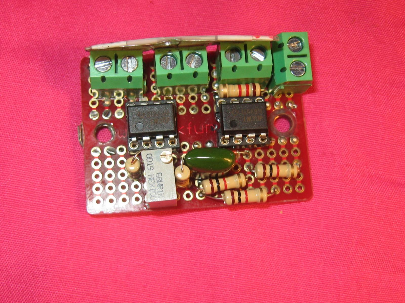

PostPosted: Thu Oct 10, 2019 7:10 pm    Post subject: Re: The New 6 Volt Voltage Regulator Reply with quote
I have a working prototype:
The electronic regulator pulses a MOSFET with a signal to power the generators field. Here Hi is charge, Lo is not charging. The wave form will vary in time hi to achieve the set output voltage . Generator output Levels from 6.3 volts to 10 volts can be set with a turn of the 500 ohm pot.

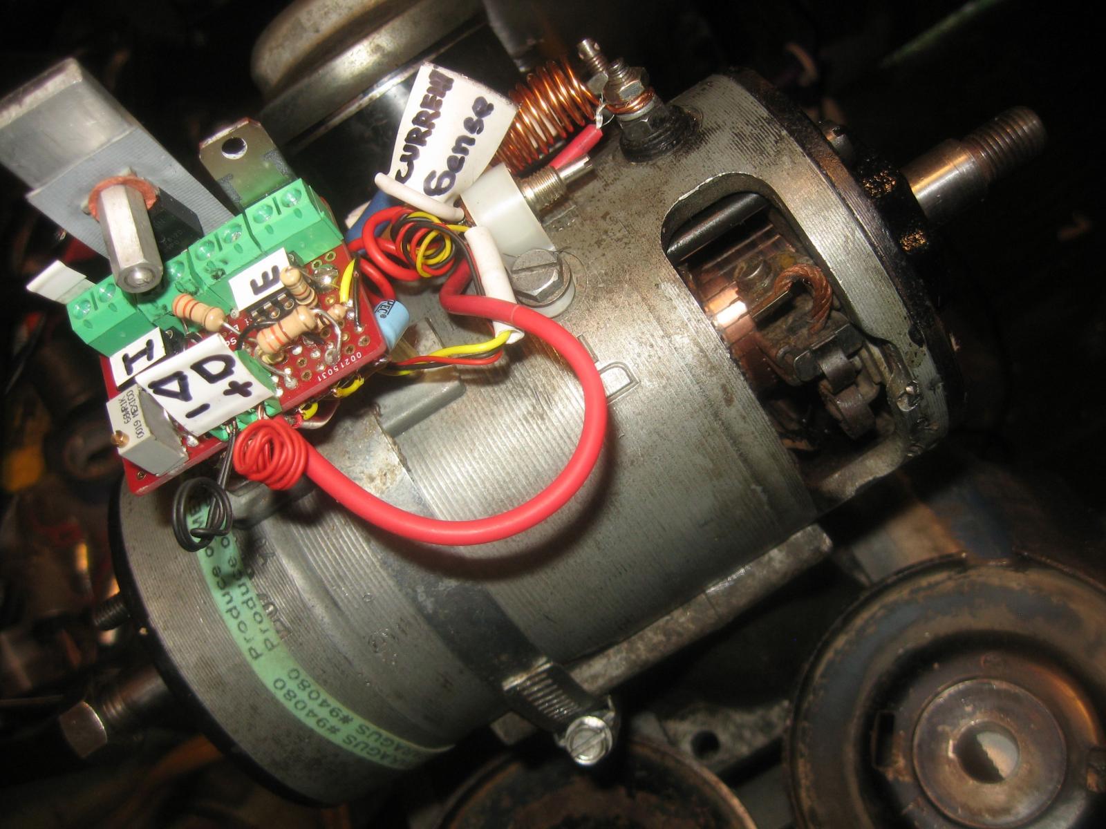

PostPosted: Sun Feb 09, 2020 12:49 pm    Post subject: Re: The New 6 Volt Voltage Regulator Reply with quote
Prototype 2:
Prototype 3:

PostPosted: Sun Feb 09, 2020 1:57 pm    Post subject: Re: The New 6 Volt Voltage Regulator Reply with quote
Yes it sets the generator output voltage. Adjustable from 6 to 10 volts. Care must be taken to not set it too high. I keep it set it to charge the Optima Battery in the car at 7.0 volts. Also there is a pot on the circuit board for setting the current limit which I set by turning on the hi beam headlights and adjust the voltage up to 8 volts then adjust the current pot to just begin limiting. Then go back to 7 volts.
There is another potentiometer for calibrating and interfacing the el chapo current display. Also made a over voltage alarm circuit that's behind the dash that sounds off if the voltage there goes above 7.4 volts.

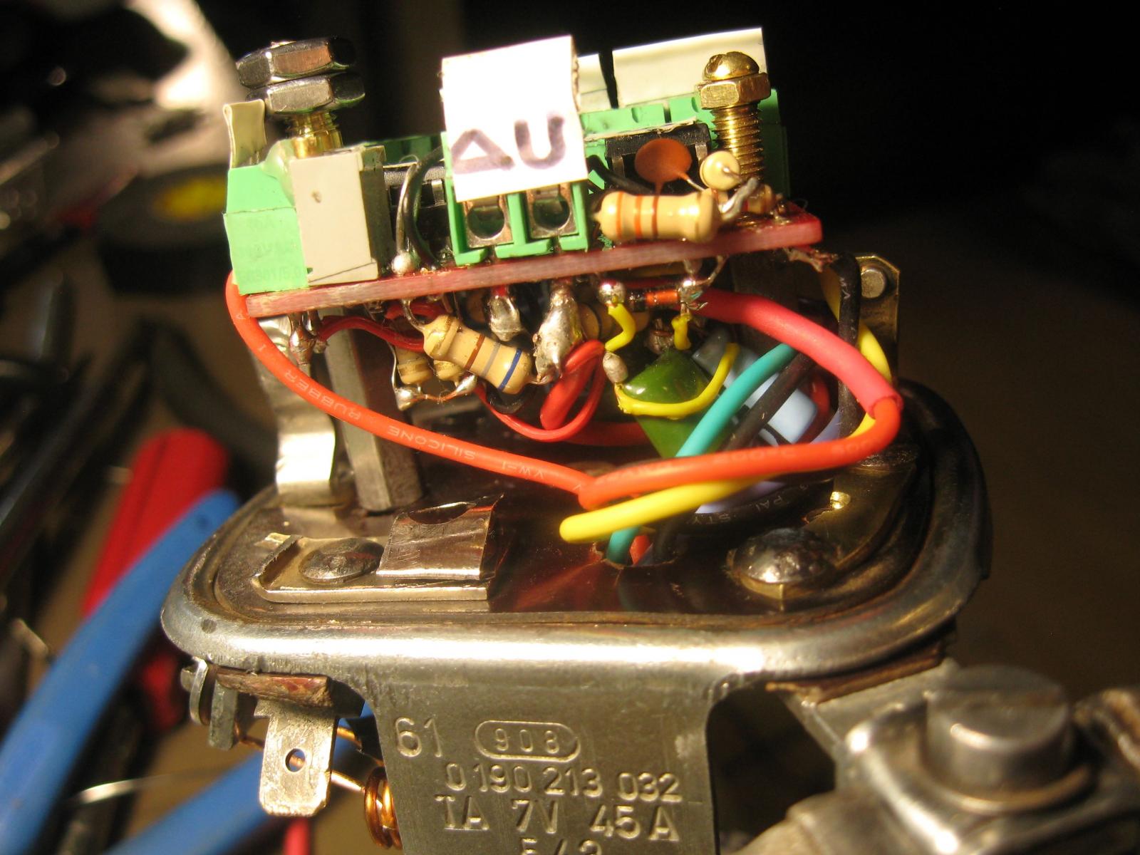

PostPosted: Tue Feb 18, 2020 8:10 pm    Post subject: Re: The New 6 Volt Voltage Regulator Reply with quote
Wow! Might work up front since the battery is there in the 356's. I wonder if the Pre-A's had the same neg ground (bootstrap field to ground to make charge generator) as the later ones and beetles. My 56A had a huge regulator I think it had 3 sets of relays instead of 2 and it was very well behaved.
Well I have been figuring out how to put the electronics into a vw reg housing.
Took my first one I built apart and cut the coils out of a VW 6 Volt Reg and so forth and so on. This is what I came up with. Probably will need better heat sink for the cut-out diodes. I just mounted it on the output arm of the vw reg.
At 50 amps and .34 volts it will be dissipating 17 Watts.

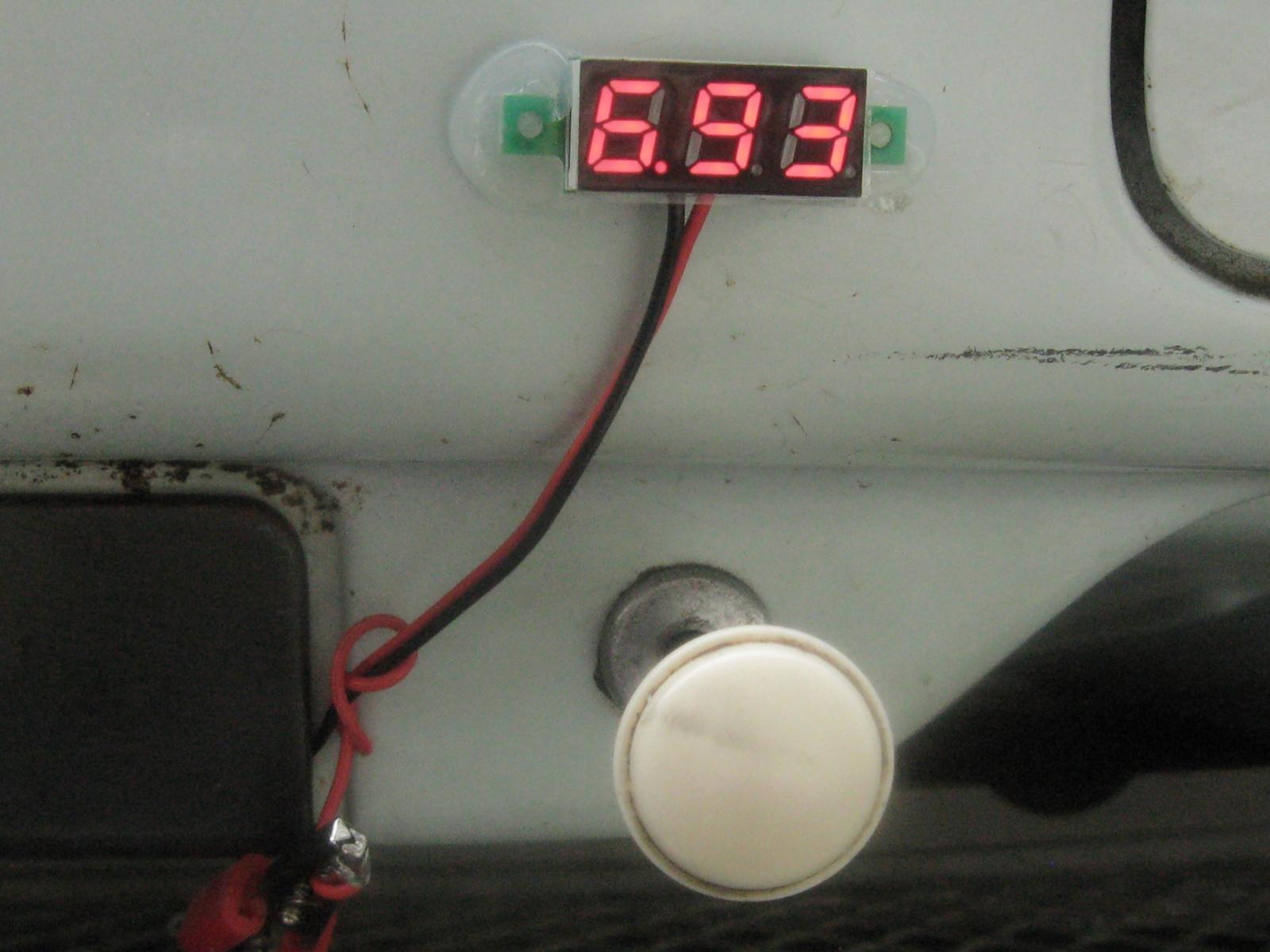

Location: Oregon Coast
Danwvw is offline
PostPosted: Wed Feb 26, 2020 6:14 pm    Post subject: Re: The New 6 Volt Voltage Regulator Reply with quote
Thanks for the input "EverettB"
In the video the voltage display shows the output voltage at the B+ terminal of the regulator which is .3 volts less than D+ So If this particular generator regulator combo idling produces 3.5 volts at slow idle then a generator lamp (if it had one) would see about 6volts - 3.5volts -.3volts or 2.8volts.(Note no Battery is used for a load just one 6 volt headlamp.)
If With a new generator and a mechanical voltage regulator there is no Gen Lamp on at slow Idle then thats better. Note this video is with my first prototype design. Prototypes 2 and 3 are better. These electronic regulators are adjustable from 6 to over 9 volts with the engine reved and are excellent at holding the set voltage.
