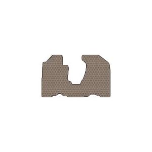

Does anyone know if someone makes a custom molded rubber matting, instead of carpet for the front of the Vanagon? Preferrably insulated.

van cafe and go westy sell some mats that cover most of the front floor.
I read a thread on here about a guy commenting how he scored a rubber front floor at a u-pull-it yard. Not sure what that consisted of, but it sounded like it was a carpet replacement.

Trucks, commercial vehicles and the late L models came with full rubber molded interiors for the front , center aisle and the main cargo area. They are hard to come by so the german rubber floor mats are a decent option http://www.van-cafe.com/home/van/page_484_128/german_vanagon_rubber_floor_mats.html
I have the rubberized interior in my truck and it is nice because I can take a hose to the interior if needed to clean it but I still have the german mats to reduce wear on them.

Occasionally will show up used in the classifieds here: http://www.thesamba.com/vw/classifieds/search.php?...ton=Search
Or this?
http://www.amazon.com/Volkswagen-Vanagon-Custom-Fit-All-Weather-Mats/dp/B003ALNOCW
I don't expect you'll find an all-in-one insulated mat, but some sambanistas have added a layer of insulation under carpet/flooring
to prevent "hot foot syndrome"...(I know this is on my to do list before the next major summer road trip...)
http://www.thesamba.com/vw/forum/viewtopic.php?t=237271

yeah, that was probably me. Was a very lucky find, but wasn't one for sale in the classifieds a while back?
The rubber replaces the carpet, but I left the composition floor pads in place. I suspect in the original install the rubber went right on the steel floor.

Wow that is a cleeeean floor! I have the rubber floor mats in my syncro and yes they are directly on the steel..no composition pads underneath. Your pic makes me feel as houygh I should clean them up even though they aren't dirty:)

Alistair:in this picture,you have the sound proof mat underneath?
If yes,do you know if there are 2 versions of the rubber mat?As I never seen a rubber mat been able to fit on top of them.
I tried myself to be sure.... Laughing

The rubber mating comes in two versions....one the fits automatic and the other standard vans as the shifter areas are different.
The stock insulation used in the carpeted vans has to be eliminated for the rubber mats to fit properly.
http://www.thermotec.com/
I use adhesive backed thermotec without issue under them.

Yes, I have the stock "chipped" rubber composition pads under the black rubber mat. It fits pretty well except at the sides, just adjacent to the door openings (sides of foot well I guess you could say). The holes in the rubber mat are about 1/2 - 3/4" to high to match with the plastic bosses on the body.
Its not a problem really, you really don't notice the mismatch and the rubber mat stays in place fine.

I put in the molded insulation panels from a GL under my stock rubber mat. They helped the noise greatly but the fitting of the rubber isn't nearly as good as before. The noise reduction was worth it though.

They are only available in black as far as I know.
