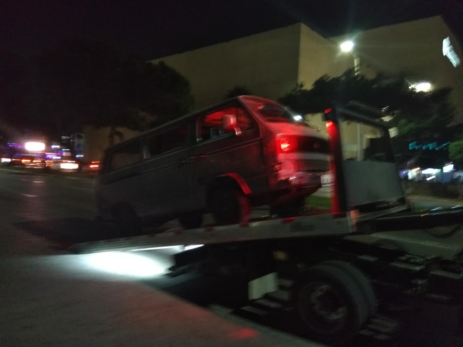

I need some help guys! I've checked some threads on the electric subject of the infamous blue alternator wire
https://www.thesamba.com/vw/forum/viewtopic.php?t=601889
https://www.thesamba.com/vw/forum/viewtopic.php?p=6257153#6257153
and while that could be the solution to my problem I have my doubts heres why: the thing is that my Van went nuts when It was driving it. And I had to tow it...
What it did is that at the beginning the starter wouldnt crank and I had to start it in second gear (thank God mine is a manual) however when I managed to cross the border back to home it when nuts on me, the dash became almost dark, the hazard lights began to blink to fast, and on the dash area or fuse area began to make a sound every time I turned the key on that by the way I have never heard, and when I tried to crank it again the Van was completely dead. That happened on Saturday, Today Monday I connected the battery and the hazard lights where normal. Don't now whats happening maybe it's a region problem Very Happy
Just checked the battery and it's at 11'sh volts so it got drained a little bit, I just tried to crank it but doesn't run maybe needs more juice in the battery ill try to jump start it to see if it runs.
The question is the following:
1.- Could that blue wire bee the problem? Is the blue wire sucking juice from the battery if not connected properly? (I ask this because every few months battery goes dead and it seems that maybe it has a loose wire or something is causing the battery to drain)
2.- Or this blue wire is just an indicator to the dash?
3.- Can I do a continuity test to a specific wire to see where the problem is?
4.- Could it be a relay in the fuse box of the Van thats causing this issues?
Any help would be greatly appreciated.
