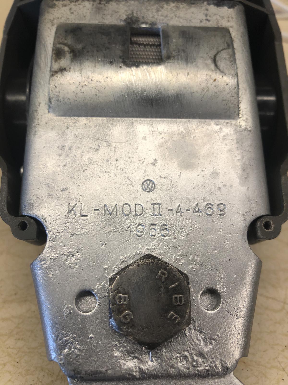

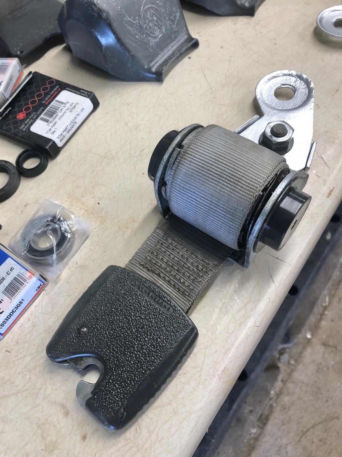

I have a 1967 Type 1 convertible. I have the hard to find convertible seatbelts. I restored them and posted pictures. I received a message saying they were not for the 67 beetle but for the 67 Karmann Ghia as on the plastic housing is has part # 143-15-09-061. The metal base shows KL MODII-4-469. I know the 67 VIN starts with 157. I pulled these out of a 67 VW from a bone yard. I had another 67 years ago with convertible seatbelts that were identical to these. However i don’t have a picture to confirm the part number. So is there anybody out there able to help confirm that these are correct for the beetle only, or the Karmann Ghia only or are they OK for both?
Thanks. Q

PostPosted: Sat Dec 03, 2022 7:38 pm    Post subject: Re: 1967 type1 convertible seatbelts part number Reply with quote
For both.
Smile!
Nice resto job, BTW!

PostPosted: Sun Dec 04, 2022 12:17 pm    Post subject: Re: 1967 type1 convertible seatbelts part number Reply with quote
Yep... https://www.thesamba.com/vw/forum/viewtopic.php?t=708800
The short housings are for Ghia Sedan, Ghia Convertible and Beetle Convertible.
Note: The center tunnel chrome clip attachment hoop bar is different Ghia vs Beetle
There should be a label found on the belt webbing when its fully pulled out

PostPosted: Thu Dec 22, 2022 9:03 am    Post subject: Re: 1967 type1 convertible seatbelts part number Reply with quote
Correct, the 67 bug Convertible seat belt same belt as Karmann Ghia coupe and convertible , most seat belts have 1966 printed on the label..Chuck/Chucks Convertible Parts
