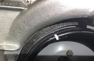

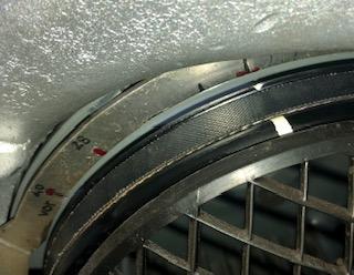

Can we see a picture of this timing notch?
Last year I worked on a T4 with a notch about 30 degrees off. Turns out it was from a 914 or Type 4 car and had notches invisible from the bus access hatch, so someone made a notch that looked descriptively factory, but it lined up with the case parting line like a Type 1 when at TDC.. Evil or Very Mad
Aftermarket silver timing scales have been up to 4* off, you’re runnig a factory plastic scale, correct?

Well, I stole some time and verified my TDC mark. Using the pencil through the spark plug hole, I rotated the engine to find absolute max piston extension, and low and behold, the factory pulley notch is spot on with my scale:
...which is what I expected because it's the same fan as before the rebuild and you can only put the hub on one way. I pulled out an old plastic scale to verify my metal one is accurate, and same thing:
So my TDC mark is correct.
Then I pulled the distributor per SGKent's advice and swapped out the Pertronix for points and condenser and... same thing. Barely runs at 28 BTDC max advance hose off, but runs pretty good at 42 BTDC.
So, I'm as confused as before but did eliminate the possibility that the timing indication is false, and that the Pertronix is at fault.
I'd agree that it shouldn't be able to run at that much actual advance, but I can't explain it any other way?
