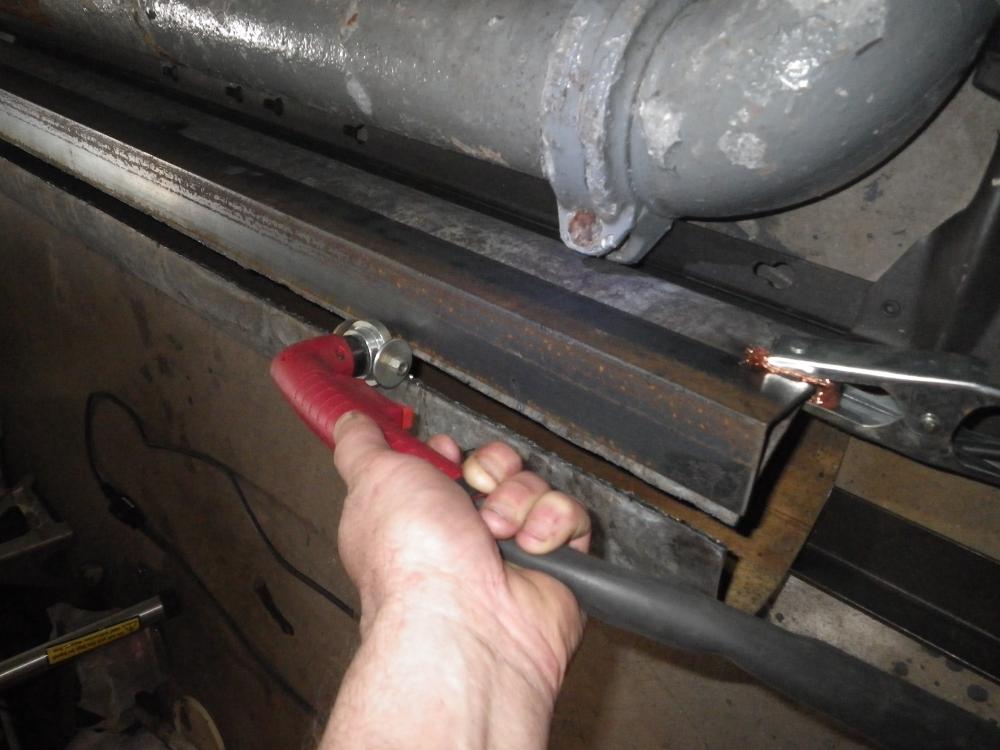

Had a request for this bottom pan tunnel details, for Sterling Kit on "71 Standard Beetle frame. WIP
After cutting into the top tunnel to install custom shifter and Boxster e brake, decided to weld in a half pipe to the bottom of the pan to keep the structure intact. (I hope Smile

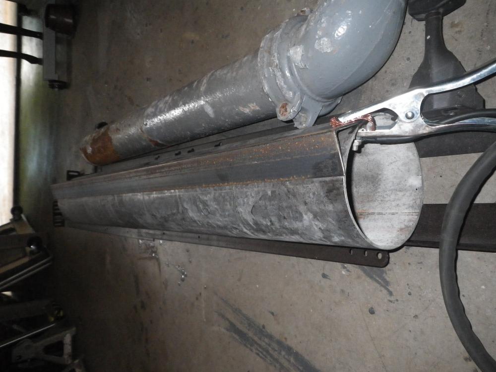

Found 6 7/8" dia pipe used for emergency sprinkler systems at the local Smith's Iron Works. Turns out that the bottom of the Beetle pan along the tunnel is exactly 6 7/8" wide.
Cut the pipe in half with plasma torch, using angle iron tacked on to use as a guide to make a straight cut.
Prep bottom pan with blind nuts for shifter and e brake brackets in top tunnel
Making nose cone template
Use template to mark cut on extra piece of half pipe.

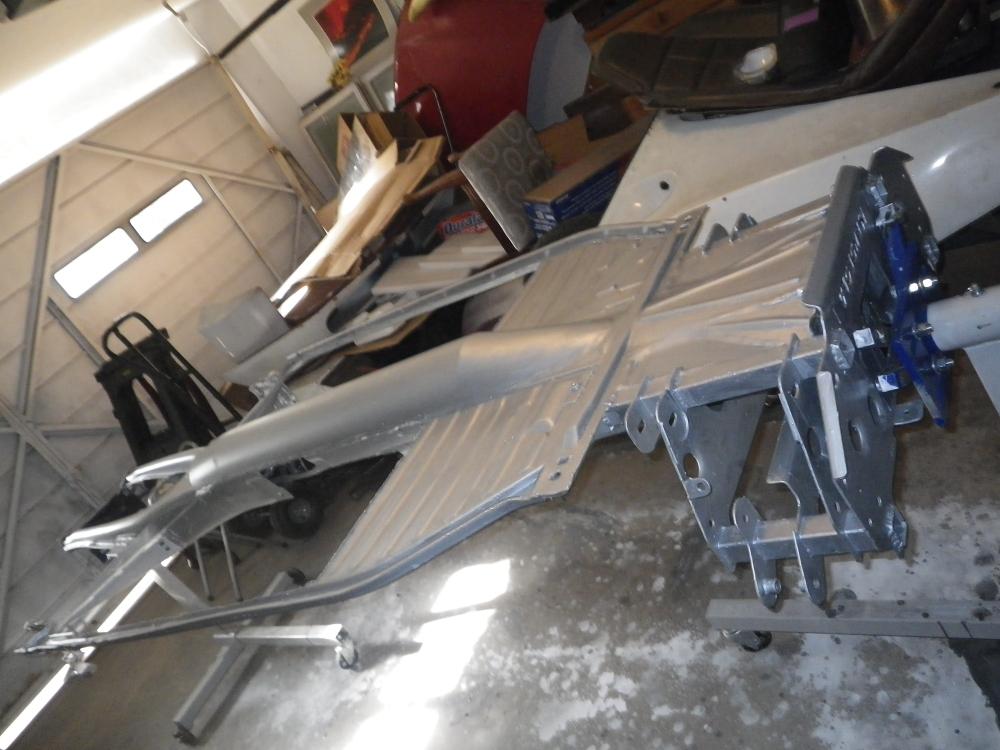

Welded with MIG 175, ground down welds a bit to make smooth, and some metal reinforced body filler at the cone joint to make it clean.

"After cutting into the top tunnel to install custom shifter and Boxster e brake, decided to weld in a half pipe to the bottom of the pan to keep the structure intact."
For Sterling Kit on '71 Standard Beetle donor frame.
Sterling Kit needs 4 inch dropped seat pans for low roof head room.
The tunnel on bottom serves two purposes, allows access to the top tunnel while retaining structure, and provides protection in case of bad bottom out.
(Also the seat pans are carbon Kevlar epoxy laminated with 21,000 lbs Kevlar webbing strap reinforcement to hopefully save my but if I go off the road and hit a tree stump.)

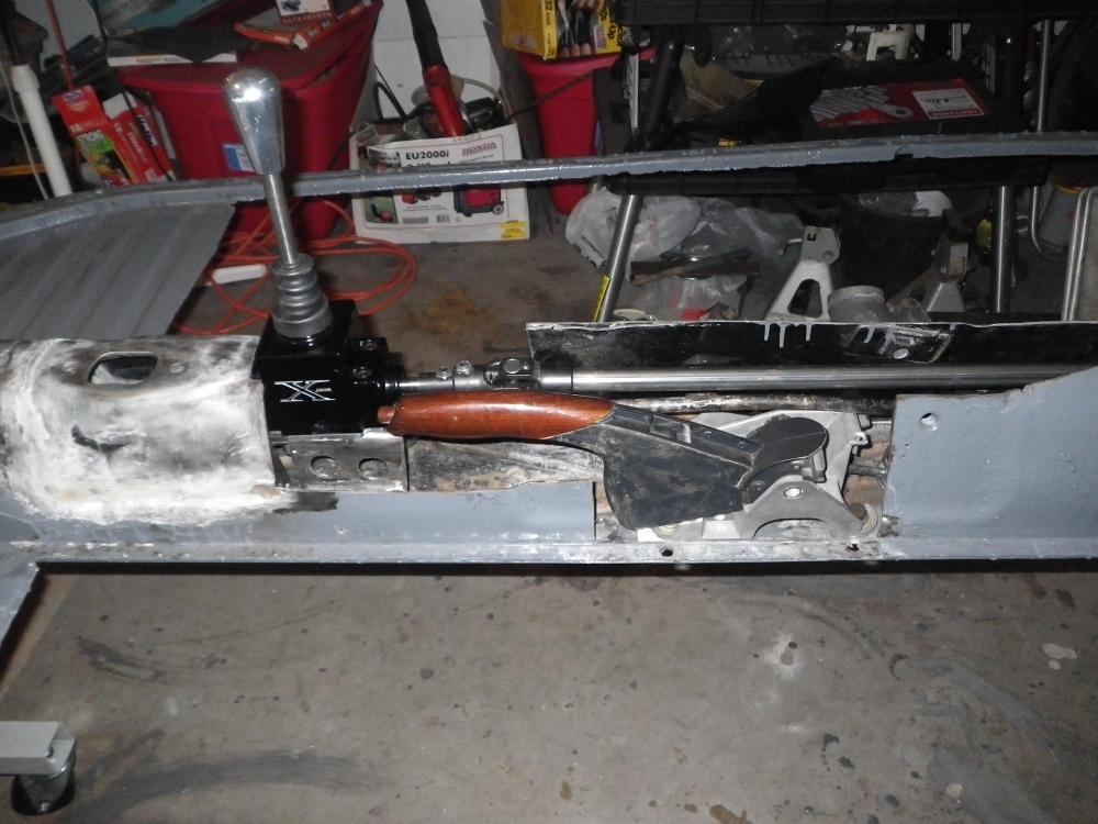

Top of the tunnel is cut open for the shifter mod (6 inch back) and Boxster side offset E brake, keeps the top of the tunnel clear for arm rest, the seats are really low.
Early shifter, e brake photo
I think tubes are much stronger for the weight compared to using a plate.
Many aircraft fuselages are based on the tube design not only for aerodynamics but for strength to weight.
Also, the half pipe is very close to the original tunnel on top, just adding it to the bottom. This way I don't have to worry about welding in brackets and tie bars in the top tunnel, I can leave it open and then cover with removable carbon panels to finish the interior. If I need to adjust the shifter or E brake, I can just remove the access panel. Works great for the Sterling Kit, but not too good for buggies of course.

Now I understand..that last picture helps a lot. You basically have lost all the top structure so you basically have flipped it.

I went with the conventional 4 inch drop seat tubs, but twice as long as the Sterling specs for EV battery storage behind the seats, and epoxy laminated carbon kevlar instead of sheet metal.
The bottom tunnel is safe I think, following the original design, but flipped under instead. If you have a bad bottom out, or hit a tree stump, post or whatever, I'd rather it impact the steel tunnel than crush into the seat pans.
