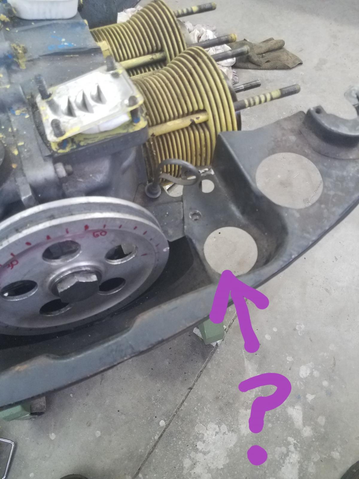

I'm currently piecing together cooling tins for a 1600cc that seemed to be running hot. I'm junking the Taiwan chrome which fit poorly, leaving big gaps for hot air to sneak in. My real deal VW tin also has some unused holes which I want to close up. Anybody know what they're supposed to be for? I can find no reference on the BIG hole. The Medium hole appears to be for a tube running up to the oil filler, which this motor doesn't have. The Small hole ....I have no clue.
Little help?

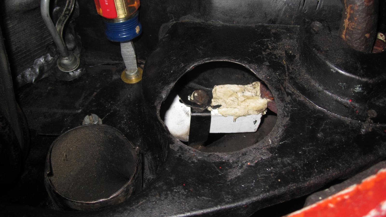

split buses don't use a 2" pre-heat. Here is where it goes in a later bug:

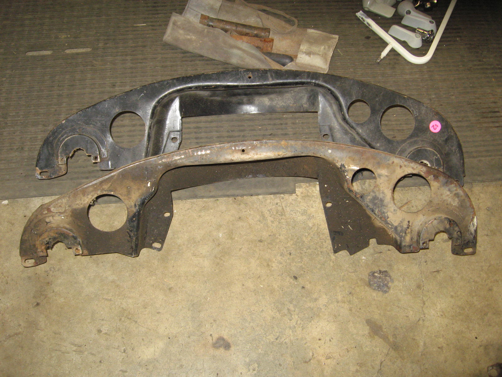

there are a number of different versions of the tin pieces.
This is a set for a 1600dp in a 63 SC:

Awesome. Thanks. I still have the 3rd mystery hole.. The big one, the case vent from the oil fill, and the...?
I'm thinking I'll just plug them all and call it a day.
