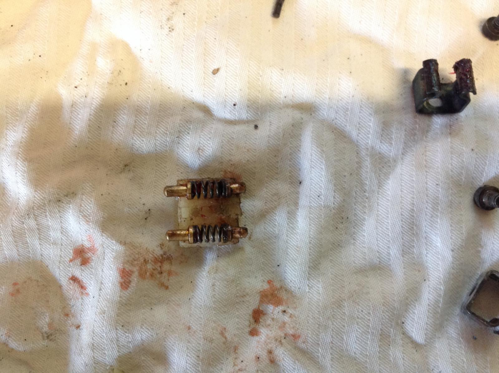

So, I am a nut about having all my electrical work. There's not much so I figure there's no real excuse...and besides I'm waiting on front end parts so I've got time to waste.
My dome light was not working. The assembly is in beautiful shape, mirror is clear and doesn't slop around and the dome light is even nice, so it would be a shame to junk it I thought.
I did the usual tests. I removed the dome light and tested it with a battery and some leads and it worked.
I removed the entire mirror (three screws, the front one is hidden behind a white rubber plug it has a wee hole in it) from the body to get to the two wires, they tested good. I had juice and a ground.
I then used an ohm meter to test the two small button looking pins that contact the pos and neg wires, they were also good.
I then attached the mirror assembly back to the body and removed the mirror from the base by grabbing it from outside the car and pulling it off.
(Airhead has an excellent video on this on a YouTube )
Anyway, I then tested the four pins on the mirror assembly. They stick out from a plastic fixture.
Ground tested good with the ohm meter, positive did not.
Problem found,now how to fix it.
Not knowing how, I stumbled trough it. The fixture is like a plug pressed into the mirror housing. It is held in place with a small pressed in pin located at the back of the mirror. The first challenge is to pull out the pin.
You can see the pin and access it when you remove the two springs held in with two screws.
Using some spring clip removers I got in there enough to slide the pin back far enough that I could use some small wire cutter to grasp it and pull it out.
I then had to use a small screw driver to pry it out of the assembly.
Once out I used a razor blade along the seam to carefully pry it apart. It consist of two halves so I pried gently along the seam. It is clipped together to I had to use a small screw driver to pry it apart.
Inside are four pins and two springs. The pos set was a bit corroded creating resistance.
I took it apart and soaked the metal bits in phosphoric acid to remove the corrosion then coated them in electrical grease.
I reinstalled the pieces noting that the longer pins go in the fat side of the housing.
I then clipped the assembly together and pressed it back in the housing gently tapping it into place. At first it was a bit tight so I used some sandpaper to remove any distortions until it went in easily.
Note that the holes in the springs are not centered, they go on only one way.
I then tested it to make sure it worked and tapped the retaining pin in.
Reinstalled the light and assembly and now have a working dome light.
