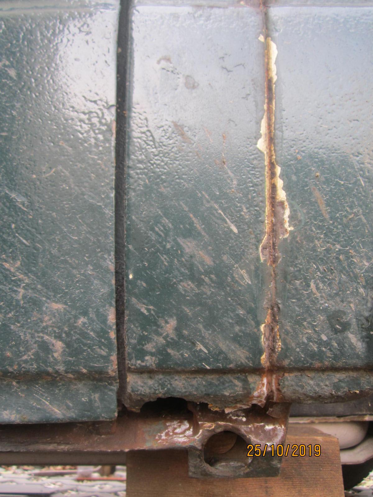

...last couple of days of nice (freaky) hot weather before the Winter will start > so I am now taking a good look at the FRONT wheel-wells/jacking point/seams RUST. Everyone knows this is a very typical area that rusts >>>> but I personally have never had a chance to deal with this area so I don't quite know what the accepted protocol is...
Here is what it looks like:

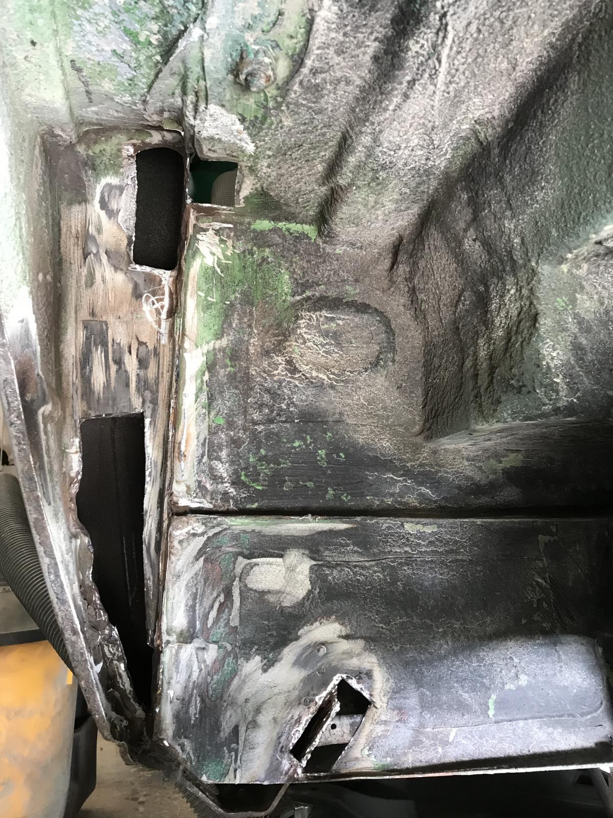

....what I am guessing is that there is a certain amount of rust on the inside, so in order to prevent it all from just coming back I should open up this area enough to get that interior rust out... so should I start with cutting a hole something like the next foto?
...or is it a pity to destroy the exterior panel - and a better ideal to try to go IN thru the wheel-well area?

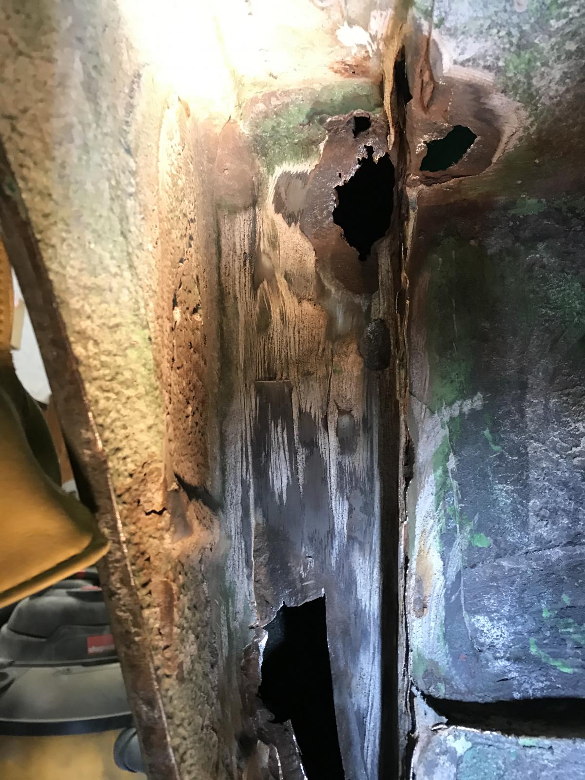

I ended up going through the wheel well mostly as I was afraid I’d not be able to do a good job on the outside.
Best would be to replace the whole piece - wheel arch, etc as I’m sure the rust has migrated up the length of the seam. But, I decided to cut the rust holes out, pull the seam sealer and clean it out and treat with Ospho, weld patches, paint and later soak the inside with fluid film (probably annually).
Finding the holes under all that undercoating -
Cut out -
I did paint some POR-15 inside in the areas I could reach before welding shut. _________________ '91 Westfalia, Bordeaux Red Pearl 2.1L 2wd Auto

Nice job!
How did you cut those holes, Dremel mini-cutting wheel? My grinder will never cut such fine holes.
Very tough to weld is such tight spaces also.
