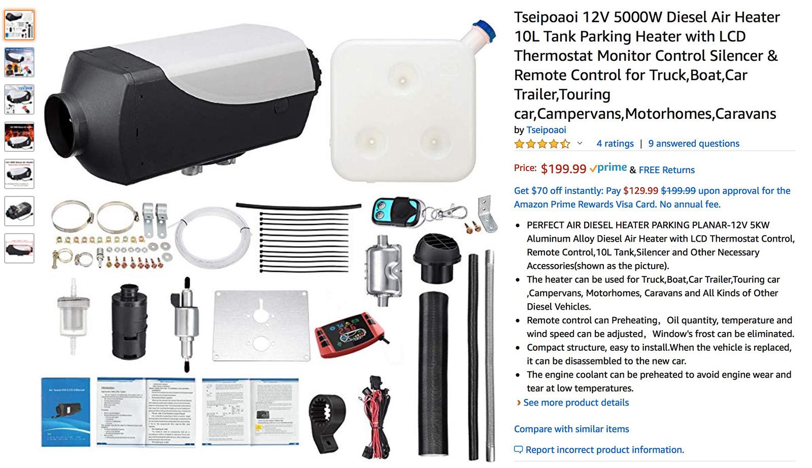

This is the $199 Tseipoaoi model from Amazon. I’m not normally a price shopper, but this thing is a full $1,000 less than a Webasto or Eberspacher - and people seem to say that they work just fine - so that was too tempting to pass up. If it fails, I figure much of my installation work will still be applicable to a better model. They look to be all setup very similarly.

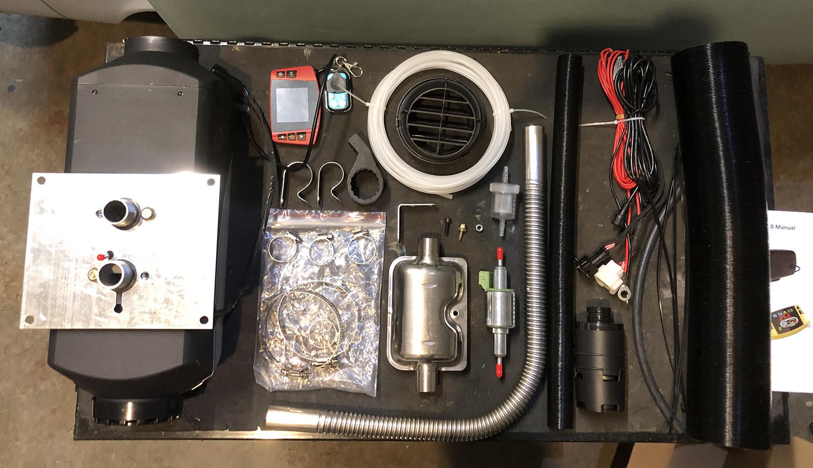

So here’s what’s in the box. Looks like everything you need, except for a few grommets and a good mounting solution for the heater unit itself. It also included a 10L fuel tank, not pictured.

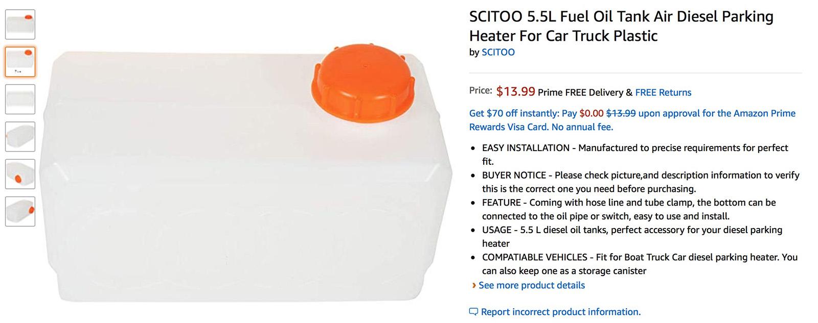

The 10L (2.5 gallon) fuel tank is too large and - even worse - is a very odd shape (big and flat like a slice of bread). So I ditched that and got a smaller one, shaped not unlike a car battery, which will go in the left side of the engine bay.
That’s also from Amazon. That’s coming in a few days (5.5L/1.5 gallon):

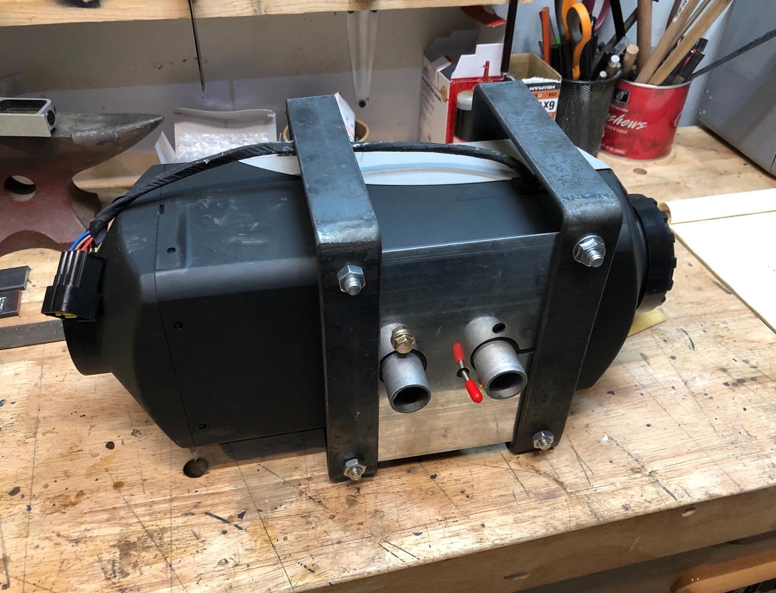

Meanwhile, I've been taking short breaks from work to go out and fab up my mounting brackets. Almost done. I'll be posting more install pics by tomorrow hopefully.

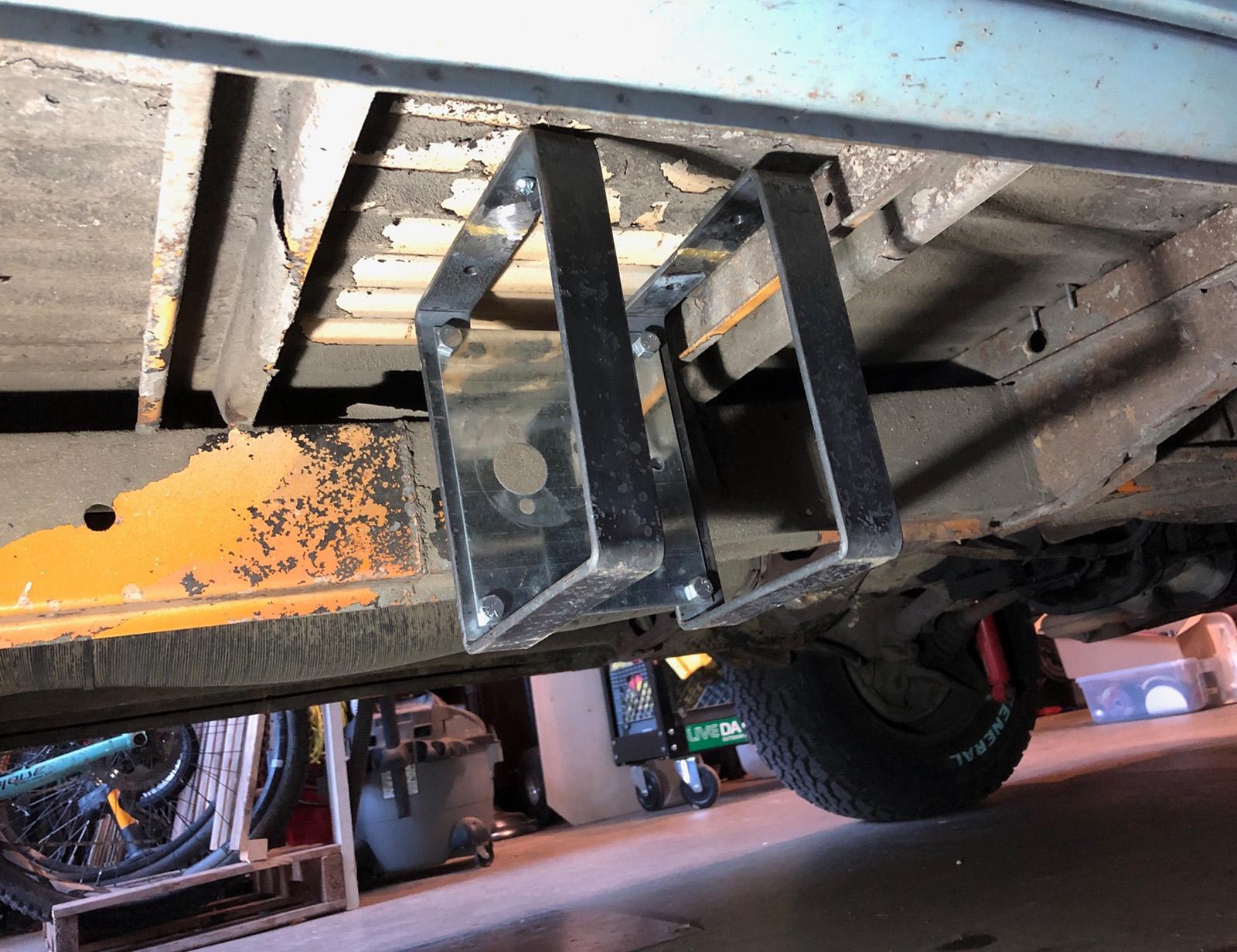

I made a couple steel brackets from flat stock available at the hardware store. I'm looking for the best location to put this thing and I think this is it. I'd rather it was slightly less visible from the outside, but it meets all my other criteria, which are more important to me:
• Outside the cabin (for fire-safety reasons)
• Close to the factory floor vent inlet
• Not crammed in too tight with factory cables, wires, etc.
I'd love to move it a bit more inboard, but the exhaust and combustion air pipes would be too close to that frame rail. They need room for wide-radius turns.
The brackets fit the unit perfectly and now I'm mocking it up to test for location and fit. After that's all confirmed I'll paint them and re-spray some undercoating on the surrounding areas as well - before bolting it up.
