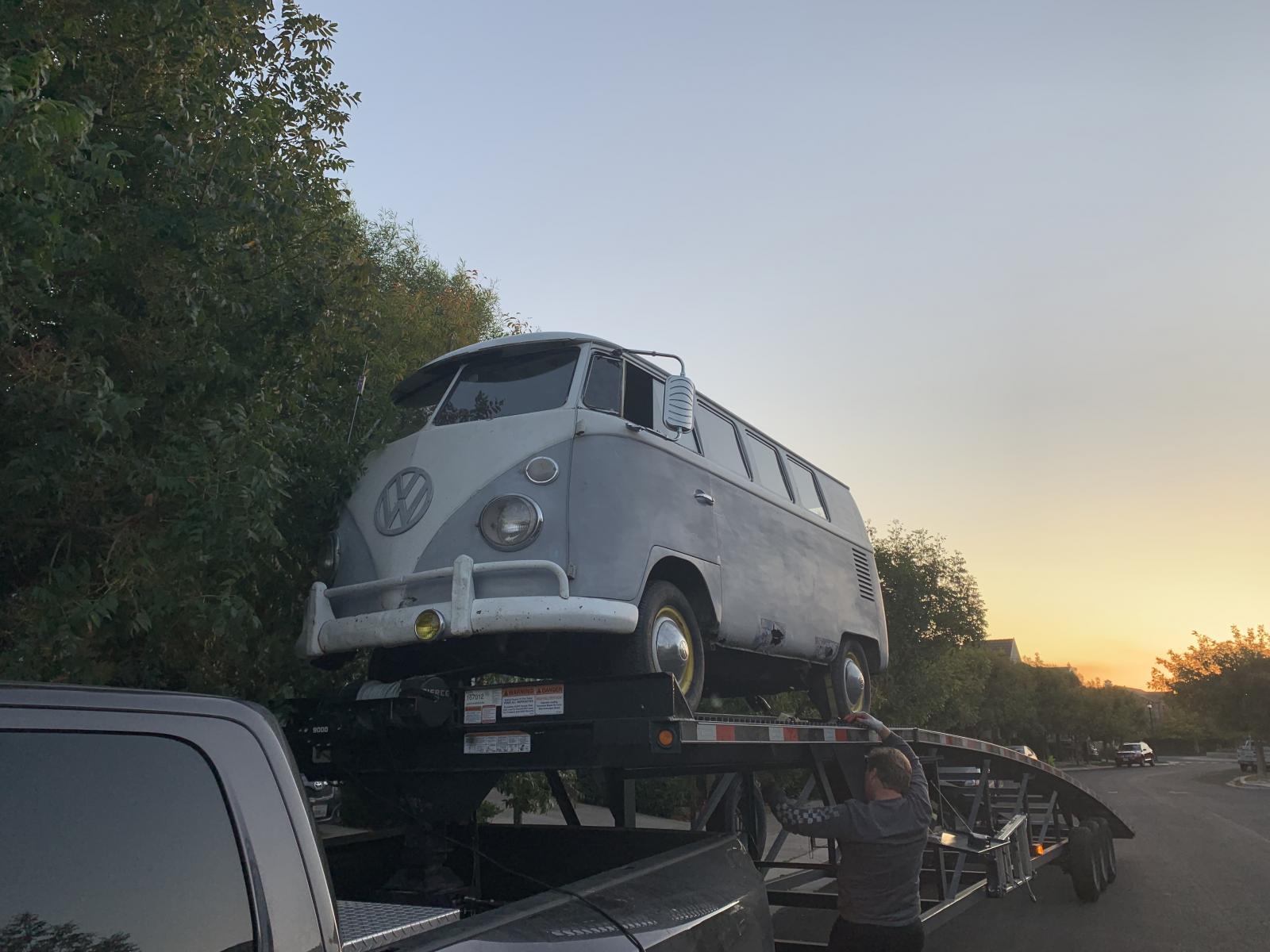

My first bus arrived October 9, 2019. I was hooked at first site.
After 10+ bugs, it was dad’s time to get a bus. But they were all out of my price range, so I had to wait. After looking daily for months, a decent bus had a “Price Drop” just above my budget so I went for it.
2 weeks of coordinating out of state payment and towing.

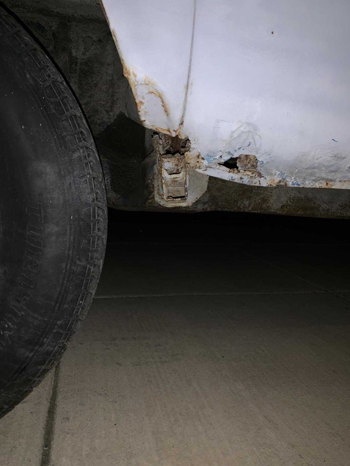

Front floor will need replacing at some point. Previous owner made make-shift patches using license plates and brackets. The driver jack point is toast, the passenger side is a little less toasty.

Having all four jacking points solid and usable is a desirable thing. Using the factory jack and jacking points has several advantages. The factory jack is much lighter, and takes up less room than lugging around a big floor jack. You can also safely jack up any wheel on the bus without having to put any part of your body under the bus, which with using aftermarket floor jacks or scissor jacks might not be the case. You’ll also probably have to lay in the dirt, or at a minimum get on all fours to get an aftermarket jack up under the bus and see to place it properly. I go off road in my buses, and have never gotten stuck, but if I did, I can imagine a few scenarios where it would be near impossible to get a floor jack/bottle jack/scissor jack under the bus to jack it up out of sand, or whatever you’ve sunk down into. The factory jacking system can still work when the bus jacking points are down pretty low to the ground.
A floor jack can lift up an entire end of the bus, true, or can be used to lower the engine if you have to pull it. You could also just use a plastic milk crate and boards to hold the motor up though. The milk crate can double as tool storage etc. I‘d prefer to use the space a big floor jack takes up to bring jack stands or some other useful item.

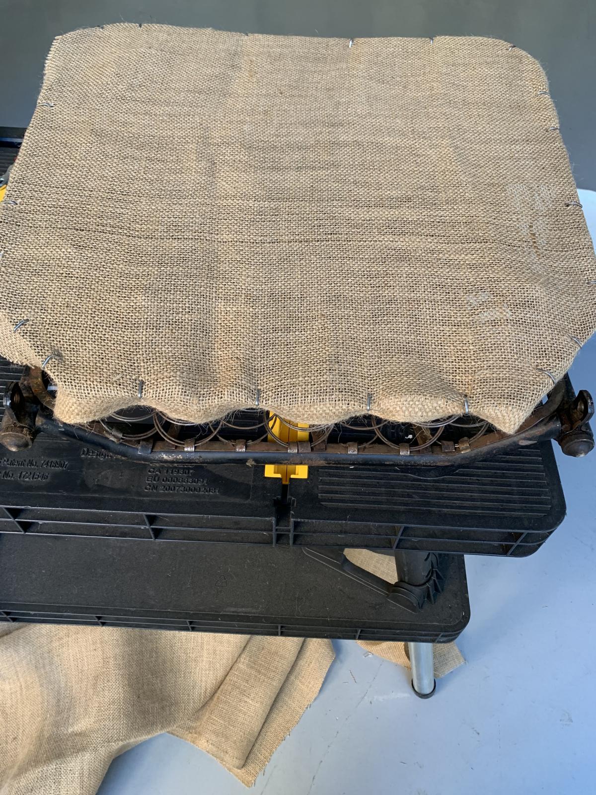

Time to wrap my front seat frames. Hogringed the burlap, glued the foam, and now looking to order gray upholstery soon....

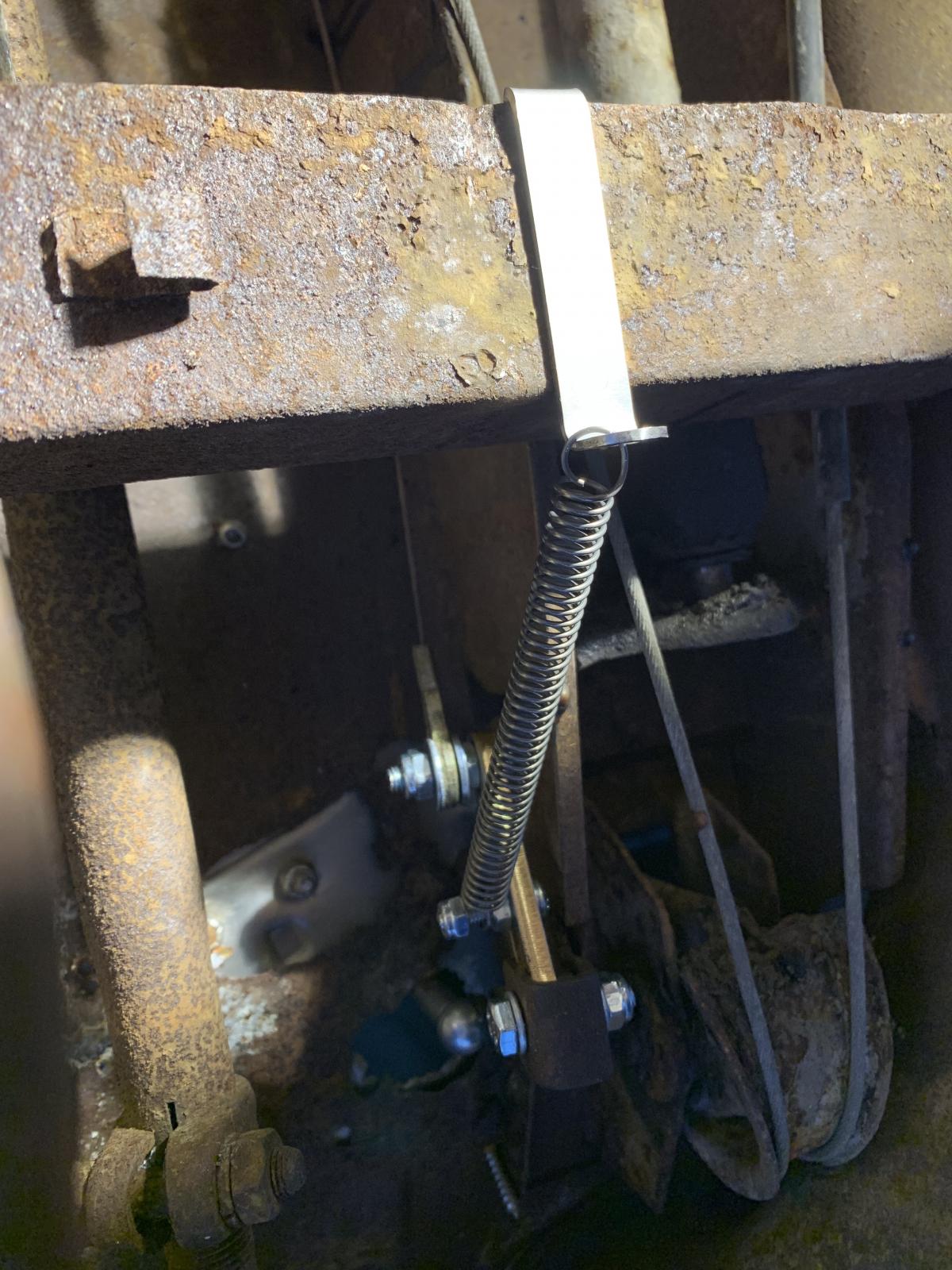

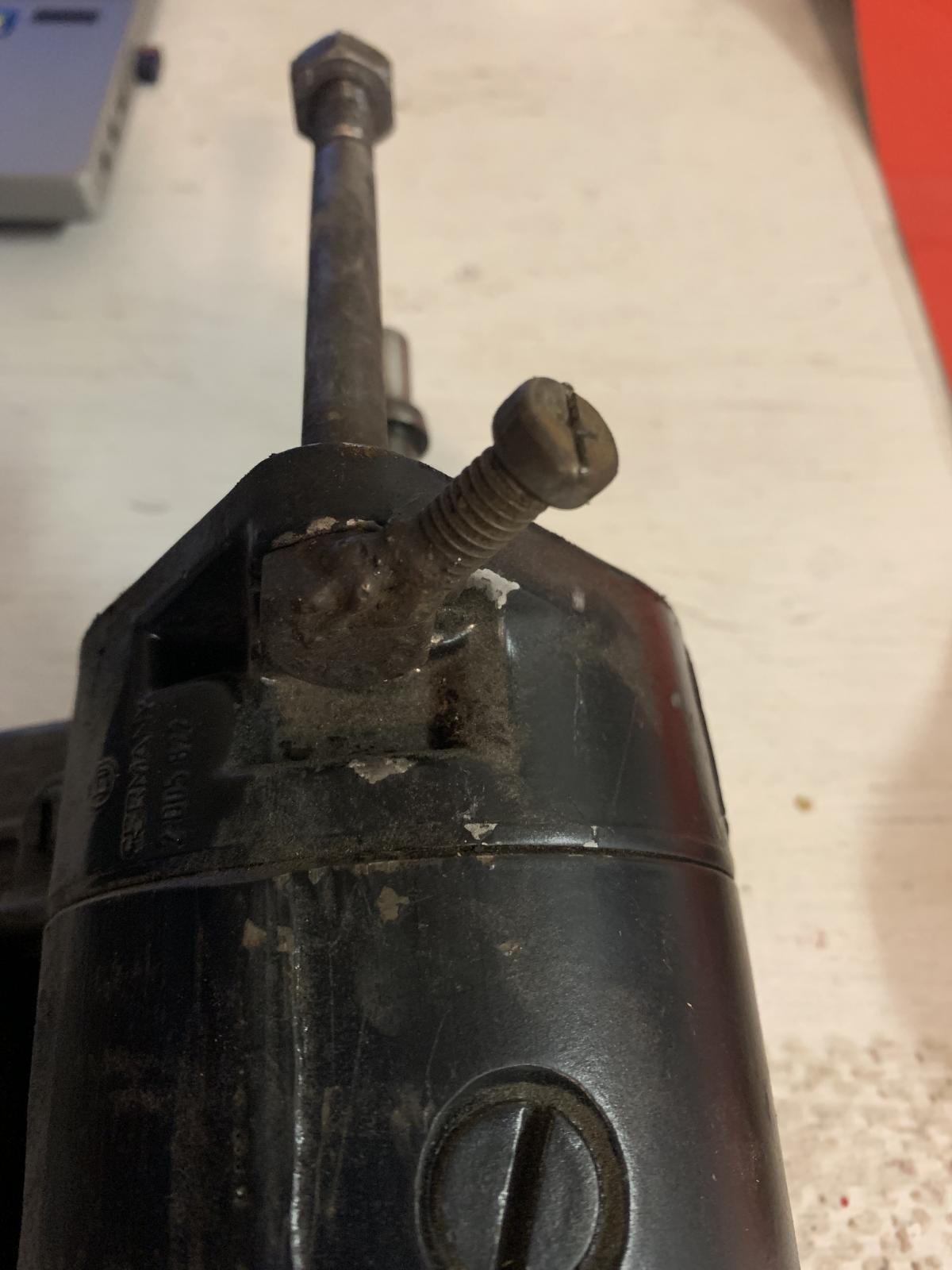

The accelerator pedal/cable linkage was zip-tied together so I first installed the WW kit but I did not like the pedal feel. So I installed the Butty's Bits linkage and it feels like butter.
Butty's Bits purchased from Retro Bus Parts
https://www.thesamba.com/vw/classifieds/search.php?username=ib-bus
WW Kit
Butty's Bits Kit

Those new gas pedal linkage kits have got to be the best thing to do to a bus. I love mine.
What exactly does this kit do? Thx

It replaces the original linkage with a machined arm and a spring that is a far superior design than the original design that was sloppy.

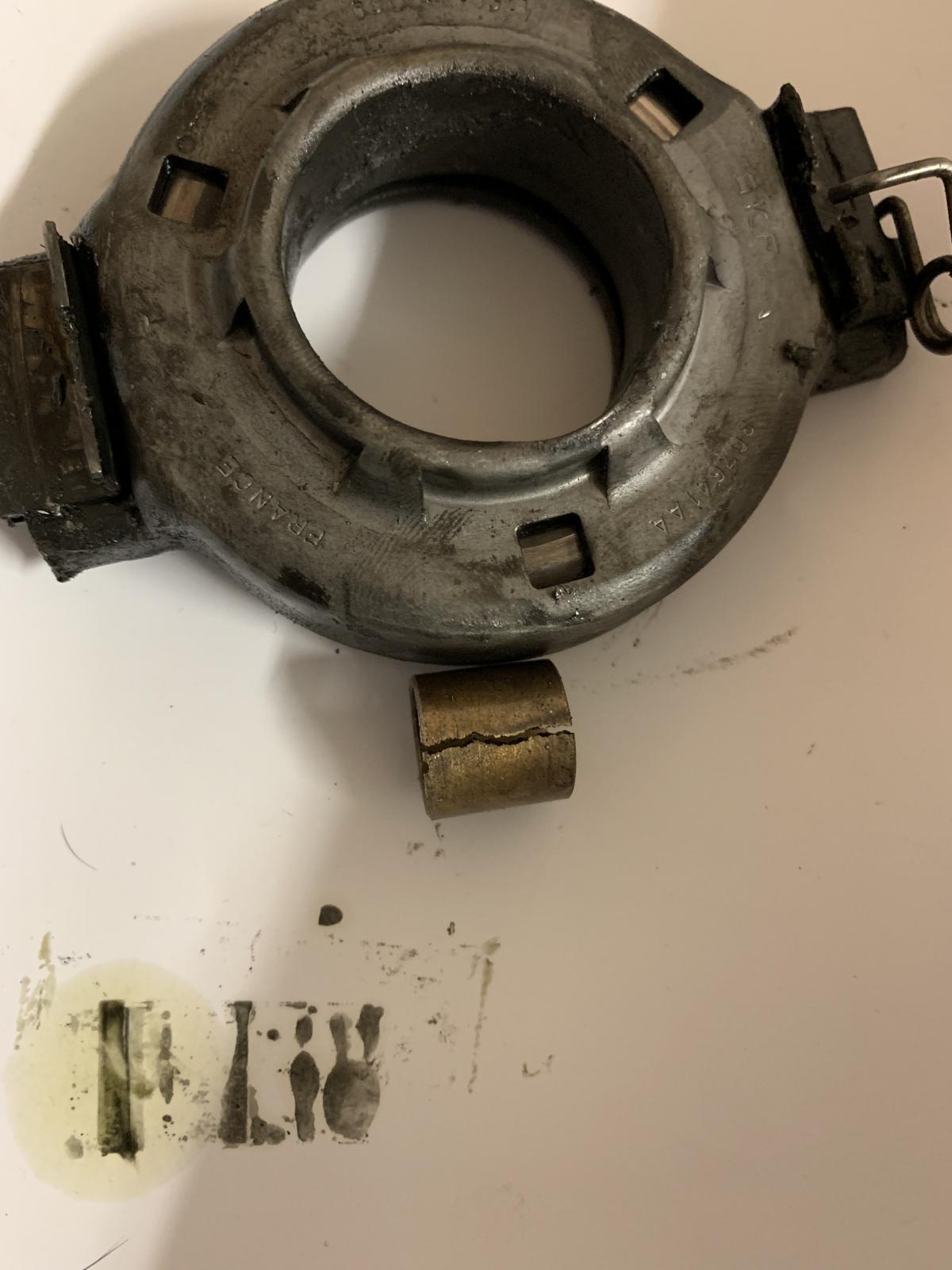

Got motor running, jumped in to go for my first drive aaaaaand the clutch isn’t working. Cable pulls on lever but nothing happening inside clutch. If I start the bus in 1st gear, it wants to jump forward.
Clutch kit arrived, cross shaft arrives Saturday.
Motor getting pulled out on Sunday to check this out.

looks like you are putting in a rigid disk. many people end up not liking them because the sprung ones have a smoother engagement
How much play at the clutch pedal?
If that is good, would check the metal clutch tube to make sure it did not break a weld.
Spring type clutch disc is a bit easier on the engine.

Eric&Barb wrote:
Thanks for the suggestion.
No clutch ‘play’ I guess. The pedal pressure is constant from top to bottom, no change while it travels.
No problem. Then check the clutch tube. Have someone push on the pedal now and then, while you crawl under and look for movement.

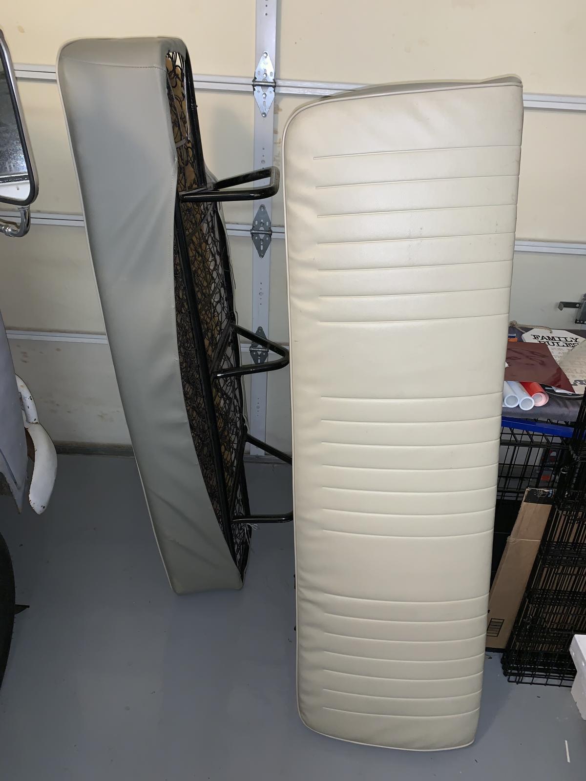

While waiting to pull motor and check clutch, I wanted to install the rear seats I bought a few weeks ago. The bus has wood blocks that convert the original mounts on floor to bay window mounts. It turns out that my back-rest is from a bay window, but my lower seat is from a mid 60's(?) bus so I need to remove the blocks. But I thought these block conversions were cool.

This weekend’s motor pull and clutch investigation.
Here’s the breakdown of Saturday:

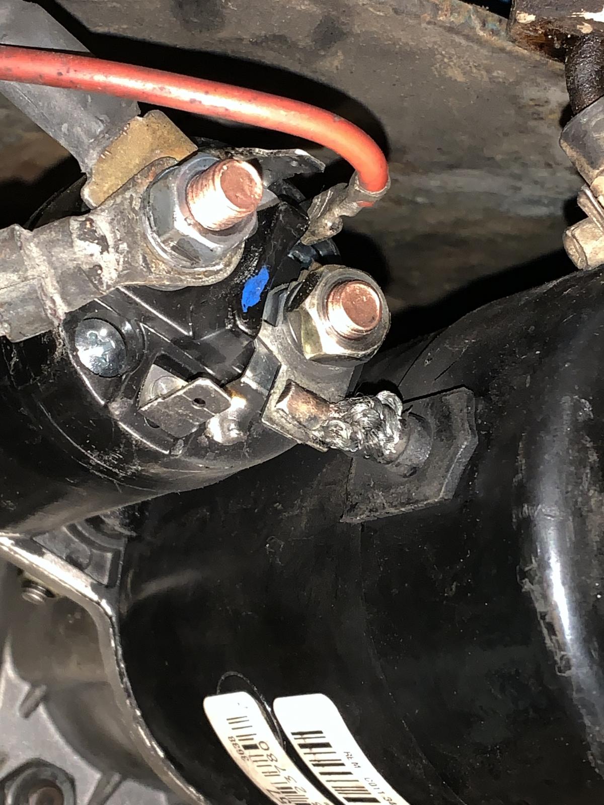

- Pulled motor and found that a previous owner installed wrong clutch bearing so it was never going to work.
- Starter bushing was cracked and ate away at the housing so I need a new self supporting starter (SR17x)...coming soon.
- Starter had a make-shift D bolt installed.

- Installed self supporting starter and got the correct clutch bearing installed.
Fires right up and clutch feels good.
