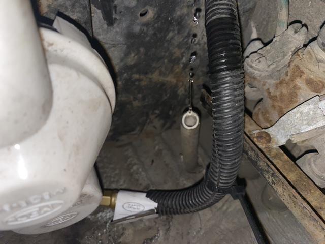

Hi,
I noticed a small white hose dripping water under my β€˜99 camper van. Do you know what is it? And how do I stop it?
Thank you

drain from a fridge perhaps?

I bet that is the fresh water system drain for winterizing. Check inside the pantry cabinet and see if the valve is partially open. Might have to replace the valve.

that's exactly what it is. turn on the pump and you'll see lots of water if the valve in the cabinet is open/broken in the slightest

Thank you so much! The valve was open. I must have left it open after winterizing the pipes and left it open to avoid freezing. I appreciate the pointers! Thanks everyone!
