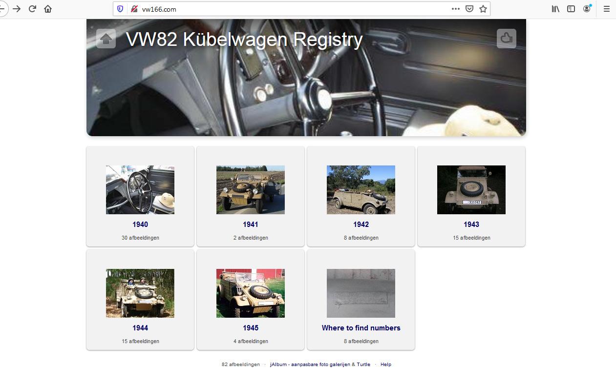

There are listings of surviving Kübels, yes, and the listing corroborate with these numbers but there is no general registry and obviously not all have ordered a birth certificate. One of the very last 1944 Kübels is owned by the Stiftung Automuseum Volkswagen and is on display at the VW Museum. It is chassis # 2-047471 built on 29.12.1944, which is a Friday. The number is only 149 short of the last 1944 number which sounds credible (there were forced labor worker shifts likely on Saturday and Sunday 30.-31. Dec too). The engine number is 2-071098, which appears to the original engine.
A friend in Austria has a very late 1944 Kübel with chassis number 2-047589, only 76 units from the last 1944 number. I do not know the exact build date but the original data plate says 1944 so it is definitely from 1944. Production was less than 100 units per day so this Kübel was built on 30 or 31 Dec 1944. The original engine is not available.
Also a known survivor is 2-047834 built on 10 Jan 1945 with original engine number 2-071365. Chassis number being 169 larger than the last 1944 number seems to fit into the picture. It would appear that 1944 ended with a number between 2-071098 and 2-071365?
This website only has Beetles in the registry and a Kübel listing would be a useful tool even on this website. Comments?

Martin Southwell
Joined: November 24, 2010
Posts: 1093
Location: Bath, England
Martin Southwell is offline
PostPosted: Mon Feb 17, 2020 5:59 am    Post subject: Re: WW2 CORRECT VW serial numbers Reply with quote
I've been watching this blog with interest, and appreciate the research you've been doing, trying to make sense of production numbers.
There have been one or two previous attempts to get a Kubel registry together, but this has always been an uphill struggle, especially as a greater percentage of Kubel owners don't operate within the VW sphere. There is some cross over between military and VW enthusiasts, but not a great deal.
www.166.com has had a rudimentary one, and since their website was hacked within the last couple of years, I don't see any details being made available since.
Additionally, a large proportion of Kubels, mine included, for all sorts of reasons, don't have the same body and chassis combination they left the factory with. As for engines, having an original is highly unlikely in most cases.
So what do you record? The chassis number? Which can easily be changed, and isn't very reliable as a source of information. The body number? The best way of recordinng in my opinion, but often missing in bodies repaired over the years. In addition, what about those on a Beetle chassis, with an original body, or maybe just an original chassis, or body?
All of this makes people reticent to provide information about their vehicles, especially when so many people have Kubels tucked away, and don't want to disclose their existence. I know there are many vehicles in this category in the UK, and would suggest that for every 'known' Kubel, there are 2 extra out there.

You are right about the challenges. The registry obviously consists of vehicles that are numbers matching to vehicles with mismatched engines to vehicles pieced together from parts and anything in between. An expert can pick up the appropriate information from a registry.
For research purposes the "best" vehicles are documented numbers matching vehicles with a certificate from VW. Not many retain their original components and engine but there are some. Then some Birth Certificates dating from 2006 or before have the engine numbers written on the certificate even if the engine is missing so we have the data. Since 50515 Kübels were built there are enough survivors to figure out production data and running changes.
Another story is the Kübelwagen Body number. It too has interesting and unexpected a well as irrational changes that have been closely followed and need to be included in the registries. The Body number is one way of determining the authenticity of a vehicle as the body and pan have been swapped in many cases and even the original data plate reattached to the new body. You need to be quite an expert to detect all of the above. I have been heavily involved in Kübels since 1993, owned two numbers matching cars from 1943 and 1945 and seen and driven dozens but still am amazed with new stuff that pops up. Too little is known about these vehicles and much of the information in inaccurate. I only learned a few years ago that all Kübelwagens were built at the VW plant in Wolfsburg from mid March 1945 and not Ambi-Budd. Also many VW166 owners are in the assumption that Ambi-Budd built Schwimmwagen bodies. Turns out only the first 125 preseries Schwimmwagens were assembled in Berlin and ALL of the production Schwimmer bodies, over 14 000, were ALL assembled at the VW Plant until the production line was damaged in the US Air Force raids in June 1944. Many do not realized that the production of the big Schwimmwagen Type 128 continued in small numbers until 1944.
Then the immediate post war vehicles are even more difficult to follow with missing or renumbered chassis and body numbers, vehicles assembled with reused war time bodies and components, swiveling VW166 tow hooks, etc. The VW Factory/Museum also is not at all interested in digging up dirt from a dark period in history in their pespective although EVEYTHING is fully documented in the factory achives.
