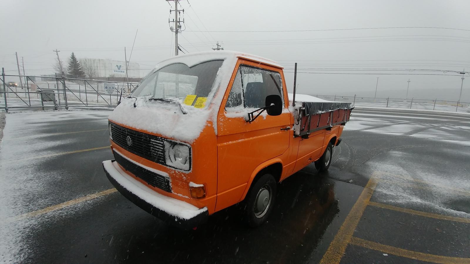

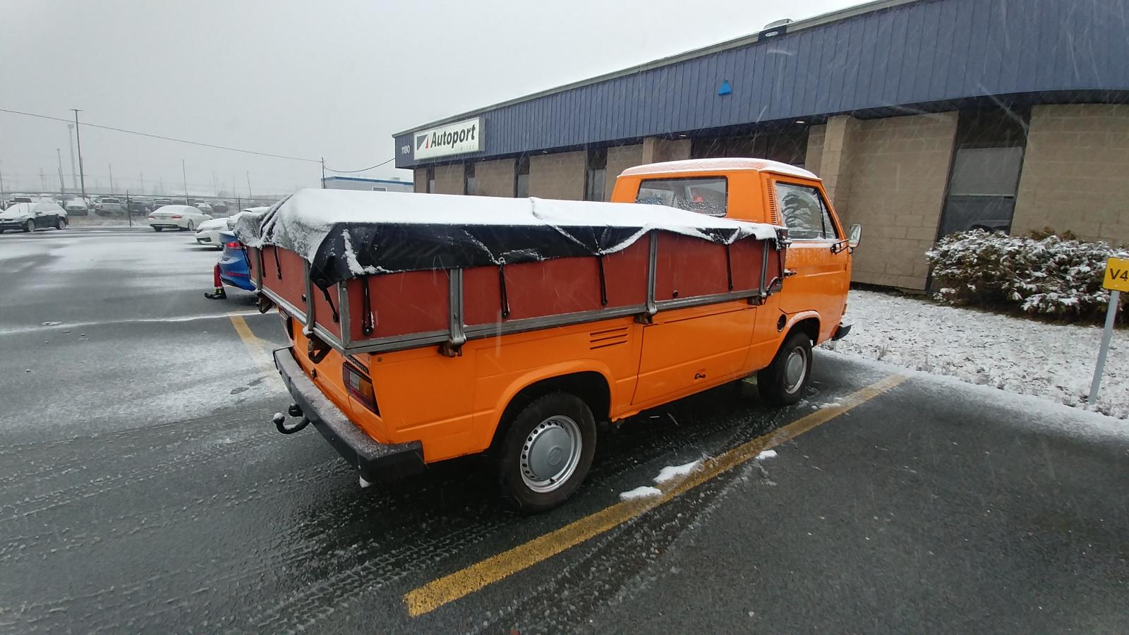

Pics of me picking it up at the shipping facility.
More to follow as I dig into it more and see what's what but my initial impressions are that I like the single cab but I am unsure of that large platform back. I think I would have prefered a normal sinka. Oh well, maybe it will grow on my.

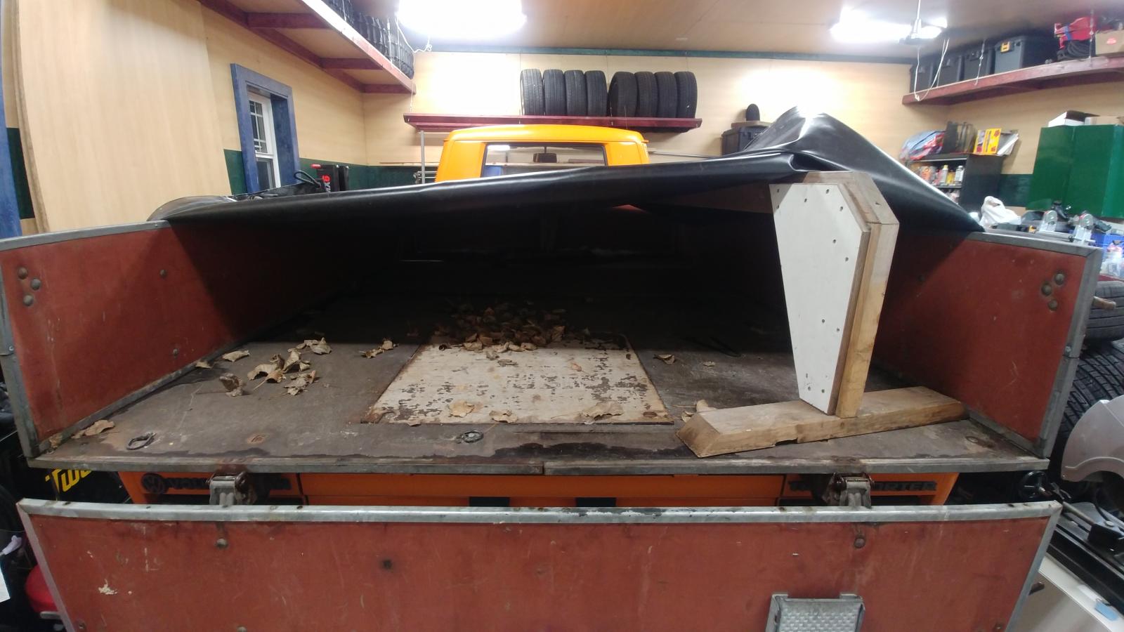

It got inspected today, failed for loose bearings. I brought it home, repacked the front ones and tightened the axle nuts on the rear. That got it through inspection.

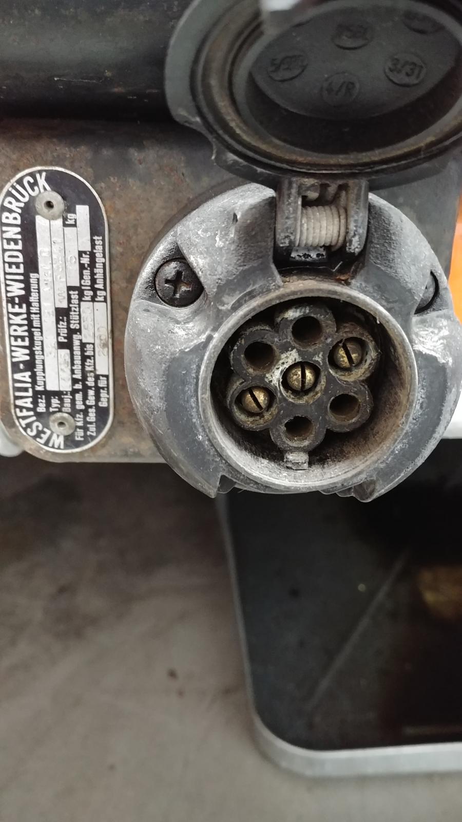

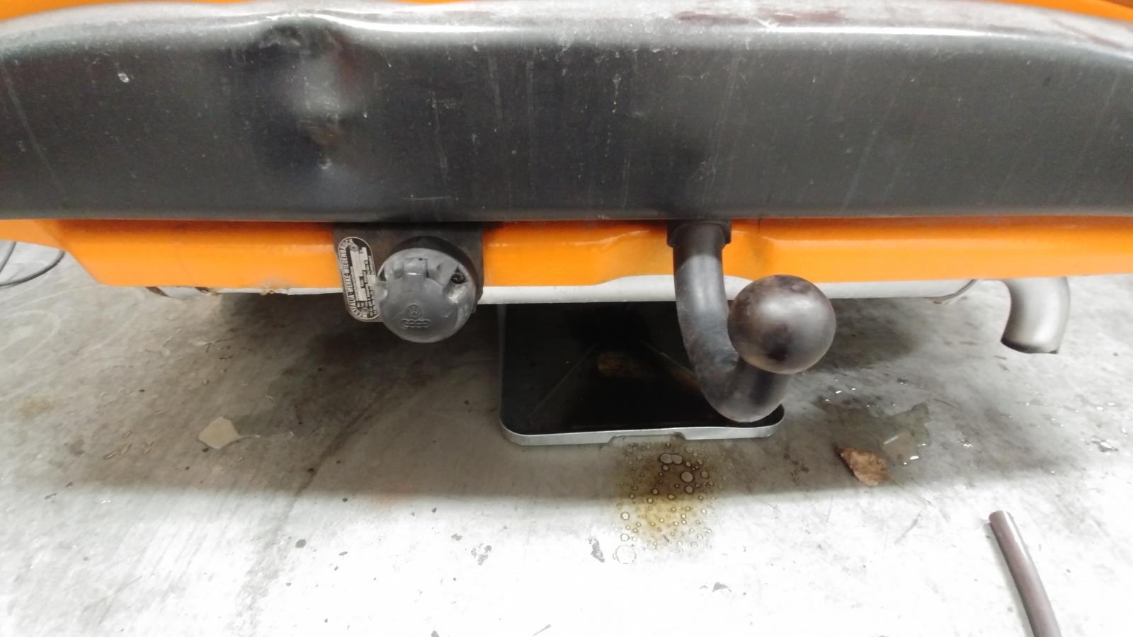

The hitch, anyone know why kind of socket that is?

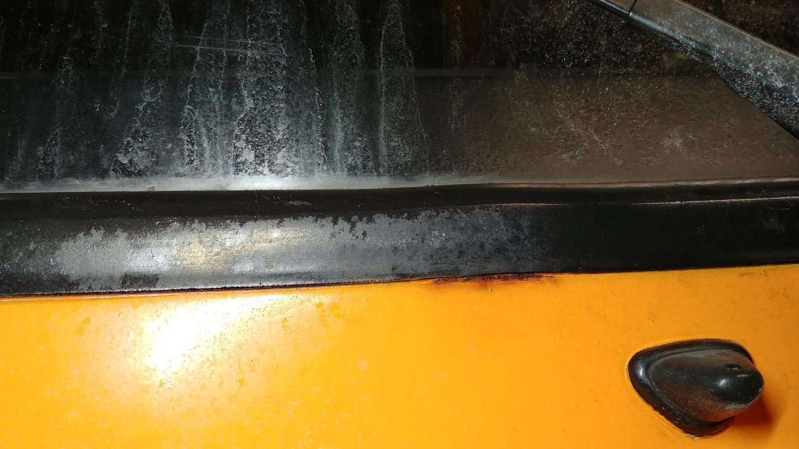

The rest is not too bad. I going to spend a day spray all the cavities with fluid film. I might have to drill a hole or two on inside for access.

That hitch is labeled as Westfalia, but they may just be re-badging Oris hitches.

The socket for the trailer lights is a standard EU 7-'pin' connector.
https://www.google.com/search?q=uk+7+pin+trailer+socket+wiring+diagram
Good find. Smile
