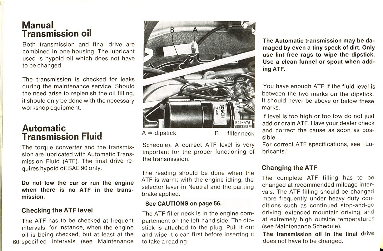

Bruce I do not disagree with the 30,000 mile interval, but I see no mention of that in my Owners Manual, or the Robert Bentley Type 1 Service Manual, or the 181 Workshop Manual.
My Bentley Manual says:
It is unnecessary to change the hypoid oil unless it has
become contaminated, a temperature change has made it
necessary to use an oil of a different viscosity or if the
transmission has been rebuilt. The hypoid oil should always
be changed 600 mi. (1000 km) after rebuilding the
transmission.
Where did you see this 30K figure?

Just shooting out ideas here but:
Maybe they removed the transmission service interval from the Owner's Manual for some reason even though it was still required.
They may have been expecting you to bring it in for service at the larger intervals in the later years.

There is no reason to fight about this.
It is possible that more frequent oil changes are necessary on swing axle cars, as the posted lubrication charts indicate; where the rear wheel bearings are lubricated with the same oil as the transmission.
While there may be a few of us that own swing axle/RGB Things, I assume the vast majority of us have IRS trans-axles.
Each of us can choose our own trans-axle oil change intervals, as well as the type or brand of oil we use.
For me, it takes at least 5 years to go 30,000 miles; I'll be close to 70 by the time I need to do this again.
I hope I (am still alive to) enjoy crawling around under my Thing in 2020.
I thought of this and ran through the bus owner's manual from the mid sixties through the mid seventies and the change was made several years after VW went from swing axles and drop boxes to IRS suspension systems. It could still be the reasoning though and it just took a few years before the owner's manuals caught up with the engineering.

Wildthings-
When I read your post, it made me curious about the transmission oil for older 181's.
Here's the page from the 1971 181 Owners Manual:
Swing axle, RGB, but still no mention of regular oil changes for the trans-axle (other than the initial change at 600 miles). Go figure Wink
