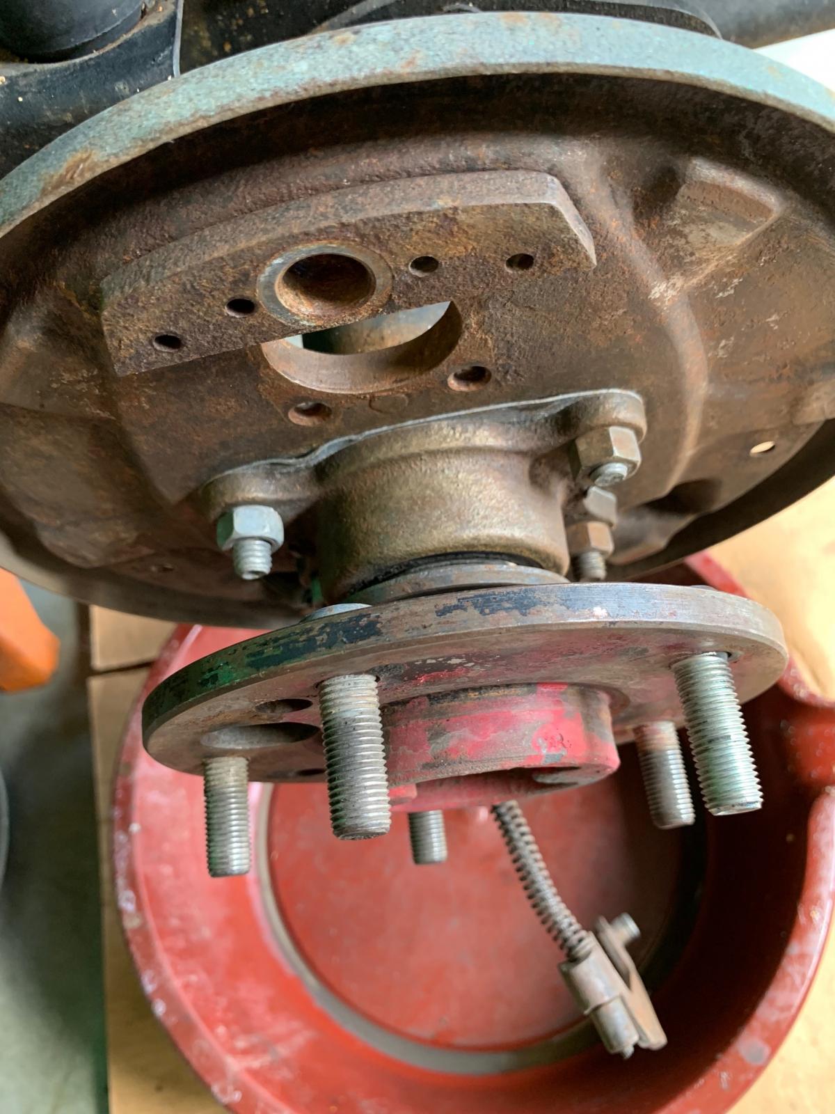

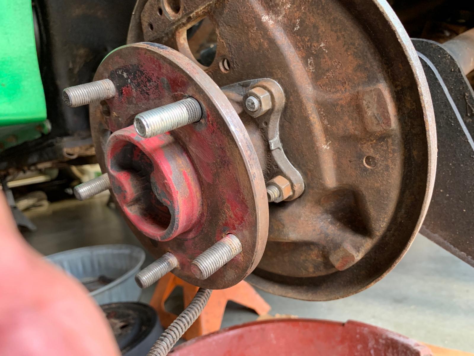

The back brakes have been converted to 5 lug. The rear drums were re drilled so I am looking for a new set. Has to be the most crude conversion I have seen. Not sure whether or not the corvair 5 lug drums will fit but I'm looking in to it.

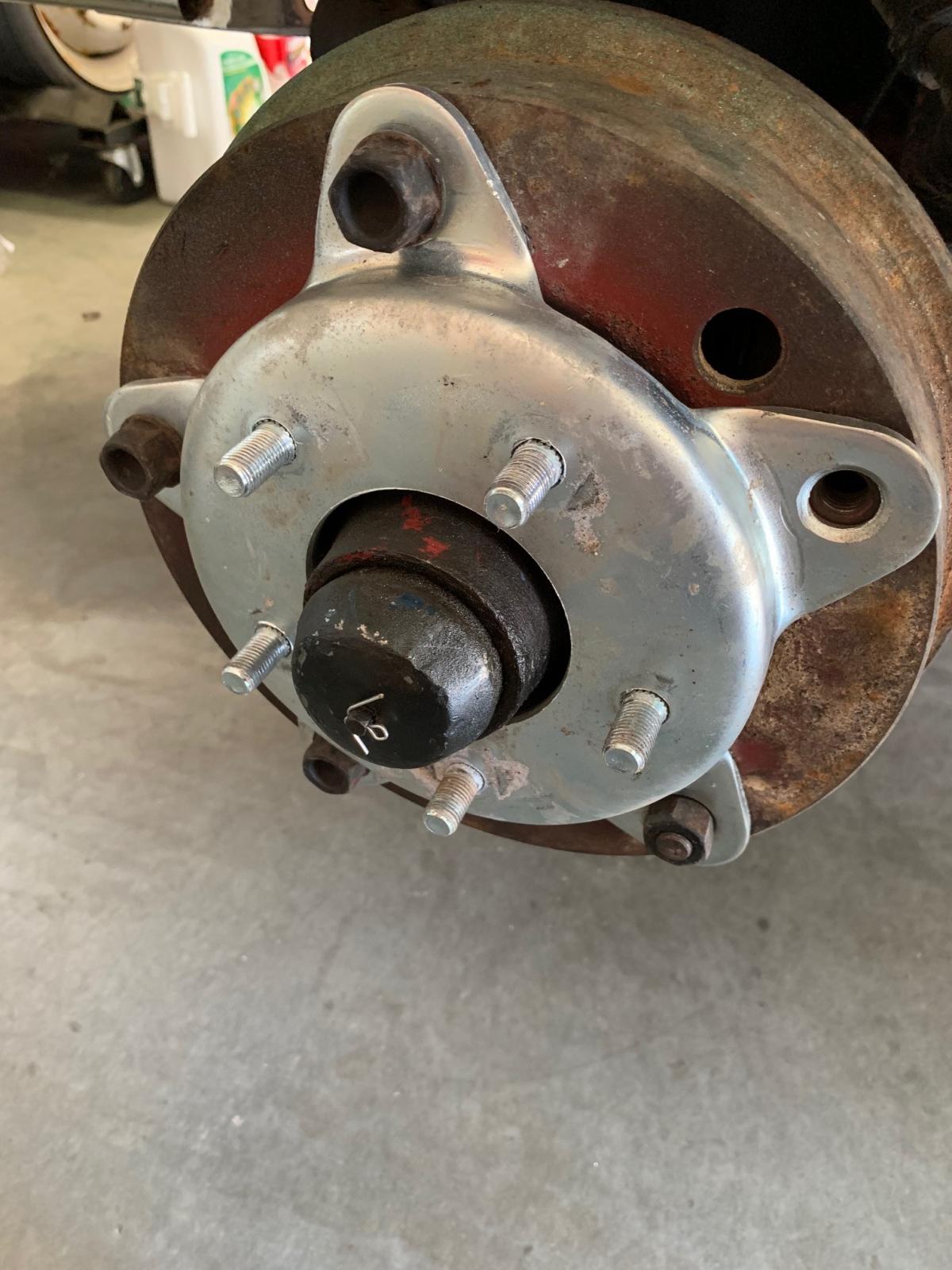

The front wheels have an adapter. Trying to see if there is a way to get rid of the adapter and use the Cragars that came with the car. They are Chevy 5 x 4.75". Does it make sense to go to disc brakes up front? Would need to have a Chevy 5 x 4.75 pattern and don't want it to increase track width too much.

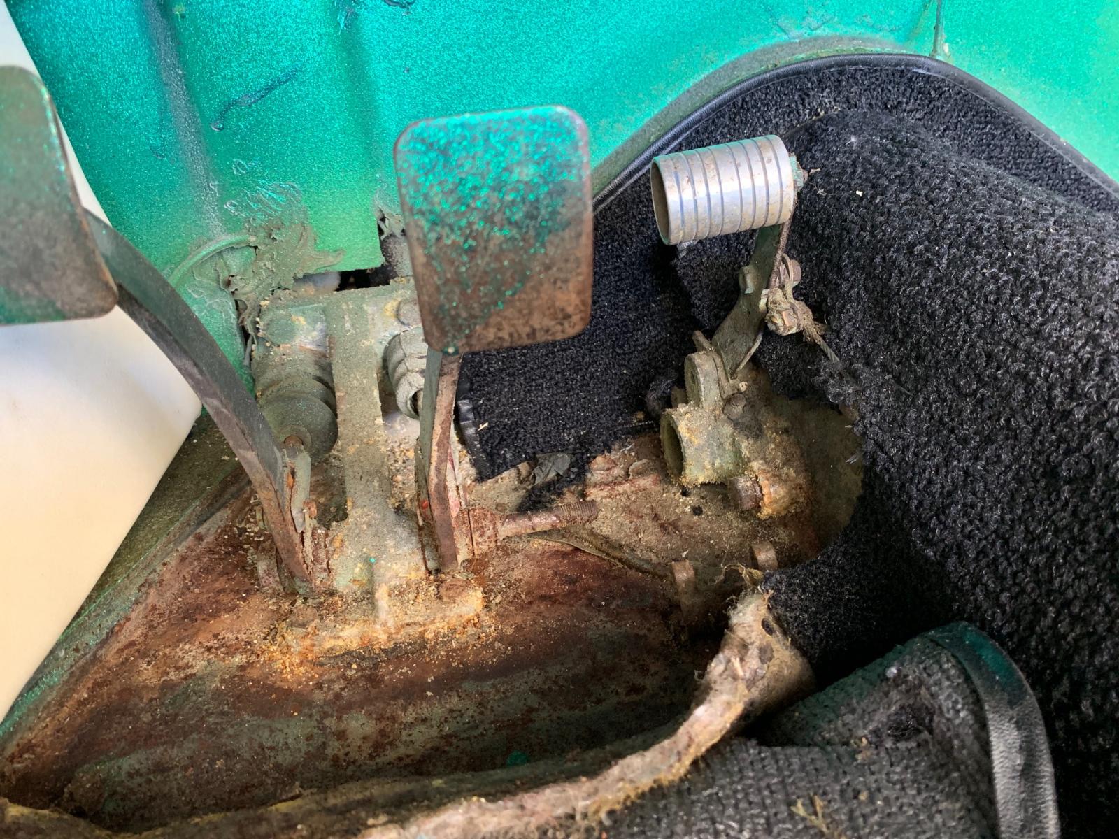

I'm going to get rid of these pedals and go back to stock pedals.

I think the Chevy bolt pattern drums are only available for the later ball joint suspension drums. The early drums have that large volcano for the wheel bearings.
The spacers I have now add 2 inches to the track width too. I decided to stay with the drums and have rebuild parts on the way. I may find some different wheels with a different offset to pull them in a little more. I think the current wheels are 7.5" or 8" wide too and I'd like something a little narrower.
I've got drums on the way for the back too. These will need to be drilled for the 5 bolt Chevy pattern too. The current rear drum holes are loose so they will not center on the hub. Found out my axles are also welded at the splines. Another future fix project.

Your rear axles are '63-'64 judging by the axle bearings, that sucks that they welded the yokes, like you said it makes it difficult to replace the bearings. You might have to find some newer rebuild-able axles for the future.
Yeah, 63 from what Ive been told so I will be on the lookout. I had bought shoes for 61 so those will need to go back. I think this whole set-up is a mis-mash or Corvair parts. a 61 motor and 61 heads...but one of the heads may be a different year. A 62 or later distributor and I'm not sure year what the transmission is from.

Man those axles are scary!!! It may actully be better to have some made from scratch? If you have to chop corvair axles, i would think a built set would ony be around $300

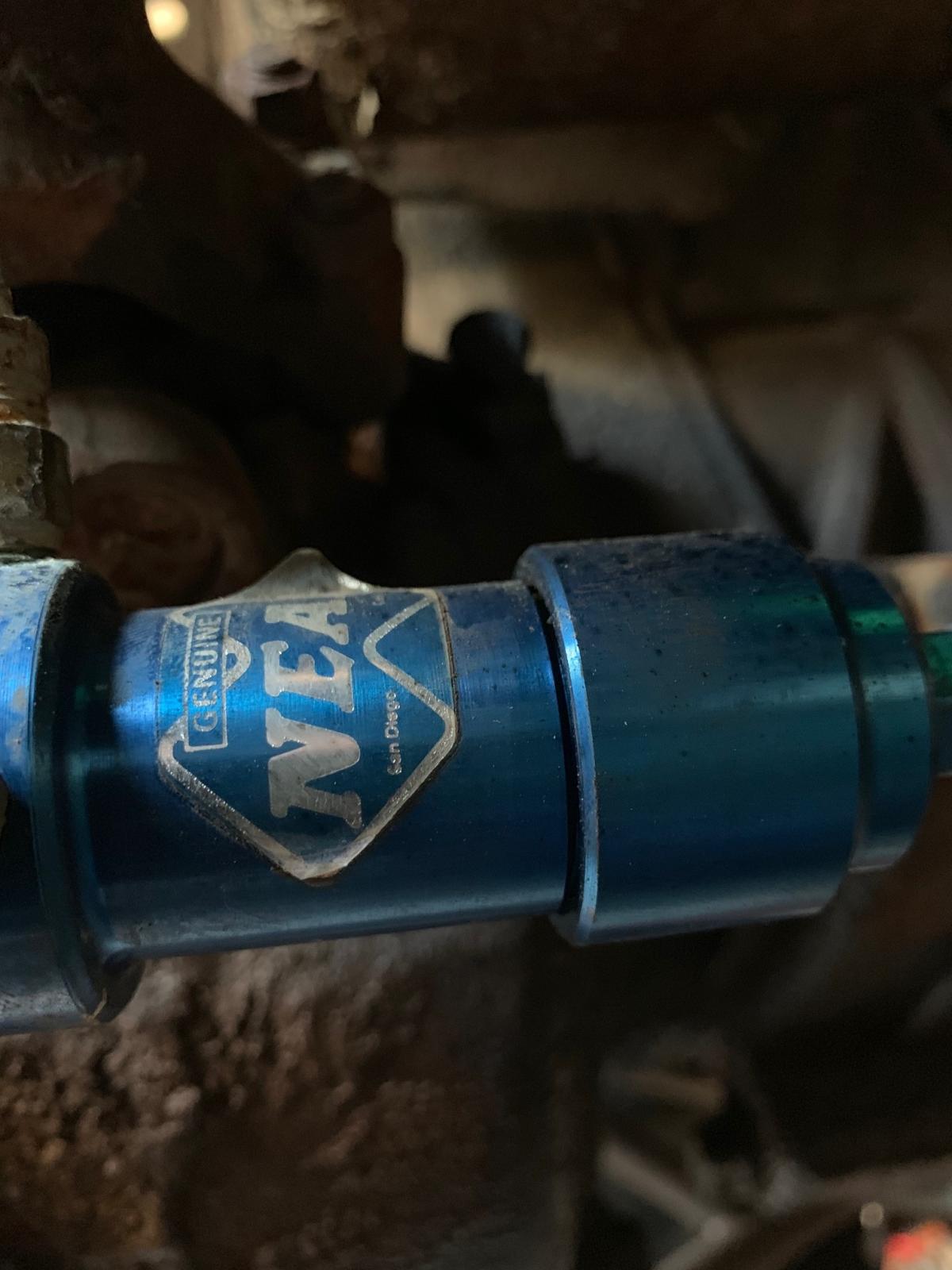

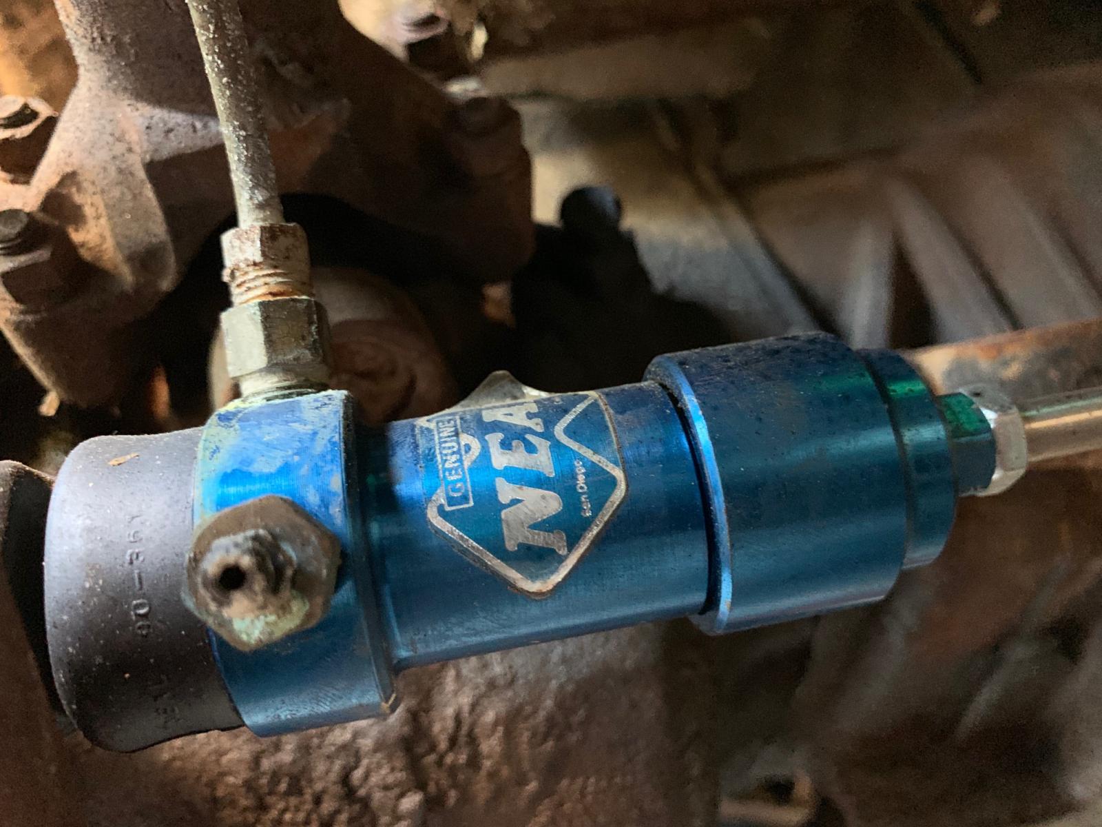

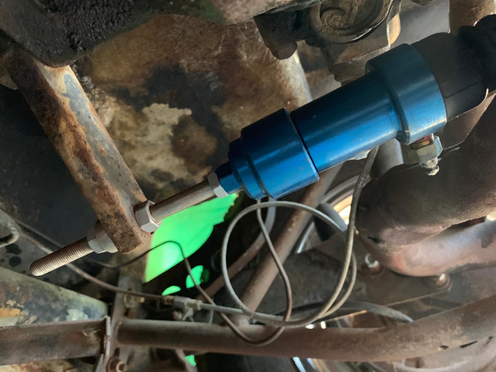

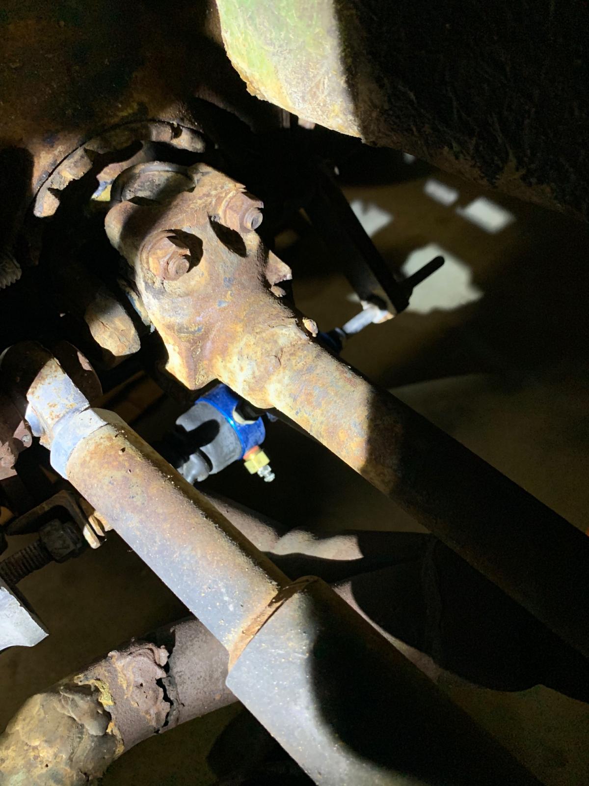

dlyle when you have a chance can you post some more detailed pics of the hydraulic clutch slave cylinder installation. I curious as to the bracket set up.

PostPosted: Thu Jul 25, 2019 8:41 am    Post subject: Re: Bounty Hunter dune buggy build thread Reply with quote
Here are a few that I have. These are the before pictures so a bit dirty. Looked brand new after a wash. The plan is to go back to the original VW pedals and a manual cable clutch. Hoping to find a Transvair instruction manual so I can figure out how too do it. The one article I read about it says the Transvair kits comes with a clutch shaft that increases the throw of the clutch. Assume that tis would be the clutch shaft and arm that is in the pedals.

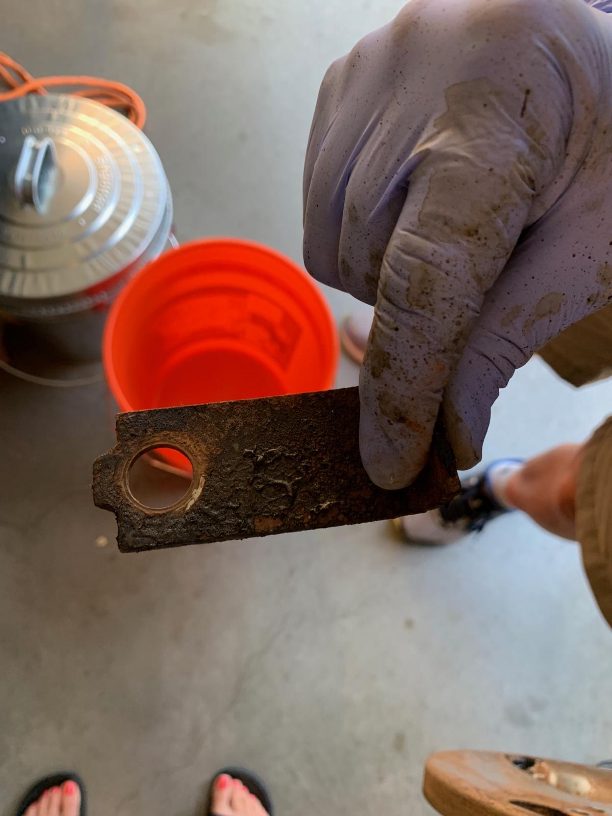

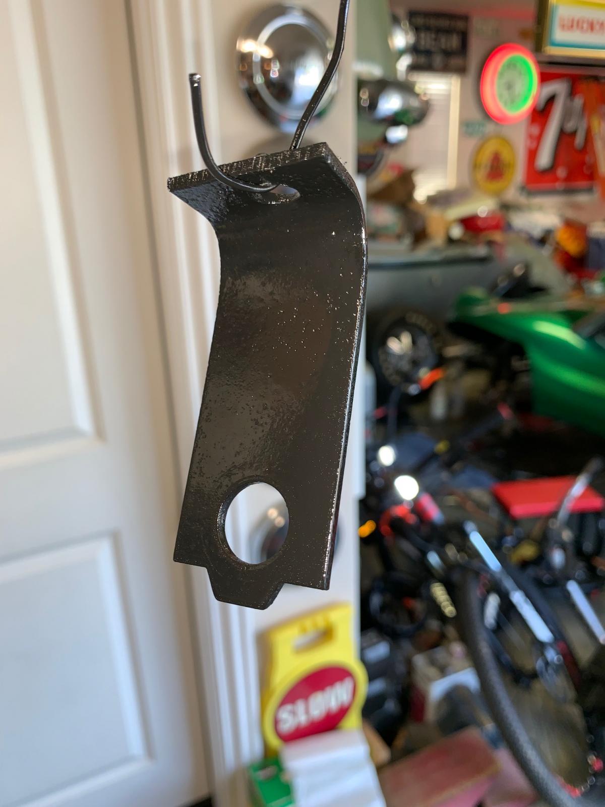

PostPosted: Thu Jul 25, 2019 9:37 am    Post subject: Re: Bounty Hunter dune buggy build thread Reply with quote

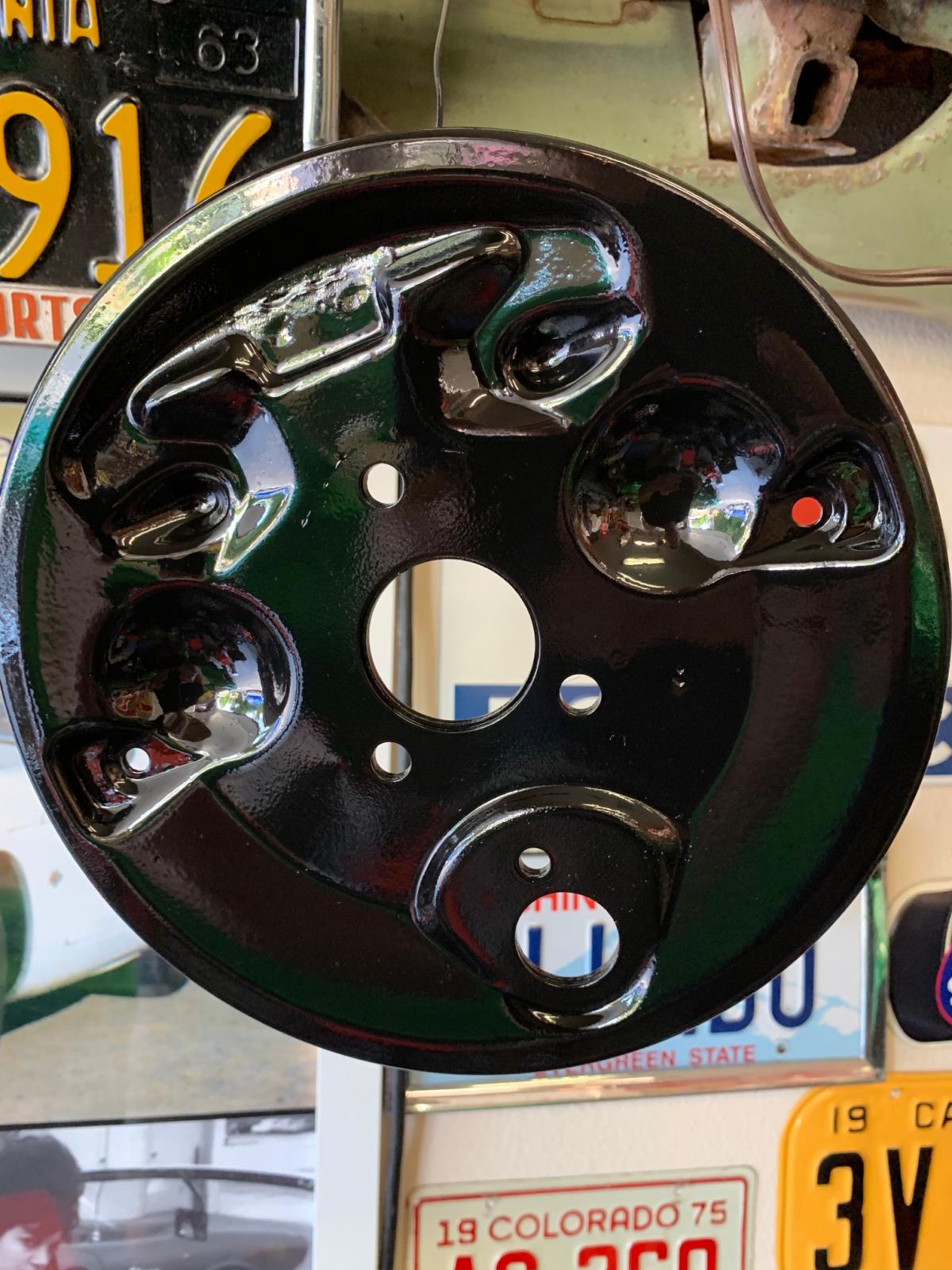

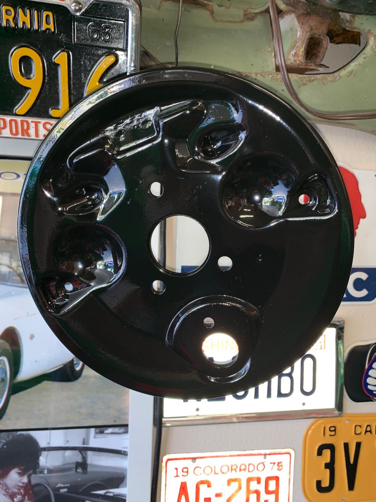

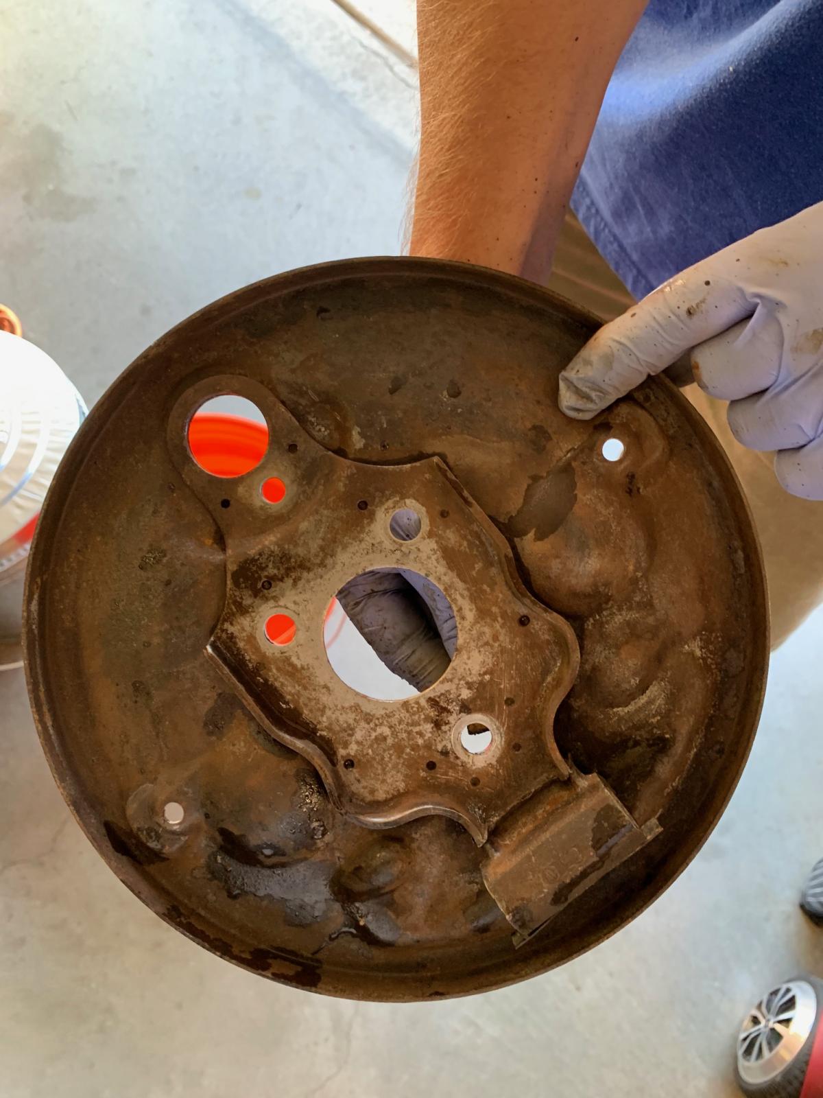

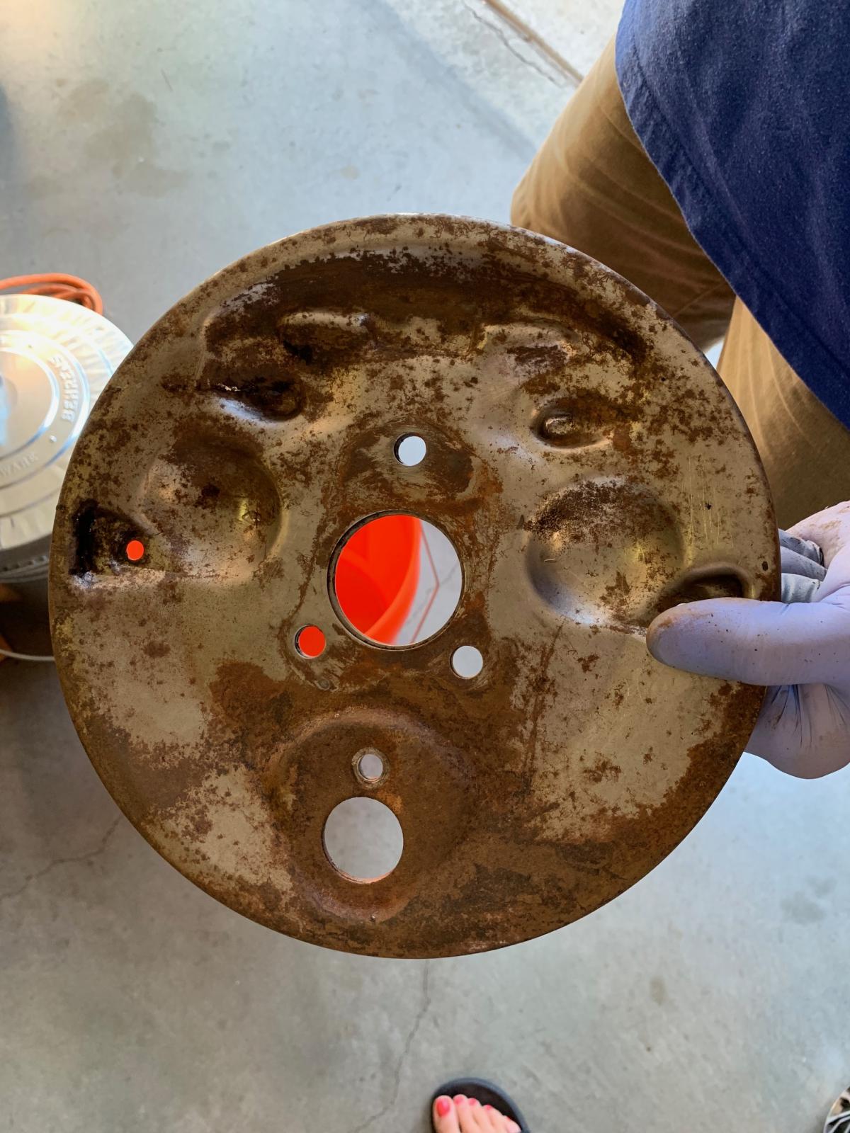

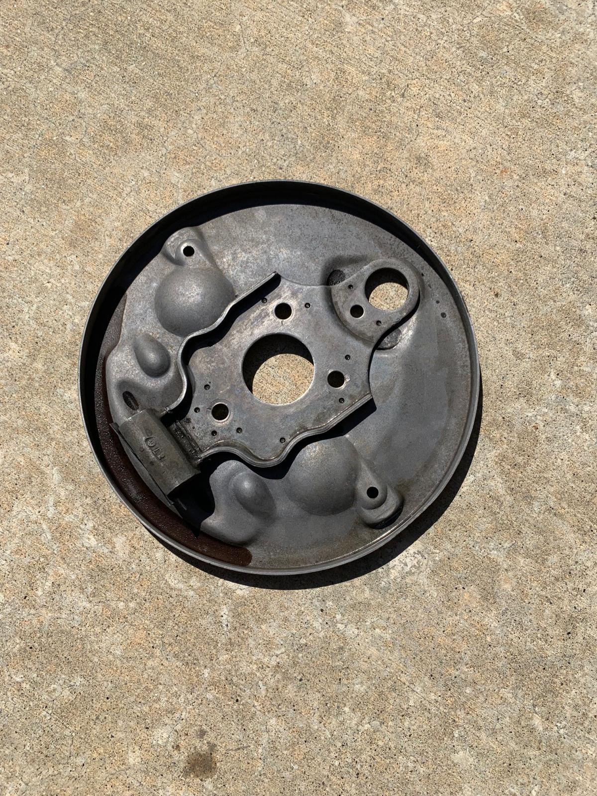

Spent a little time getting the front brakes cleaned and detailed.
This is what the backing plate looked like after initial clean up. Took a while to get all that caked on hard grease off.
The backing plates now look like this after a soak in Evaporust. I didn't have access to a bead blaster so went the Evaporust route. This stuff is awesome. Completely gets rid of rust and leaves the original finish. I swear by this product.
A little paint and they look good as new. Was 100 degrees out so this really is a baked on finish.
After all this once it's all back together I get to do it again on the other side. Keeping one side together so I don't forget how it all goes back together.

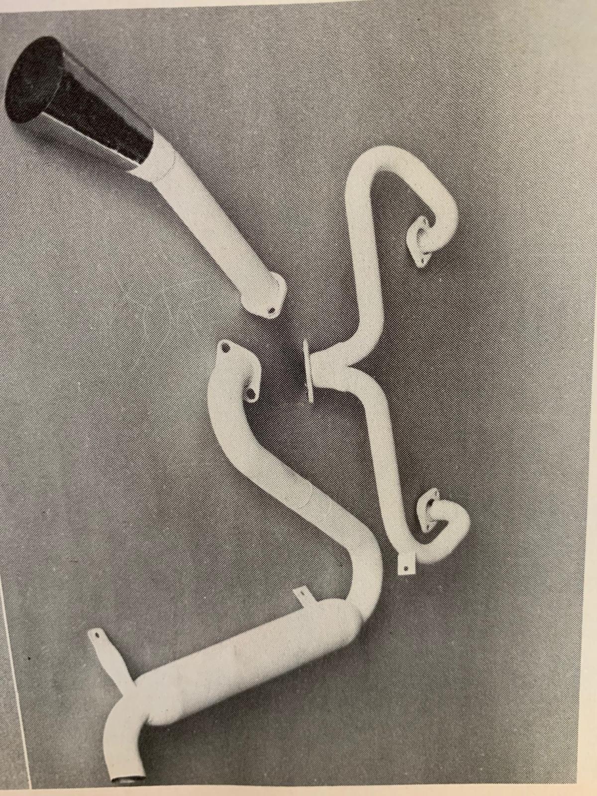

Fun photo of the day. This is the current exhaust set-up on my Corvair buggy. It's not that loud but sounds like a VW! Need to find an exhaust that fits inside the Transvair cage.

Honestly if the clutch and brakes work good use the hydraulic setup. The Corvair uses a push type throw out arm , not a pull type like vw so you will need to fabricate a pulley system to make the cable pull on the arm

PostPosted: Fri Jul 26, 2019 9:12 am    Post subject: Re: Bounty Hunter dune buggy build thread Reply with quote
[quote="dlyle"]Here are a few that I have. These are the before pictures so a bit dirty. Looked brand new after a wash. The plan is to go back to the original VW pedals and a manual cable clutch. Hoping to find a Transvair instruction manual so I can figure out how too do it. The one article I read about it says the Transvair kits comes with a clutch shaft that increases the throw of the clutch. Assume that tis would be the clutch shaft and arm that is in the pedals.
/quote]
Since the hydraulic system is already in place I would stay with it, if needed maybe clean up any bracketry or lines.

PostPosted: Fri Jul 26, 2019 9:20 am    Post subject: Re: Bounty Hunter dune buggy build thread Reply with quote
I used the stock U tubes from the dual exhaust set up and added some super-trapp style mufflers, the mufflers come in different lengths so you can get make it quieter.
http://www.corvair.com/user-cgi/catalog.cgi?show_page=35

PostPosted: Fri Jul 26, 2019 9:52 am    Post subject: Re: Bounty Hunter dune buggy build thread Reply with quote
manxvair wrote:
Thanks for the info. Can you please take a few pictures so I can see what it looks like and how the fit is?
Thank you!
I'm trying to reclaim some of the leg room that there current pedals rob by being closer to the seat than stock pedals. Plus they cut a hole in the firewall area that I'd like to fill.
