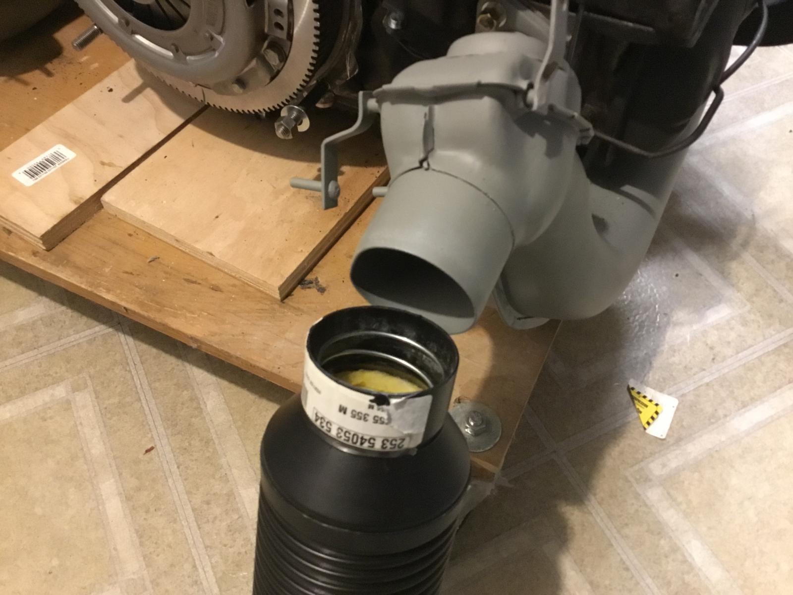

I know I need a set of rubber seals between the accordion hose and body like these.
https://www2.cip1.com/ProductDetails.asp?ProductCode=VWC-111-819-945-PR
But do I need another set to keep the tubes from melting when I connect them straight to the heater box?
I just took off the original rusty asbestos tubes and I am installing new accordion tubes and heater boxes from bus depot.

I’m guessing VW had the cuff there for a reason and it’s either to help seal the connection or to keep from melting the plastic or both. I made my own cuffs using high temp silicon mat I bought off of eBay.

There is a set on each end of the tubes, you need four bushings total.

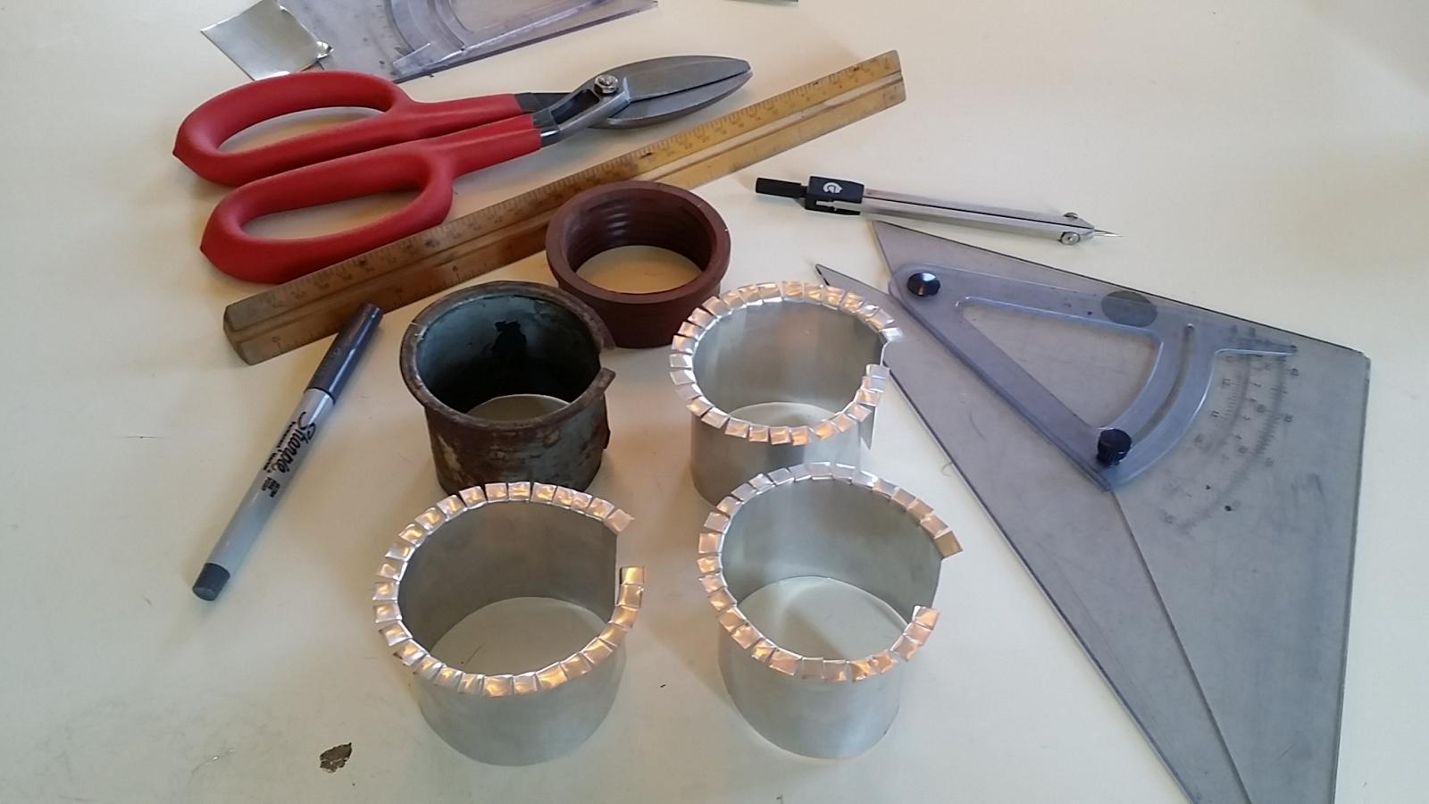

Without the insulation ends, the plastic pipe ends will melt. I swapped out the asbestos cuffs for vanagon silicone ones and made replacement liners.

Those short seals that CIP1 (and others) sell will not protect your accordian tubes from melting by themselves. They are just too short. You
can see that the outer black plastic is exposed to the hot air if that's all you use. If the engine gets really hot, you
could end up like the guy in this thread: https://www.thesamba.com/vw/forum/viewtopic.php?p=8023303
