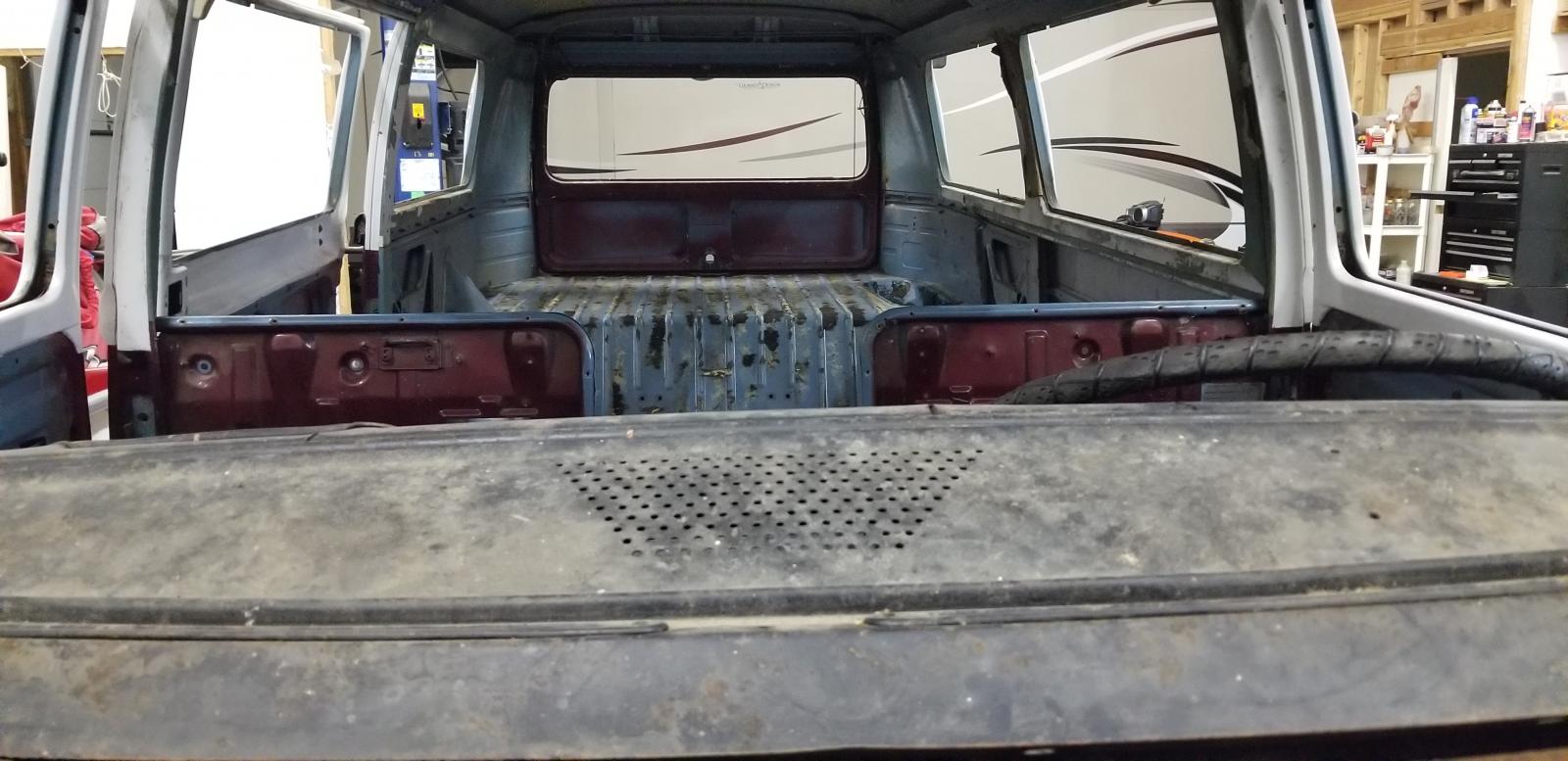

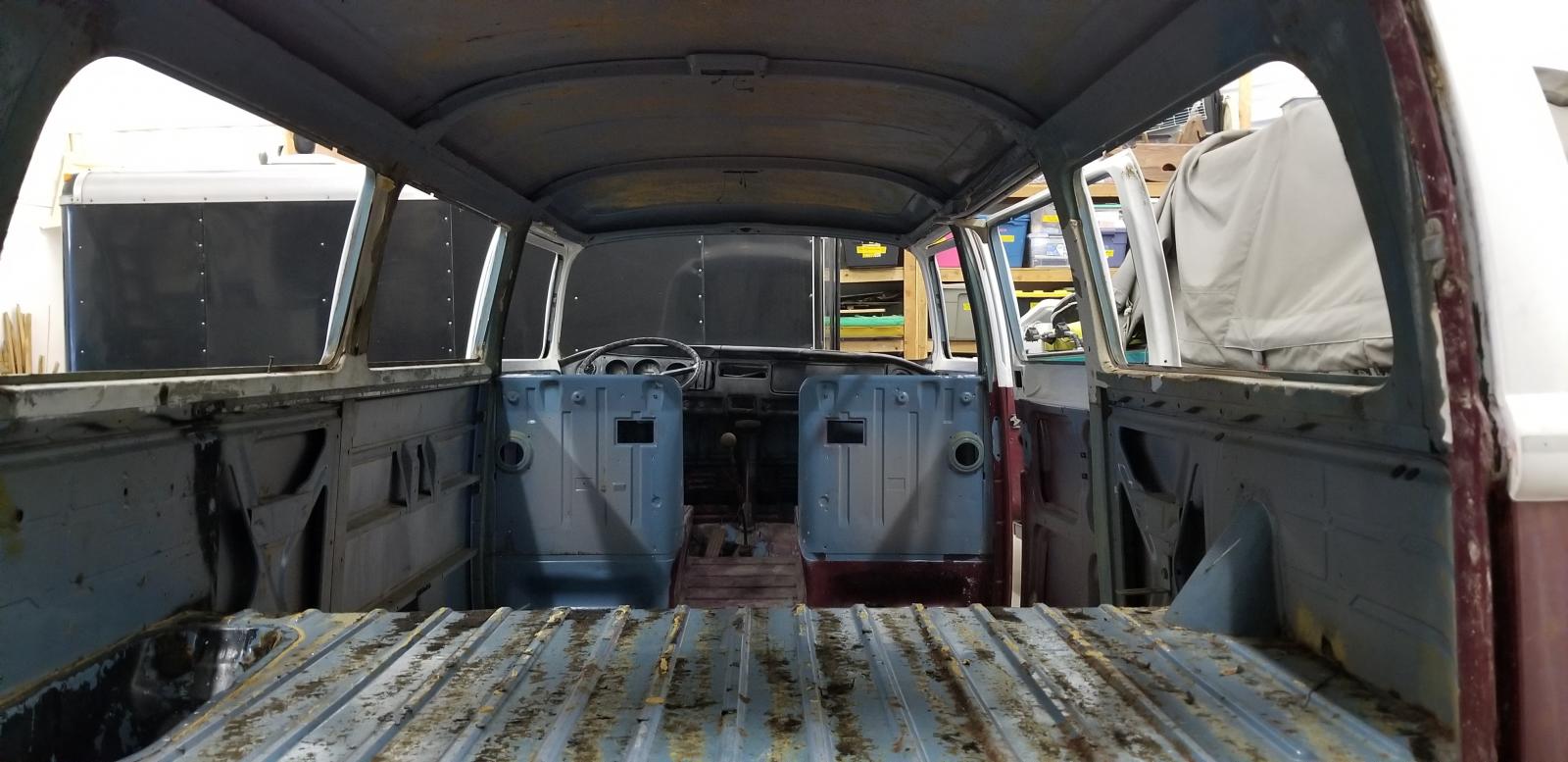

Found this 1970 VW Bus in a farmers field after it had be sitting for over 20 years. My daughter's dream car is a VW Bus so we decided it would be a father daughter project. Going back to my roots, my car back in high school was a 1969 VW bug that I rebuilt the engine in and painted. I haven't touched a VW in over 30 years so any advice from the VW long timers would be appreciated. I am sure I will make some mistakes along the way but figure if your not willing to make a mistake you will never accomplish anything.
Body is straight with at least one heavy bondo spot. Interior was trash, windows down, home for birds, squirells and yellow jackets. Tires were sitting flat for years, had it towed in out on flat bed. Engine was tired, H5 block out of vw bug, after some work I got it started, but decided I am going the complete rebuild route.

looks like it started life as a brilliant blue deluxe.
here's mine
here is what it came to me looking like
mine was gutted too. you have more glass than I did
