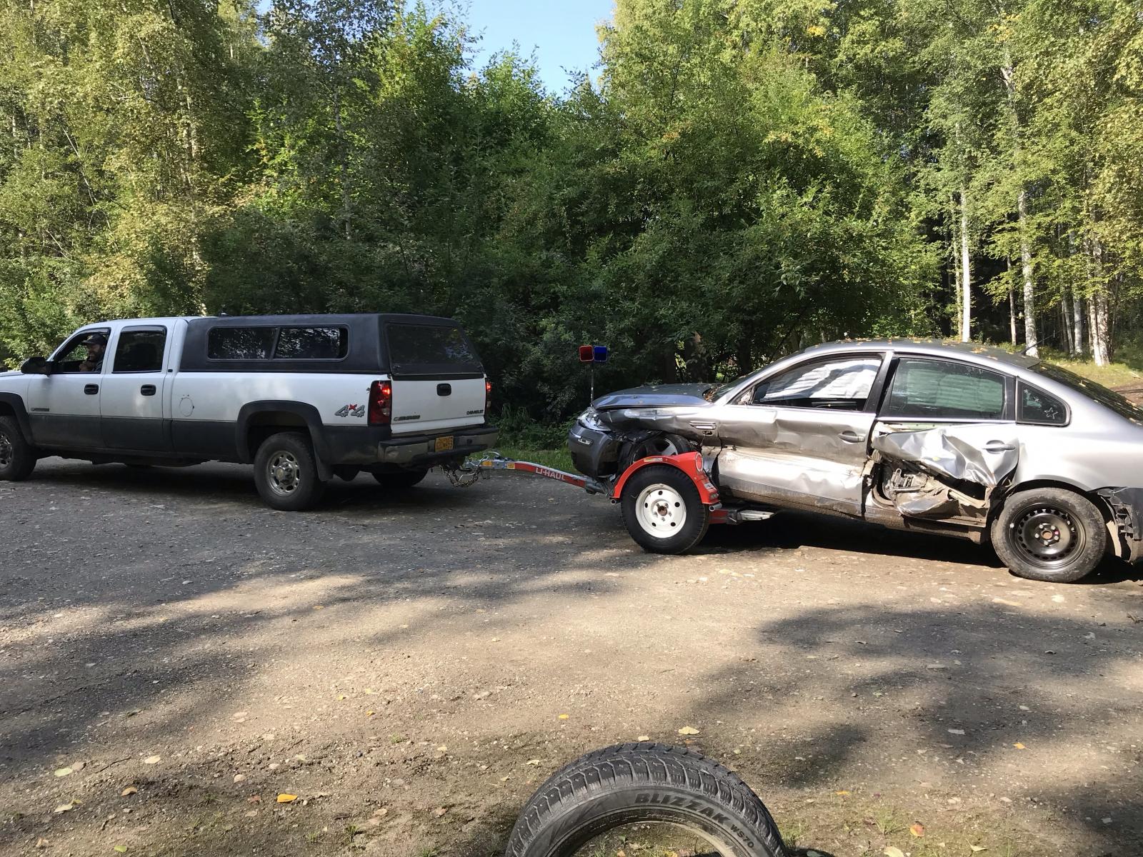

This 02 Passat was t boned at an intersection with the owners daughter asleep in the back seat. Amazingly no one was hurt! It has the longitudinal 1.8 T that Andrew prefers. With only 90,000 on the odometer, I was able to run the engine before pulling it.

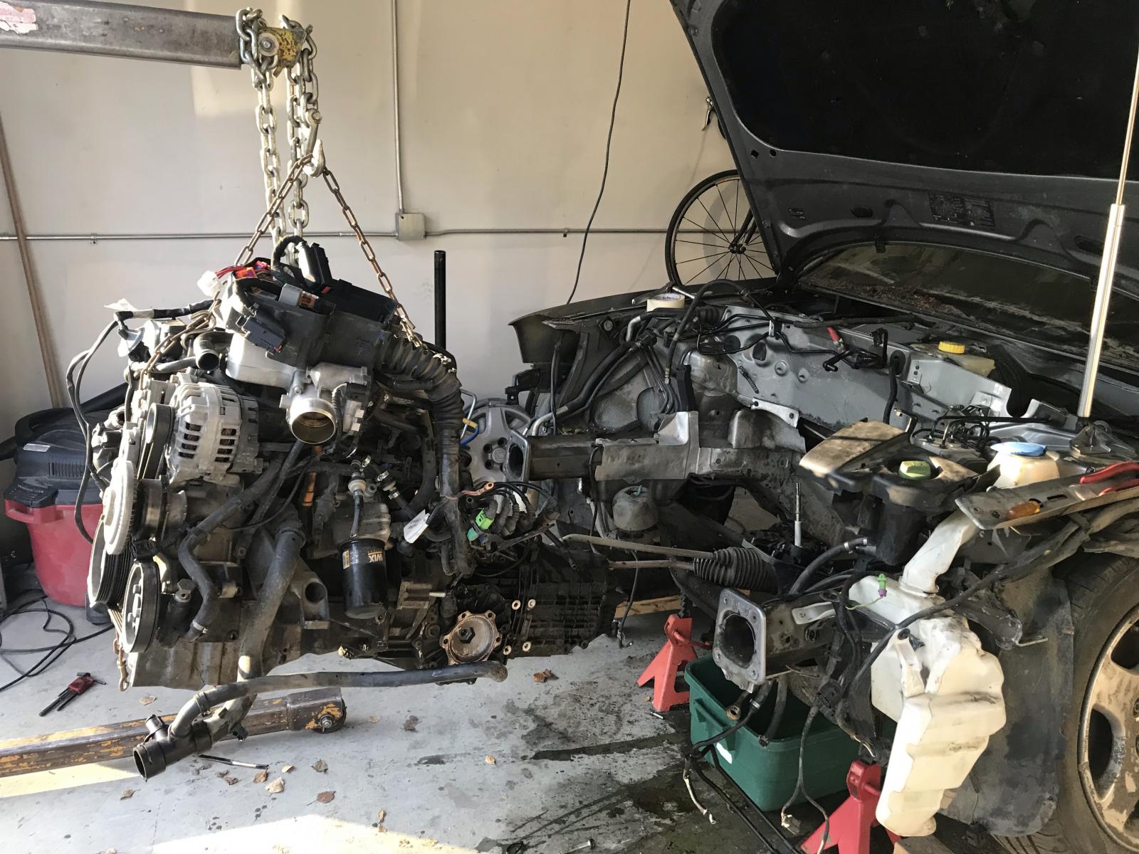

Enlisted the help of a fellow Van owner and friend to tow the Passat. Crunched vehicle like this presents some challenges but we made it work.
The biggest obstacle was getting it into the garage. Tow dollies are not meant for backing up!

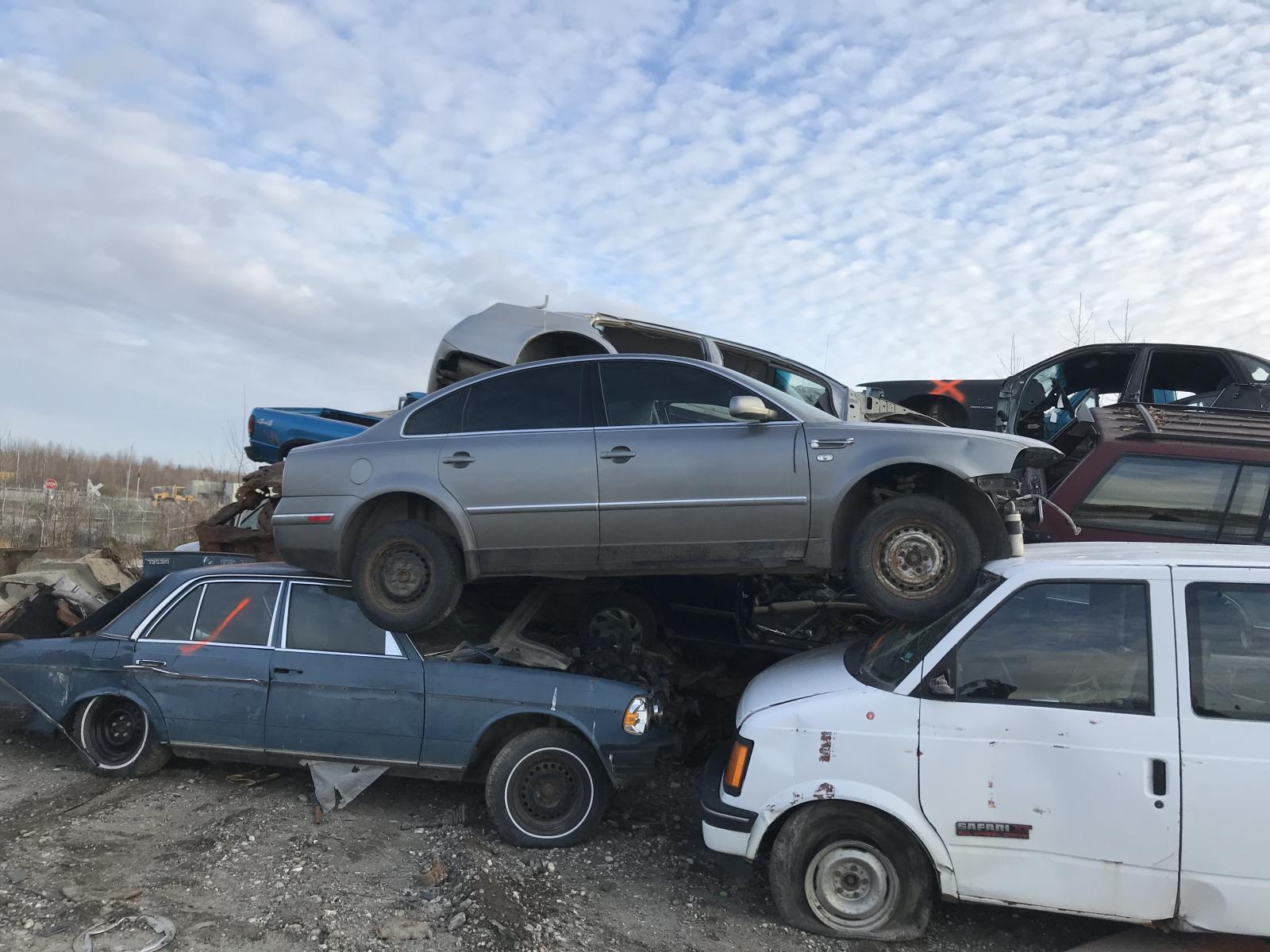

Where donors go to get crushed, the Fairbanks dump.

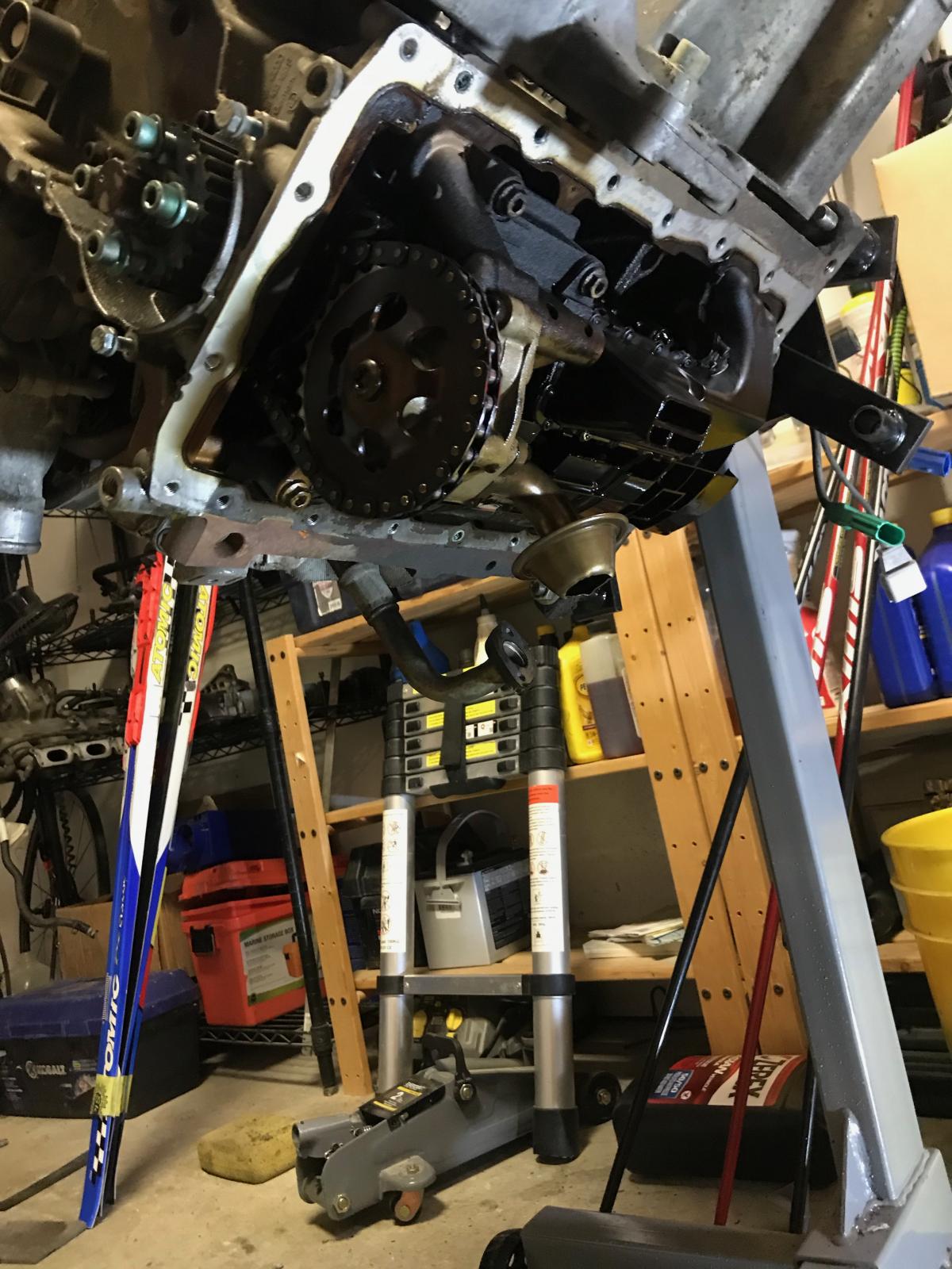

Phase 2- Just beginning the process of reversing the 1.8T. Feeling like I am stepping out of the capsule into deep space!
