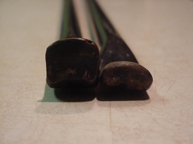

Okay, I searched old threads but could not find the exact answer to my question. Embarassed My 67 SO42 Westy originally came with the child's cot and still has the brackets but the cot itself is MIA. I know from the Type 2.com archives that it is supposed to have round, solid, black cot poles, and I know their lengths. I have ordered new cot fabric from Dawn at PLF and am patiently waiting for it to arrive.
But I need to fabricate these poles I guess. Confused I have never seen a split cot in person and am a bit at a loss to imagine how a round bar hooks securely into these angled cot brackets. Are these poles solid steel or tubular? Can anyone steer me to a resource that shows detail on split cot poles/brackets, or can one of you fine people who has an original cot snap a few photos and post them? Any help would be quite appreciated.
Thanks!!

I have seen the cots, but I don't have a picture. they are round hollow tube stock that is pinched flat and folded on the ends.

I can post pictures of the poles tomorrow.

Woody -- I'll go grab mine out of the bus in a little while and shoot a couple pics for ya.

I'm not sure how to add images here Sad But if you go do a search in the gallery for "split childs cot poles" you'll see the pictures I took... enjoy!

to post pictures in the forums, just go to the pic in the gallery, click on the pic itself, then the pic will re-apear just by its self. copy the URL and put it inside of the following: [img][/img] so it should look something like:
[img]https://www.thesamba.com/vw/gallery/pix/130449.jpg[/img
with a square bracket at the end. (if I make it look exact, you won't see the text, you will see the pic)
I went ahead and put all of your pics in this post.

Find a pair of 68-early 69 bay bars. They are 56 1/4" long, round and black. You can cut down and weld these for split bus bars. The front bar is 47" long and the rear bar is 55 1/4" long.

Thanks everyone for the help! This is exactly what I needed. What a great community. Flipseat, you kick ass, bro!! My 4 year old daughter thanks you in advance for her cool cot!
If I happen to find a pair of early bar bars, I'll use them. I'm a lot more likely to just buy tube stock and fabricate the whole thing at the local high school metal shop.

Most of the split cots I've seen have been "bend to fit". Each are just a hair different so you have to tweak them to fit your bus nicely.
Also, if you have safaris, using a cot can be a hassle. I have to disconnect my outer two sliders (take out the wingnuts) on the safaris to get the front pole in.

Lind is going to dig through his parts stash. He says the early bay curtain rods are made of the same aluminum extrusion, and thinks he has one or two bay rods. I can use that and bend three to match the two that I do have.
Isaiah is going to get exact measurements on his cot poles, then I'll go looking for material. I think I'll make a dozen sets over at the high school this spring. I'll just ship them in raw steel treated with Picklex so people can paint or powdercoat them after they have done a trial fitting and "adjustments" for their own bus. I'm going to powdercoat mine since they tend to get banged around. I can't imagine these costing very much to make; I figure my time in the metals shop is worth $25 an hour. Mild steel tube is cheap and once you get the hang of making them, it shouldn't be too tough to make several. At least I expect so.
I have no idea where to come up with the pole brackets though. That part is aluminum and would have to be cast. Not anything that I have any knowledge on, but I see them for sale fairly cheap here on the Samba from time to time.

the bay brackets are different from a splittie, however the brackets that are found on the inside of the fiberglass "rack" on a poptop bay are very similar to the splittie ones and there are like a dozen on each poptop bay.
