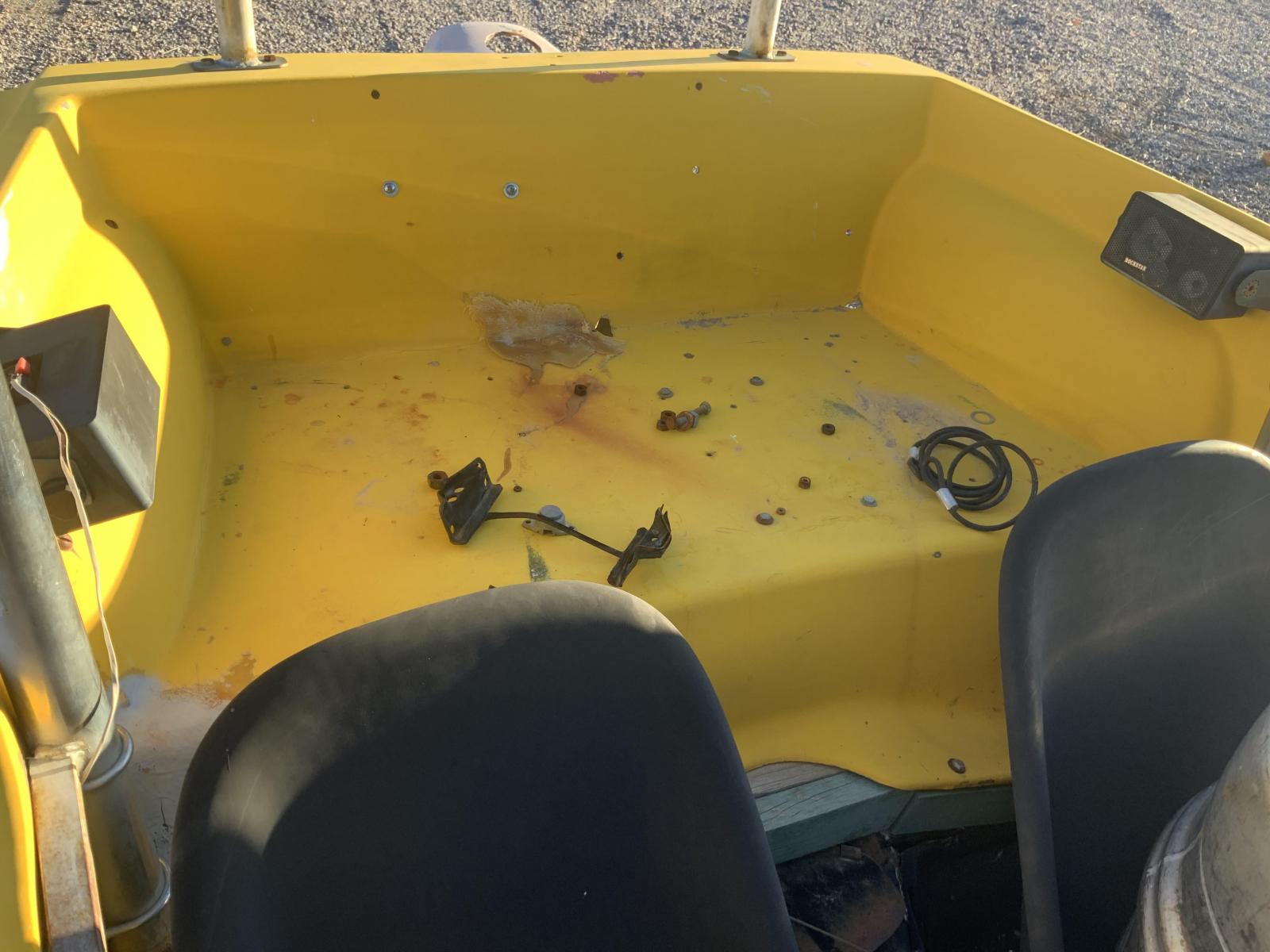

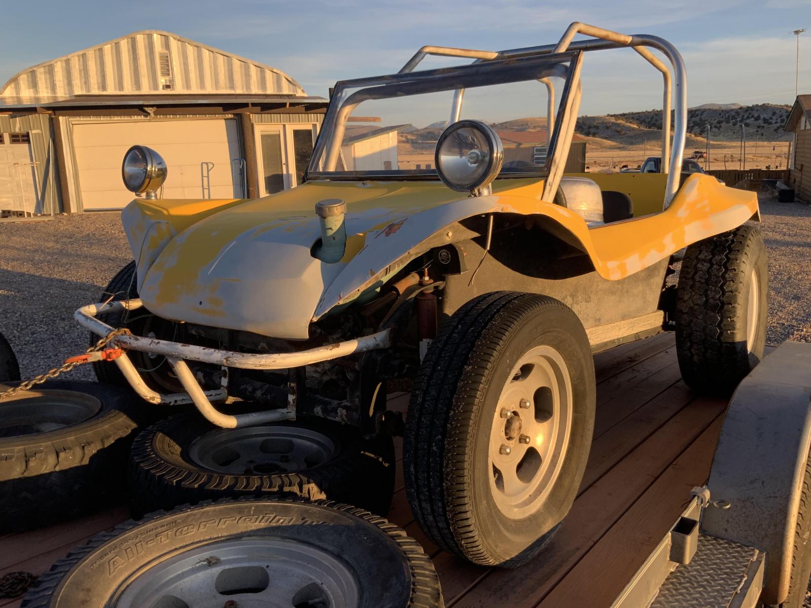

I plan on buying my first VW Dune Buggy project before the end of the week, at this point im pretty confident im going to buy it because the price is right ($600). I know very little about these but I've wanted a Meyers Manx as long as I can remember, and this is close enough for me.
I looked at the car back in 2016 (when I took the pictures below) but ended up not buying it, but 3 1/2 years later its in the same spot and im in a much better position to work on it.
All that being said any tips or things I should be aware of before diving into this? Anything the more experienced people can tell me about it from just the pictures? All I really know is its yellow it resembles a Manx but isnt one and its got a VW pan, its also got 5 lug rear wheels which kind of stood out to me.
I did also check the ID the buggy thread and the DBA to try and find out what it is but didn't see anything that was identical.

It will be interesting to see what the floorpan is made of. Stock VW pans or thicker sheet steel. Looks like it has some sort of angle iron at the body to pan joint. I like the roll cage. Hopefully it's bolted to the floor or else you are in trouble where it's bolted to the back of the body. Keep us updated !!

There will be rust. At $600 I think it's a no brainer. Hopefully the carb has a cap on it and no water has gotten into the motor.

Looks like it has a ball joint front end.

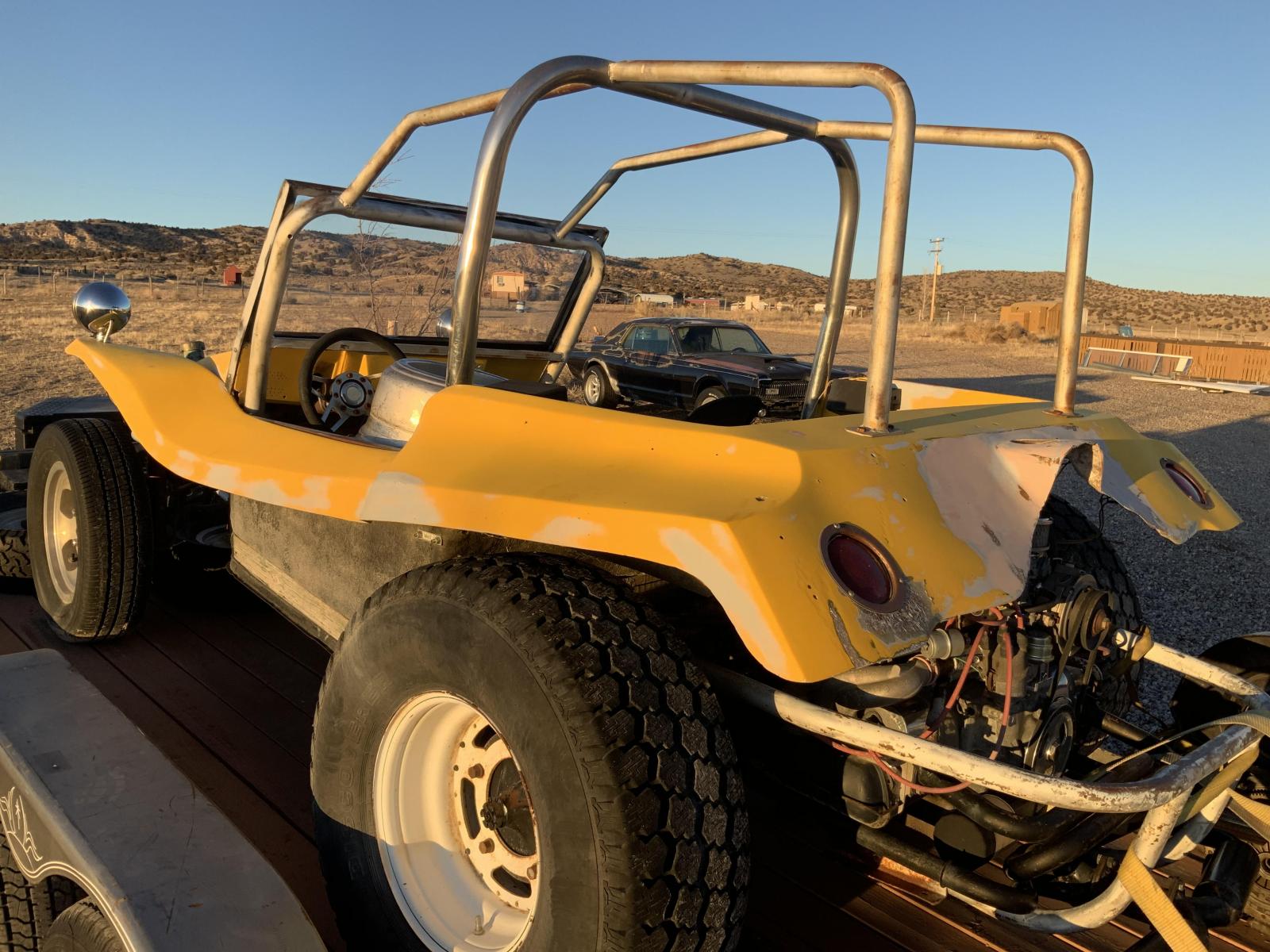

I was able to zoom in on the pics and it does have a tiny paper air filter on the carb. Also, it has one of the filter pumps with a large Fram oil filter that almost touches the header. Centrifugal adv dist. I don't see CV axles. I do see what appears to be swing axles but the centerline of the axle doesn't seem to match up with the CL of the hub so I wonder if somebody converted it to bus reduction gearboxes with the RBGs laid flat ???

Chrome tin and fan shroud. Alternator not generator.

A lot of VW swing axle outer tubes standing on end by the building in the second pic.

There are lots of spares that im sure they're willing to sell I know that green gang box is full of parts and theres a back room in the garage full of parts. Also what I think is a kellison super T in the garage with a Porsche motor.

It does appear to have vw pans but they look to have been replaced at some point, got some nasty looking welds along the frame tunnel. Didnt see any holes but they are pretty banged up.

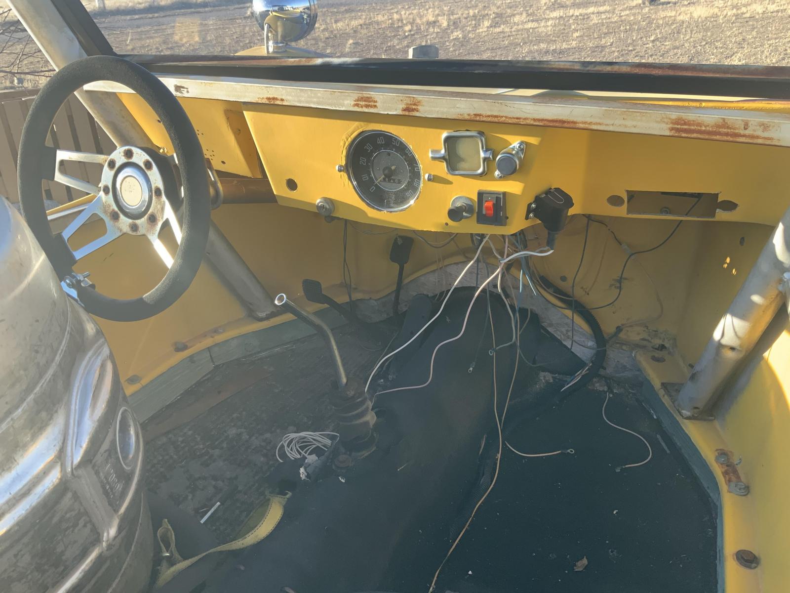

Its also got a pretty janky wood body lift that the cage is bolted to. Probably needs a complete rewire and the brakes dont work.

Mount the headlights on a more stable part of the body or even on the front bumper. Front fenders like to flap around and you'll have flickering lights and broken bulb elements all the time. Either that or fabricate a bracket off the beam somehow to support the lights.
Build a new cage or figure out a way to attach it better. Those small tabs on the floor aren't going to support anything if something happens. One thing I have seen is people who run 2" flat bar along the entire body to pan lip and at the tubes run tabs down onto the floor, so the entire pan supports the cage and the tabs help spread the load onto the floor.
Don't worry about the missing tins on the engine , on a buggy you can get away with a lot more than an enclosed car. If you are offroading a lot then you should worry about protecting the pushrod tubes but on a street car, that fan shroud and head tins will cool more than enough.
Most people hate wiring and it shows. For a harness I would look at someone like Rebel, and unless they have changed them, I would stay away from the cheap empi harness that is made with cheap 16ga wire.
