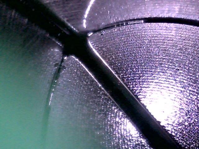

Well finally pulled the plugs again and drained the oil to see what the problem may be. Thought at first it was the starter stuck. I probed inside a couple cylinders and inside the oil pan/crank case and this is what I found.
In the third photo it appears that a ring slipped off. Not sure what I'm looking at in pictures 4 & 5. But it was taken thru cylinder four spark plug hole at the top of the piston.
#1 photo has me baffled and well as photo #2, looks like a chunk of metal has broken away.
If anyone else has an idea I'd be glad to hear from you
Jeff

PostPosted: Fri Feb 07, 2020 5:17 pm    Post subject: Re: '66 13-Window in Iowa Reply with quote
What the HELL are we looking at here? are your cylinders half full of liquid? Petrol or oil? 1st and 2nd photos look like nothing I recognize.
