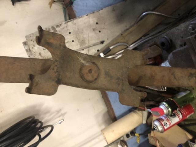

Need help identifying Porsche 356 rear compensating spring that came from a 1957

Not an expert but it looks like a regular EMPI camber compensator
I can't tell myself if it's an original EMPI unit though

Yup that's a vw compensator for 61 and up transmission not for split case transmission .split case would have a skinny mounting bracket ...

Yes, it similar but I don't think they are the same exact one?
I believe the Porsche model had different length "arms".
vws unlimited:
Post a full width measurement of if you want people to check against other known lengths - VW or Porsche

This is an old add ...the center mount looks different I know can't tell as much but I can lol ... https://www.thesamba.com/vw/classifieds/detail.php?id=2215538

Thanks for that research
Got it - you are correct it is different.
Maybe this is a VW unit, I guess it fits too if it was really pulled off a '57 356. Smile

All empi did with these was have different center mounts/brackets for different trans everything is the same ...they would of used one size length compenstor " one size fits all" it was faster and easy money just to use the same specs but just changed the center mounts for different transmissions .because vw and 356 swing axles are basically the same specs ...but on the porsche 356 empi compensator most weren't bought because on the 356B porsche started selling the 356b ,c sc with there own.. so it's rare to find a empi 356 one since the only folks who would buy one were 356A folks since they never came with one back in those days not much folks bought them or did that upgrade or cared ... myfriends uncle told me he went to the porsche dealer and ordered one in the 60s and bought a porsche one and used it on his 356A so empi ones wernt sold as much because folks could of bought the "porsche"one from the dealer ...

I have a new Empi one that was sold as a vw compensator. I just installed it on my 58 356, I did have to make a new mounting bracket. I believe you could use the VW one if you added to the length of the bracket that bolts to the trans, about an inch. the center section of the 356 is bigger deeper not wider than the VW.

Ahh. Finally ran down info on this Empi bar. They did make a center plate for the Porsche 356, as advertisement shows.
Owner of 356 went to dealer and this is what they installed, probably cost less than orig. bar setup. So all those years he thought he had an original but was an Empi.
Interesting is that center plate has patent number and looks like a Porsche number also?? Trying to get it media blasted to see if number is completely legible.
So we can see why he thought it was OE.
It is still a very interesting piece from 60 plus years back.
Almost forgot to post that we found original drawings and patent number and date.

Oops. Gotta clarify that’s the way the story was told about the compensating bar but now it seems like it was also used on a VW. Plate may be modified or swapped. Rolling Eyes
Don’t know what I’m going to do with this bar.
Any suggestions?

Since it looks like a regular VW bar, I'm sure you could sell it to a VW owner

Yep. May just clean it up and hang on the wall.
Looks like they did sell some for 356s in the 60s.
Beginning to think that someone just modified it to see if it would help the handling.
I almost believe it being on a 356 Because I bought the engine with 1957 serial number from same person. But he also had 6 early 911 rebuilt heads and crankshaft.
I’m going to sell all the 356 engine parts don’t know about other stuff!

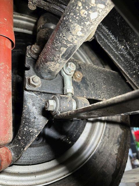

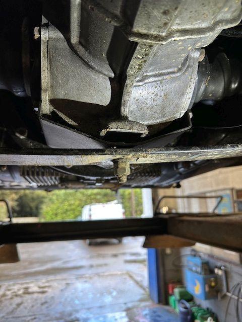

Hi chaps, newbie 356 owner here. I seem to have a 'cobbled together' compensator spring. It's a leaf-spring-type arrangement that first caught my eye as it has two completely different length vertical 'adjuster' arrangements on opposing ends.
Is this an EMPI set up? Is it needed? Should I keep it, if so, which 'upright' is the right length (you can see one end has a hex spacer / connector, the other end does not so quite different lengths.
Thanks guys.

Thanks Jacks. It does seem my end terminations are slightly different but same concept. I'll look at getting matching length components as assume the regulator should be sitting relatively parallel to the ground, which it isn't currently.
Also sounds like for general pleasure driving there is a very questionable advantage to having it fitted, correct? Car is B T6 so believe that has the thinner torsion bars?
356 B:
The models 1600 and 1600 S had normally no camber regulator. (but as upgrade option possible)
All Super 90 and all 356 B Carreras from factory came with camber regulator.
All models without regulator had torsion bars with 24 mm.
All models with regulator had softer torsion bars, with 23 mm only.
356 C:
There were torsion bars in 22 mm and 23 mm.
