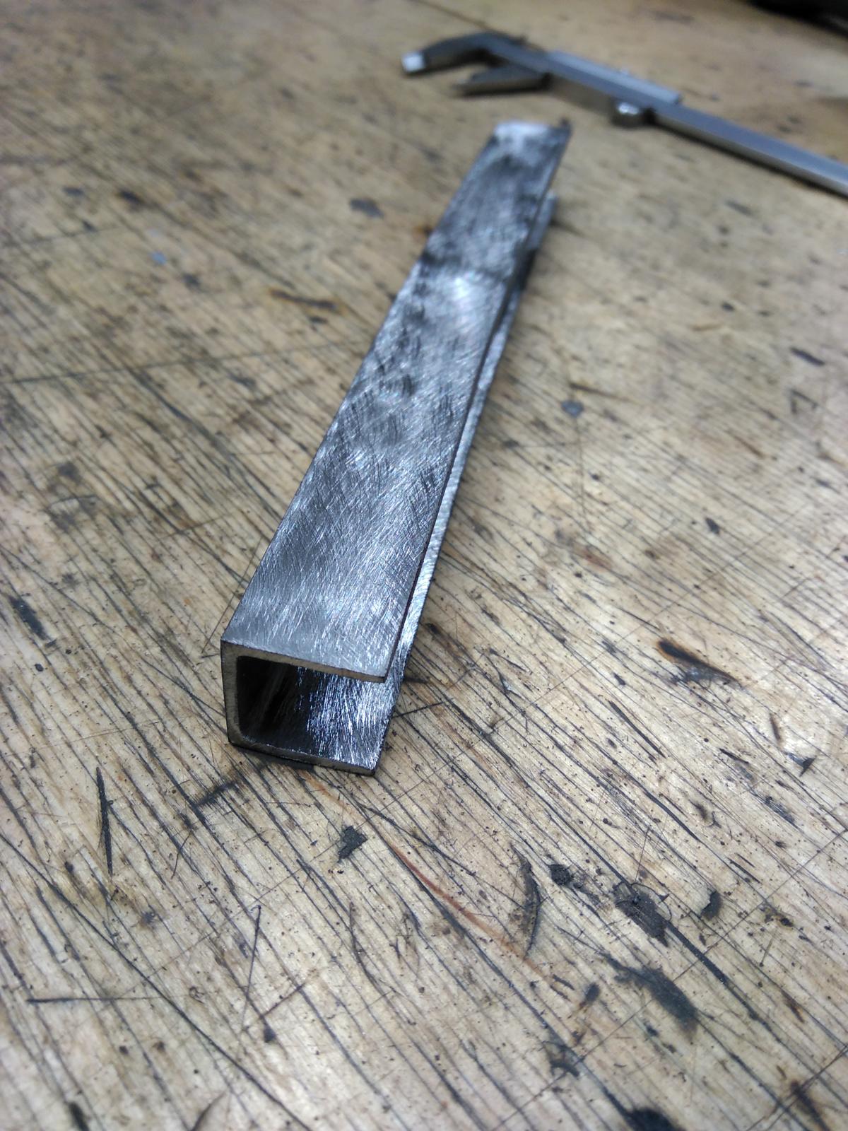

I'm working on the box profile for pre 58 reproducrion of the roof racks. During this project I decided to make box C profiles only for 58 westy roof racks. This very hard and longtime job. It is not quick and easy. I will try to use my box profiles to make C profiles legs.
Now you can see the short piece of profile made for quick test. I think I can do them Cool
The 58 only westy roof racks will be offer only for special order !!!

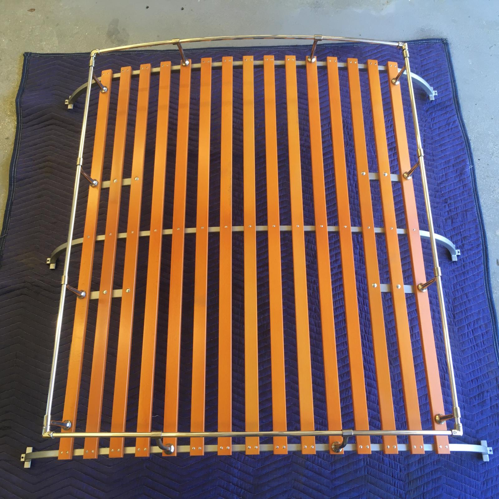

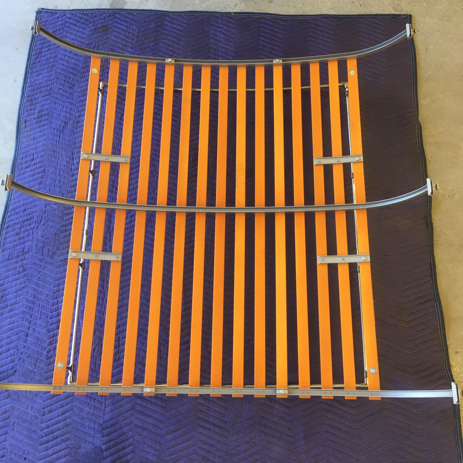

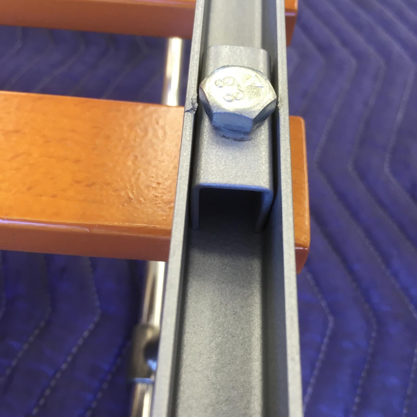

Sorry to hijack Jaceks thread. It made more sense to me than starting a new one. I started this '57-'58 roof rack project in private in 2016. Part of it was outlined on the KCW website in 2017 but they have since lost the data. If you follow me on instagram you have already seen and heard about this project.
After several years of working on it, I recently finished up my reproduction steel parts for the '57-'58 era Westfalia racks. The metal parts are all painted the correct shade of silver and are available for sale while supply lasts.
These parts are as accurate as I can make them, and I've used my original '57-'58 rear rack to compare against in person on every step of the fabrication process.
The steel parts are all laser cut and die stamped, so every one matches the next one. The feet are tig welded to the legs in a custom welding fixture to maintain the best possible alignment. The wood slats are milled from imported European beech, and the holes are drilled in perfect alignment on my milling machine. On the rack pictured below I applied four coats of a quality finish which matched my original.
If you have any questions, feel free to send me a message. I have an ad on thesamba with current prices now. This is a very small production run. I only made ten sets, and half of these are already spoken for. Even though I've invested a lot of time into custom made tooling, this is and I expect never will be a mass produced item. They are too labor intensive to make. There will be variable pricing depending on how complete you want the kit and to what level of finish (paint, varnish, etc).

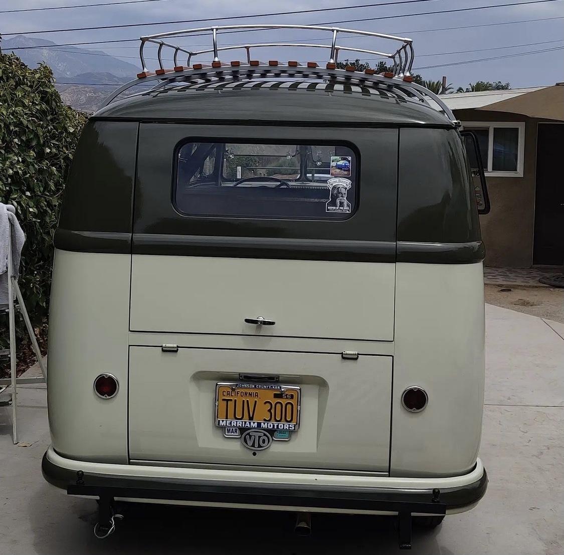

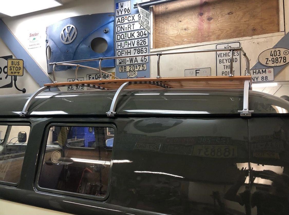

Here is a photo of a rack "buseric" assembled using my metal parts, he finished his slats in a more natural finish which looks really nice on his bus:

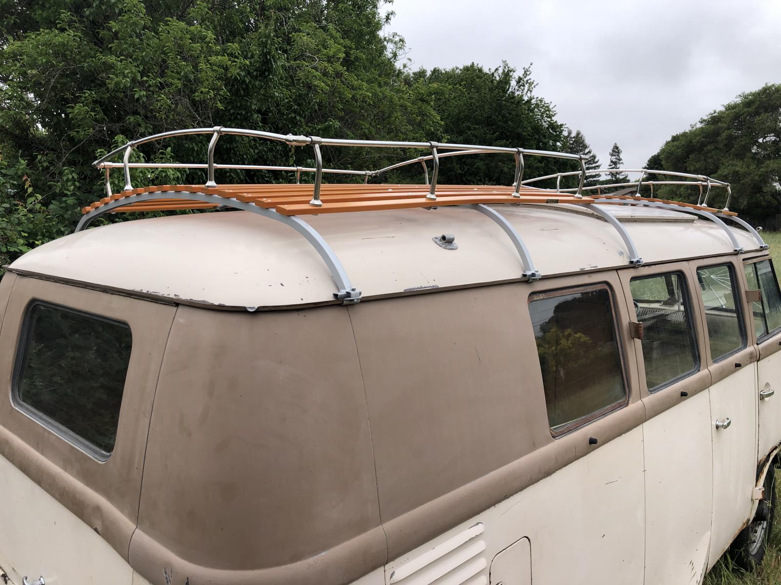

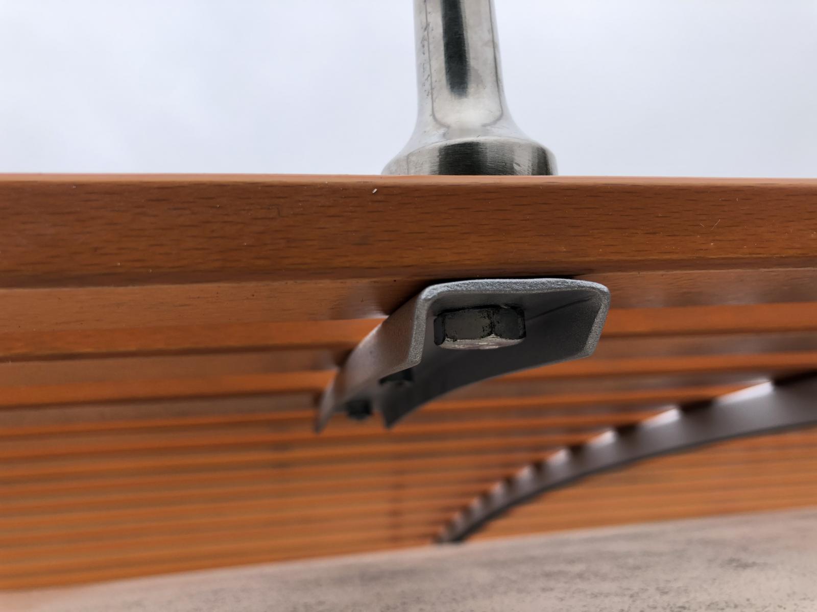

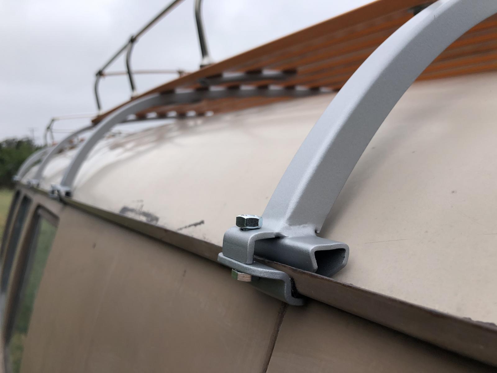

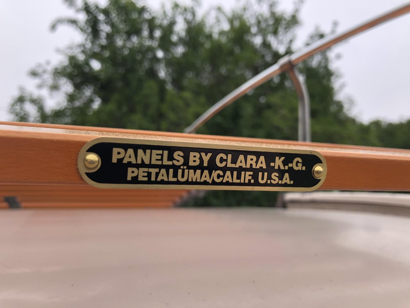

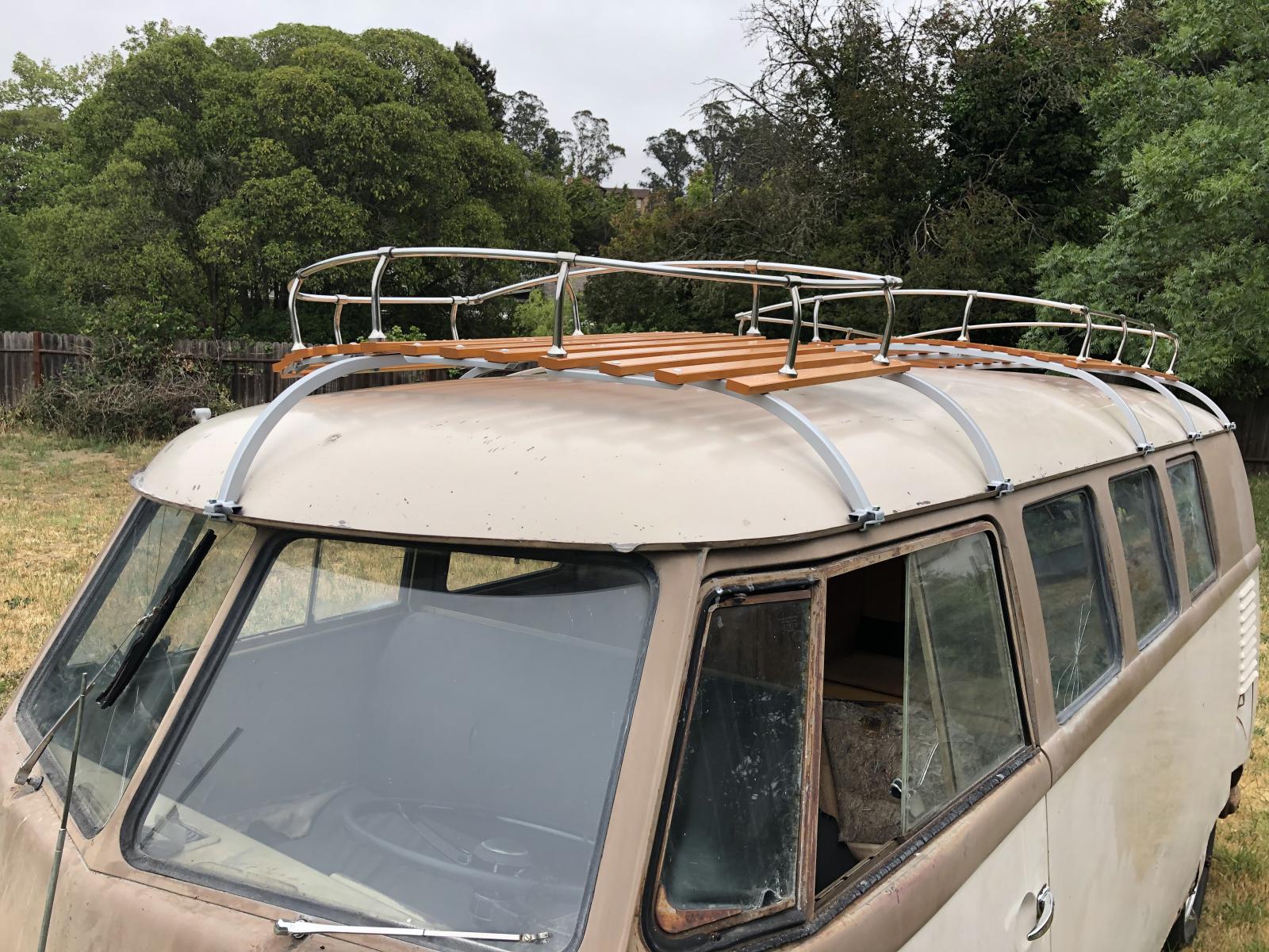

Here are three more ‘58 westfalia racks assembled and on their permanent homes. All three buses are the same color (PG/SG)
1)
2)
3)
It’s very satisfying to see buses that have gone without a hat for years completed with a very correct example of what it would have left Westfalia with.
Thanks for the support, I really appreciate it.
