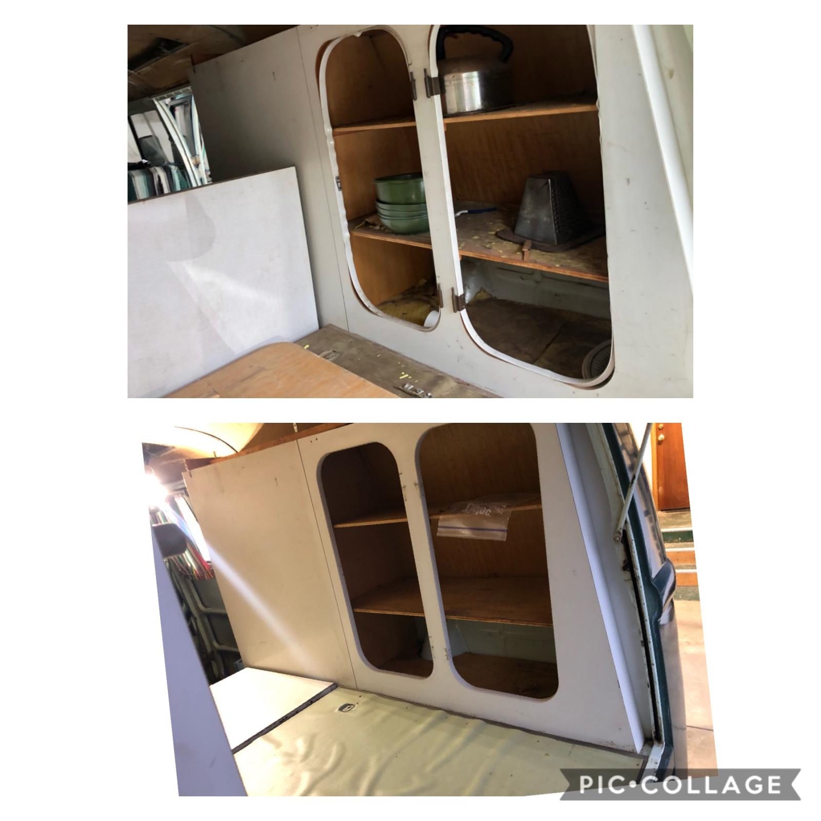

I’m missing the 2 doors for the rear cabinets in my SO34 and I’d like to build new ones.
I have the material (an old Bay table looks like it’ll be a good donor).
I’m pretty sure I can get the T-molding groove cut with either a router bit or super thin saw blade, but I’m unsure how to cut the pockets for the hinges.
For anyone who has done this, any pointers? And anyone got a couple of sets of the door portion of the hinges they can pass along?
Thanks!

I have a slot cutting router bit set. Find someone with a subhatch, send them a PM and ask them if they will make and mail you a paper template of their doors with everything marked. Then cut the doors rectangular on the TS, cut the corners on the BS, and sand to the edge on my disc sander. Cut the T-molding slot on my router table and you should be in business.
Almost... up to that point, it's all pretty simple...
The "gotcha" is the additional slot that needs to be cut for the door side of the hinge. It looks like it goes into the door about 3/4". I wasn't paying super close attention when I had the closet door apart because I was more concerned about getting the T-trim back in. But it seems like it's about 1/16" wide and 3/4" deep (probably 1/2" deeper than the T-trim groove?) to accommodate the hinge. then the side of the door needs to be drilled for the 2 retaining screws which I'll have to figure out how to transfer precisely from the hinge to the door..

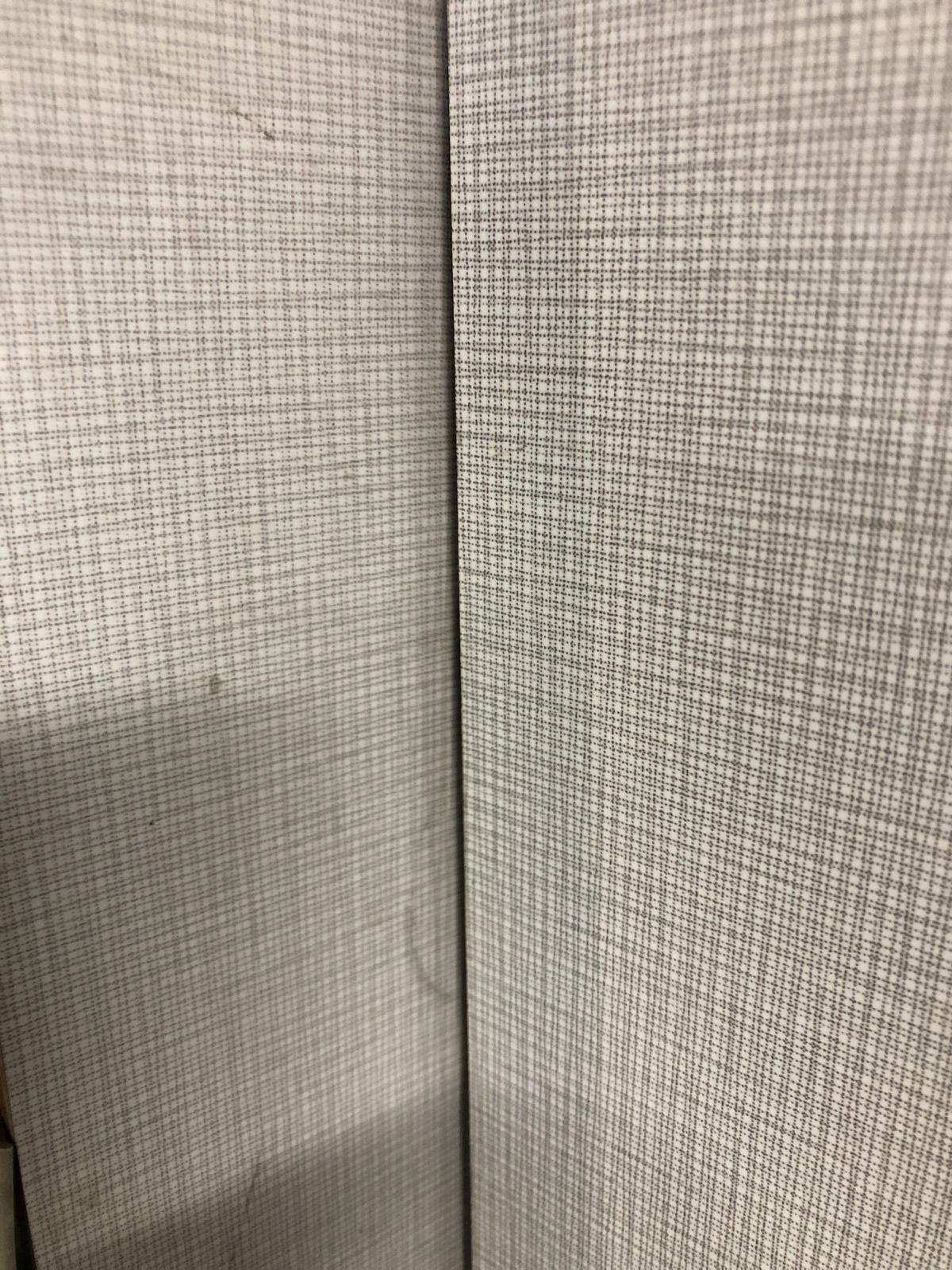

PostPosted: Sat Jul 11, 2020 12:41 pm    Post subject: Re: Building new cabinet doors? Reply with quote
ZENVWDRIVER wrote:
GOOD IDEA - using the Bay LINEN Formica table to make your SO34 doors - it'll look sweet.
Yup... they're exact matches... one of these is justs dirtier than the other.. I don't even remember which is which in this shot. Very Happy
