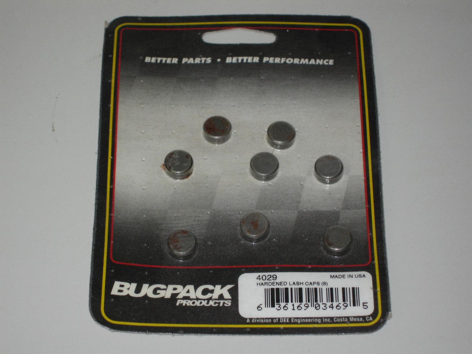

Would you folks use these? Question Good stuff Question Question Question Weak Question Question Awesome Question Question

I have them on two personal engines. The part quality itself was good imo, but it looks like some moisture has seeped into the package causing some corrosion. If it’s simply cosmetic, wipe it off, and go. If it has created actual pits, you’ll need to determine if they are in an area where the rocker is going to wipe, and cause irregular wear.

those or the scats or empi have all been good when I used them. just dont use a tight lash cap it needs to rotate.add a drop of oil on end of stem before installing.

Beautiful, just a fine amount of surface rust Smile They smoooth Cool

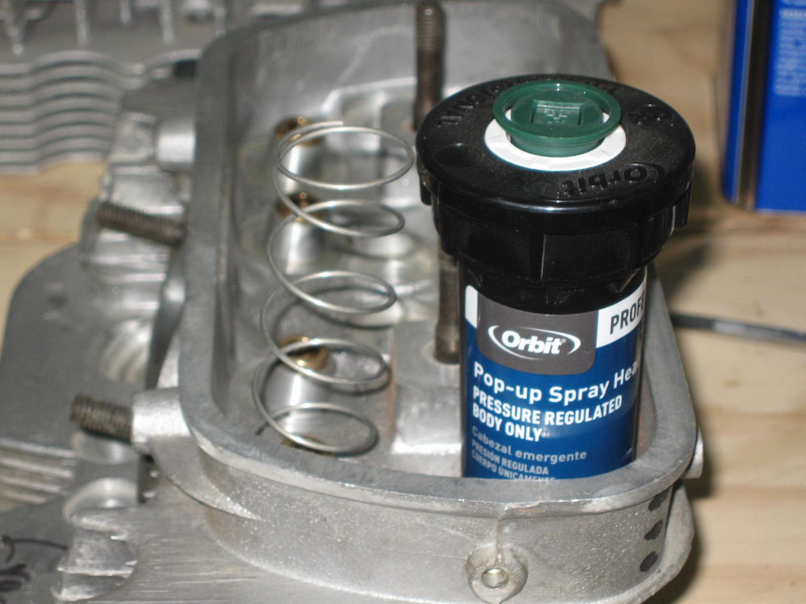

Caps Arrow Arrow
We Love Orbit Cool Cool Cool
The C Clamp, Way better for this app. Cool The spring difference Very Happy Cool Very Happy
