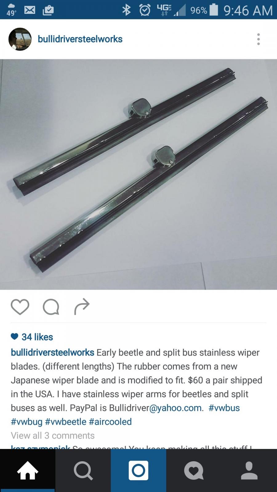

PostPosted: Thu May 05, 2016 6:55 am    Post subject: Re: Improved windshield wipers Reply with quote
Chad just posted these:
1957 Beetle
1966 Bus

PostPosted: Sat May 07, 2016 12:47 pm    Post subject: Re: Improved windshield wipers Reply with quote
Sixty bucks...! Sheeesh.
For zero bucks, I like to put a new edge on the rubber with 400 or 600 wet-or-dry sandpaper: wet the paper, slap it onto a piece of glass, run the blade lengthwise back and forth. Bing! New edge.
