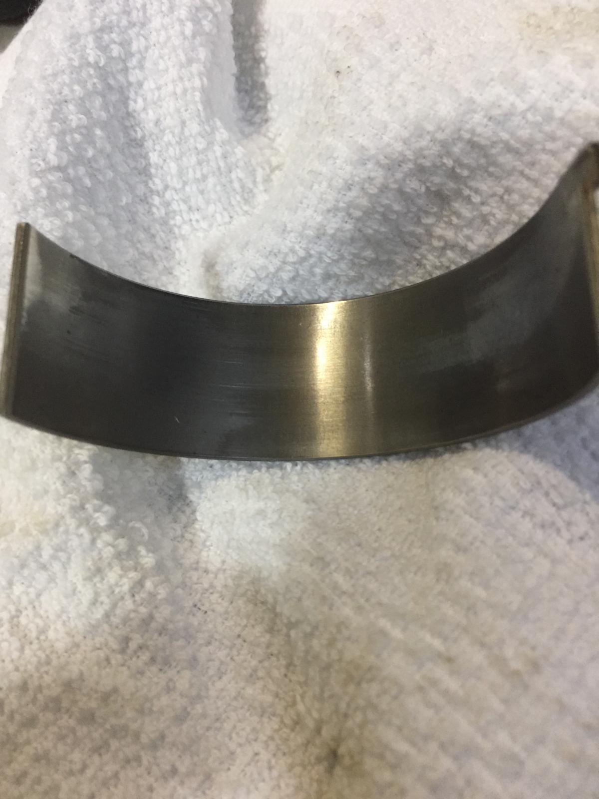

I’ve my 2600 type 4 apart to fix an oil leak and inspection , after 20,000km .
The mains are fine but the rod bearings (Silverline)have wear but only on the piston side . The oil pressure is set to max of 60psi hot ,using a 10W50 syn oil .
I’ve noticed in a recent thread that no one seems to use Silverline rod bearings , so I’ve got a set of KS bearings to try , What are the issues people have had with Silverline rod bearings .
Is 60psi too low for an engine that spins just over 7000 rpm ?

Whatever brand rod bearings you use, you should always be looking at the material they have for the bearing surface.
Shiny white = Aluminum (not good for any performance engine).
Matt grey finish = oldschool Babbit (much better for performance).
If you are seeing wear on the piston side, I would also be looking at pinging issues, or detonation issues.
Something is causing excessive load on them.
60psi should be plenty for your applicaiton.

Wreck.
Can you show me a pic of the shell, I want to compare them with mine from a while back, I just replaced them with new and carried on using the engine. Mine Was polished in the bottom of the shell about 10mm wide and edge to edge.
I guess the most force on big end is at TDC AND BDC

50mm with 5.325 rods on a 78mm stroke . On a side note , the area I was concerned about , head sealing . Was fine .
Mark , no issue with pressure and have thought of reducing oil weight , the type 4 mains have internal oil grooves .
Tom , I have thought of detonation , the engine did have an issue for a little while which is now resolved .
Garrick , the picture of the wear is not brilliant . Hopefully you can see the wear .

Use a ball end micrometer to measure the thickness and see how much it's worn.

Wreck. Yours is similar to mine,but the polishing marks is fully across, edge to edge. That grey line in the middle could be a lowspot
How about for the price of a new set of shells put some engineers blue on the bearing surface, fit the rod to the crank, no oil, rotate the rod once, remove rod and look to see if the journal produces the same mark across the blued bearing
My rods are notched. Wonder if at high revs the notches are working too good.

Let's not digress down the 'you should run this oil' debate, but what are you running?
Looks like- as Garrick says, the film strength of the oil might be lacking at the points where load is highest.
If you're sure the rods and journals are round.
60 psi sounds fine to me. The fact it's lived happily for 20k km would suggest either the damage was done earlier on when you had tuning issues or ( if they mic up ok) it might just be normal wear for an engine turning 7k rpm on aluminium bearings.
The crank (AA ) was checked and balanced , I didn't check the rods (EMW) H beams as EMW has a good rep in the Type 4 circles .
I'm using a 10W50 local Aussie oil. https://www.penriteoil.com.au/products/hpr-10-10w-50-full-synthetic
I'm using a 30mm type 1 pump that was sealed to the case when the case went together to prevent oil lose from the pump body to case .
I'm going to try with a new set of KS rod bearings and reuse the mains . So far 20,000km has taken 2 and a half years . I'll pull it down again in another 20,000 for another inspection . lifter bore etc and see if the KS are any different .

Luke has a great point regarding the oil film strength. There is no relationship between cheap/expensive/syn/dino/european/USA when it comes to film strength. You might have oil that is $30 a quart and it only has a 50kpsi film strength. Quakerstate syn ultimate dexos 5-30 (green bottle) that can be purchased from walmart for $25 has one of the highest film strengths at 133,000psi. I would run that over your expensive 10-50 syn that let your rod bearings get like that.

Mine needs an oil change. I use 20/50 in mine, It always sounds better with fresh oil. I've been using 20/50 as a big end bearing cushion, My T4 has the same issue as wrecks does but haven't mentioned it now. I have run mine for years though, I just keep renewing the big end shells . New big end shells fixes the problem, Mileage brings it back. I don't think there's a cure for it .
I'm no oil expert but I take it the oil strength weakens with AGE/HEAT.
This wouldn't be an issue with a N/A mild compression ratio motor. Its got to be
off boost/on boost stressing the bottom radius of the bearing. Add some ping to it and the bearing stress intensifies, add more boost and load/stress at the bearing increases . Before you no it the bearings thinned out at the BDC/TDC position of the bearing. The crank Journals are probably still ok.

Yes, but even if you have 20/50 you might have a low film strength that can kill rod bearings early. I wouldnt play around, just make sure your using something that has a high film strength 120k psi or more
