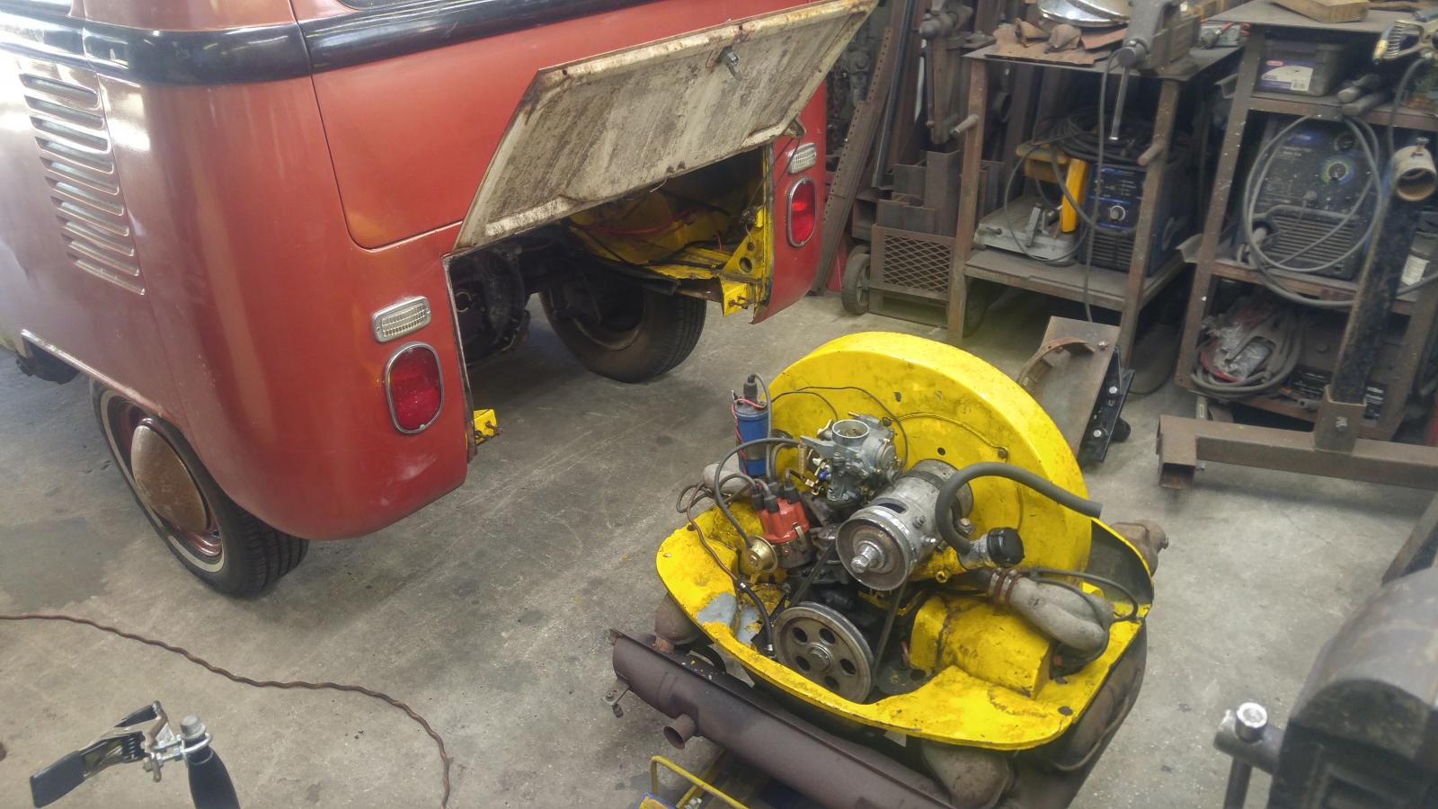

I had been storing the bus in my backyard for the PO. After the deal was made, it would run well enough to drive about 50 feet from it's spot to the garage. No brakes, varnish smell from the tank, old cracked tires, dead battery... what one would expect for a bus that had been sitting outside for so long. It needs to run, drive, and stop reliably. The engine was out within a couple hours of purchasing the bus.
The engine was pushed aside to focus on wheels and brakes. It all came off for sandblasting and painting.
This is just one of my favorites during this part of the project.
Documentation of the project is almost all video, but I'll be happy to update this thread for those interested.

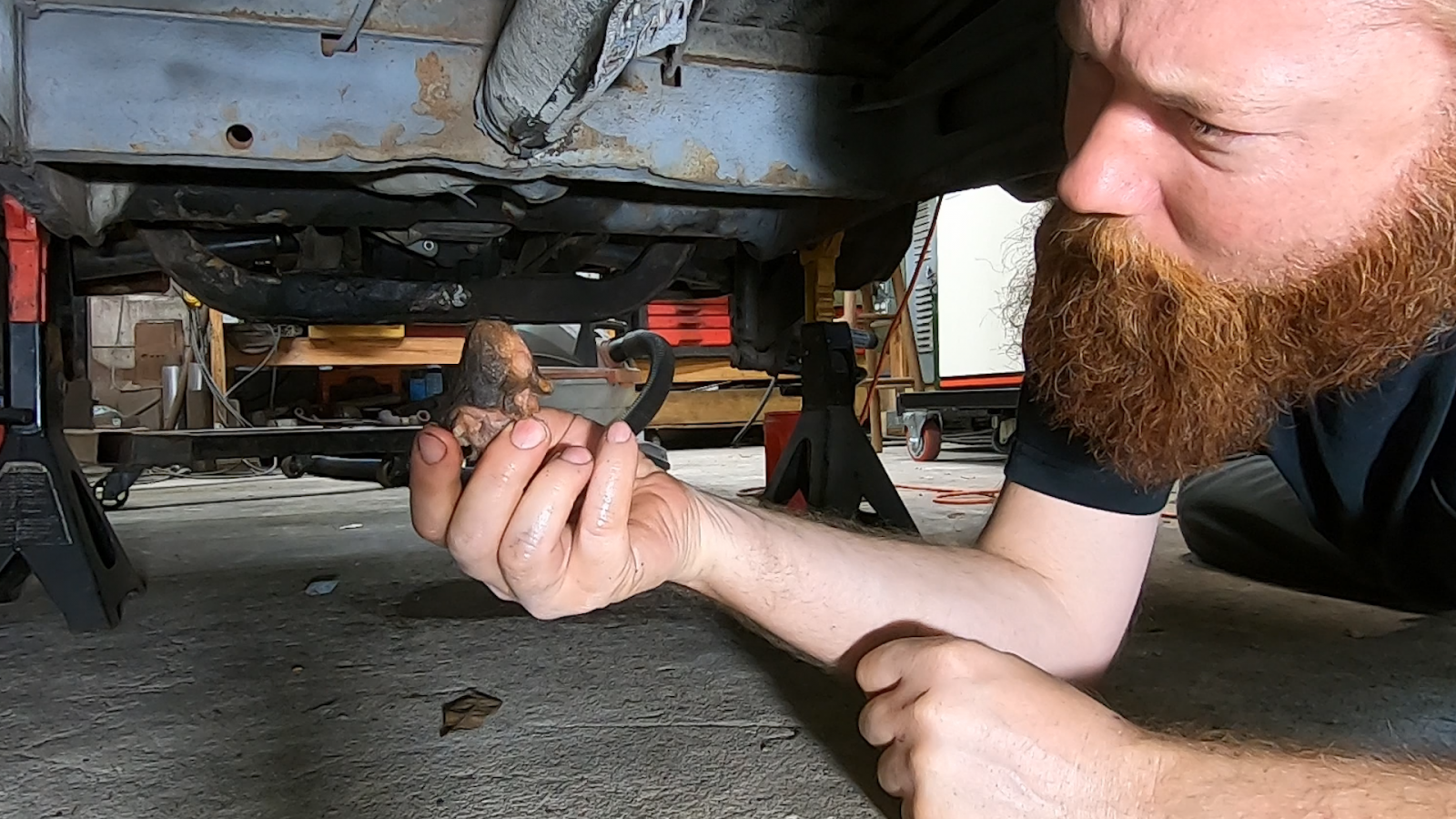

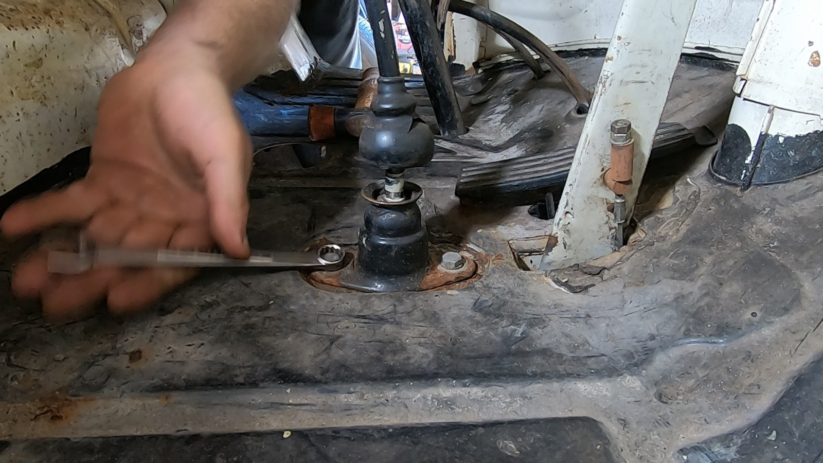

Tell me if you can relate: the shifter is a little sloppy but works fine once you figure out where the gears are.
I expect some of that with an old VW but want to at least make sure the parts are in good shape. So, off with the shifter!
Not enough time in this project to remove the transaxle for this, so the swing lever was moved out of the way and the shift rod came out the front. Made a mental note to replace these bushings anytime the transaxle is removed.

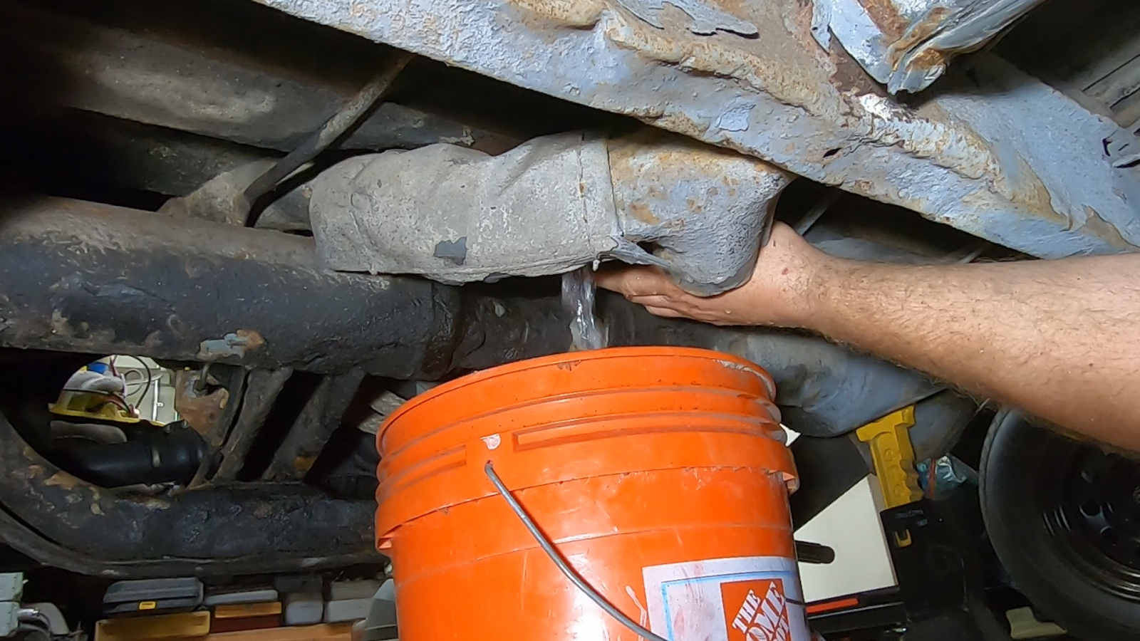

The shift rod tube had plenty grit inside, so it seemed like a good idea to give it a thorough scrubbing. Otherwise the bushings would be filed down like the old was in short order. The cleaning started by pushing some kerosene soaked paper towels through to loosen up the old grease. Here is the first one; makes sense that it had more grime on the bottom.
The paper towels were followed by several passes of a "Chore Boy" pot scrubber to scrape away sand and rust. All with healthy doses of kerosene to wash out the crud. Here is the pot scrubber stuck at the hockey stick after a pass from the front.
I used a few PVC fittings to rig up a good rinse. The bus was high enough on the jack stands to make room for a 5 gallon bucket to catch the water coming out the other end. Actually worked pretty well!
The cheapie endoscope shows a decent result. The tube will be greased its entire length to prevent rust, and of course, seals installed to keep the Florida sand out. But anyone who has been to the beach knows sand gets in everything.

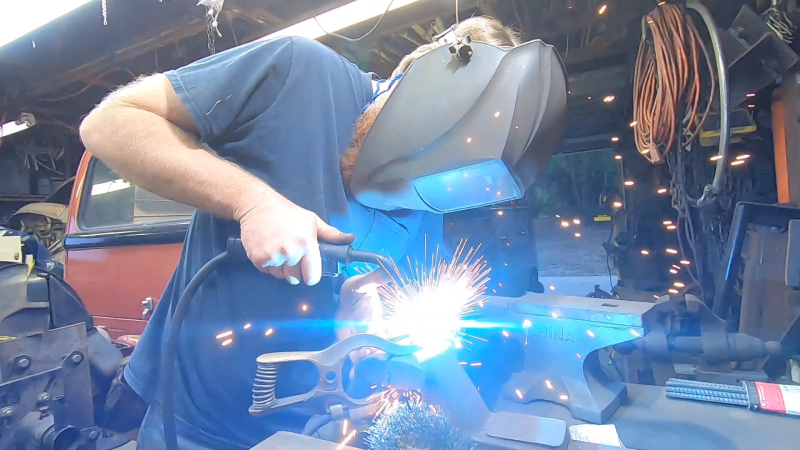

Removing the clutch cable revealed a part that was close to the end of it's service life, thanks to a lack of lubrication and the rigors of normal duty.
In the name of saving a few bucks, it was welded up and re-drilled. No, it doesn't really make sense. Unless we're using hobby physics and don't want to wait for a new repop...
