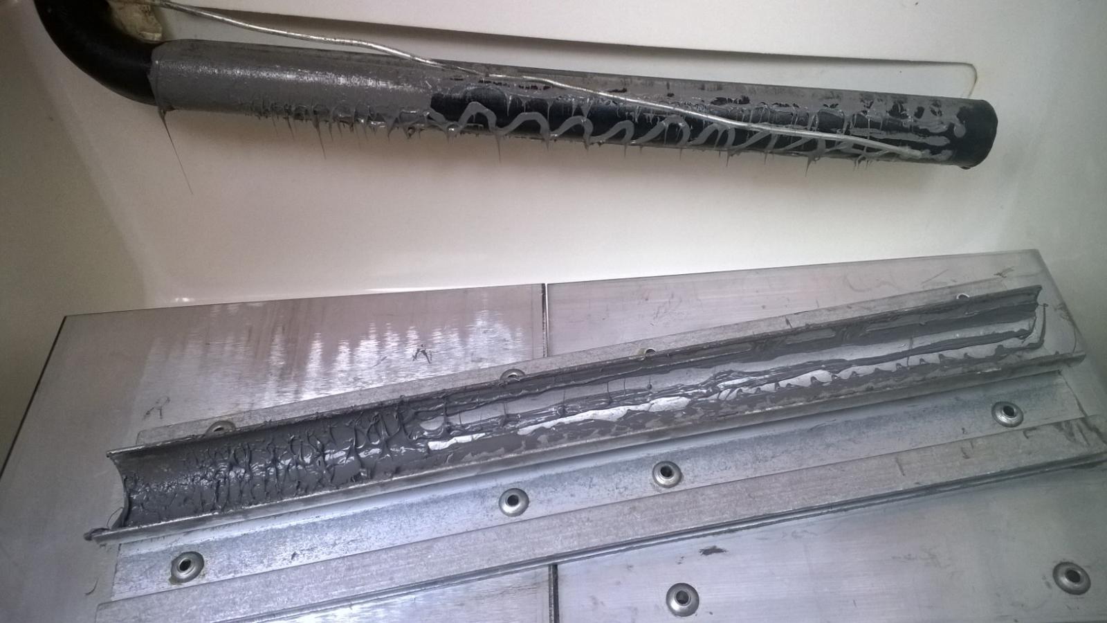

Making progress. Cold plate is off and I noticed that there seemed to be a liberal amount of thermal paste used on mine. Contact looked good except for two spots on either end. I question if there was too much paste and if that was impacting performance.
The cold plate mates to the cooling tube via a half-round channel. The half-round channel is riveted to the fins on the cold plate. On the right-hand side of the cold plate there is a slight gap between the rivets where the half-round channel meets the cold plate fins. I was able to slide a feeler gap in there about a 1/2" before hitting thermal paste. If my rivet gun will fit in where it needs to I'll remove the rivets and re-bed the right-hand side.

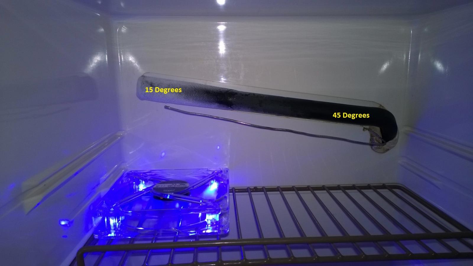

I fired up the fridge on propane to see what happens to the cooling tube. After about 90 minutes it gets pretty cold and the frost has been moving across the tube left to right. I left the fridge door open for this test and at the moment the back end of the rig is up on blocks. So the fridge is not level and the back wheels are about 4-5inches higher than the front.
Based on what I am seeing with the temperature differences I would think it would be better to have nothing but fins on the left side and skip the ice cube tray shelves. I have made ice cubes with the fridge to see if it would do it however I just use the trays now to store food I want to keep close to frozen like chicken breasts. It seems like having fins on the left side would be better overall at cooling than the ice cube tray shelves. Also that seems like the best place for an interior fan. Heck I even wonder about skipping the cold plate and just mounting a fan to blow down that tube.
Thermal paste is something new to me so here is what I think would work http://www.frys.com/product/8454178?site=sr:SEARCH:MAIN_RSLT_PG Any feedback on that stuff. Also it calcs out to about 15 square inches of surface are that needs to be covered.

It looks like my fridge had more goop on the cold plate than what VanagonNut shared. It almost looks like there where numerous spaces with no goop. This thermal paste stuff is all new to me so I am not sure if more or less of the factory stuff is better or worse.
I had a computer fan handy so I tried just letting it blow on the cooling tube. After about an hour it knocked the frost off that can be seen in the prior picture except for the end. The 4" fan definitely helped cool the fridge down however a smaller fan blowing down the tube lengthwise would probably be a better arrangement. Interesting idea that I think may work better than the cold plate itself with a little fine tuning. I am headed to Yellowstone and the Tetons on Saturday so no more time for experiments:-)
I reattached the cold plate to the cooling tube with Arctic Silver 5 from Frys Electronics. It was $20 for 12 grams and seemed to have more metal in it than other offerings. My electrical engineer buddy said metal is good for heat transfer. Not all thermal paste is rated for colder temps and only go down to 50 degrees. Arctic Silver is rated below zero so I felt good about that. 12 grams seemed like the right amount of paste for the job. I put 4 stripes of paste on the cold plate and 1 zig-zag stripe on the cold tube. The factory goop was probably 1/16" of an inch thick and this stuff probably spread out to be more like 1/32" thick or less. It seems like this product should do better than the factory goop. Time will tell. To help bed the cold plate on the cold tube I rotated the cold plate back and forth about an 1/8 of a turn to help it spread out the paste. I also used a heat gun and warmed the cold plate up to about 115 degrees to help soften the paste which I think helped bed it securely. I plan to do a couple more heat cycles with the heat gun before I turn the fridge on. The product says it can take up to 200 hours to cure. In a couple days I'll let you guys know if the cold plate falls off once I fire up the fridge:-)

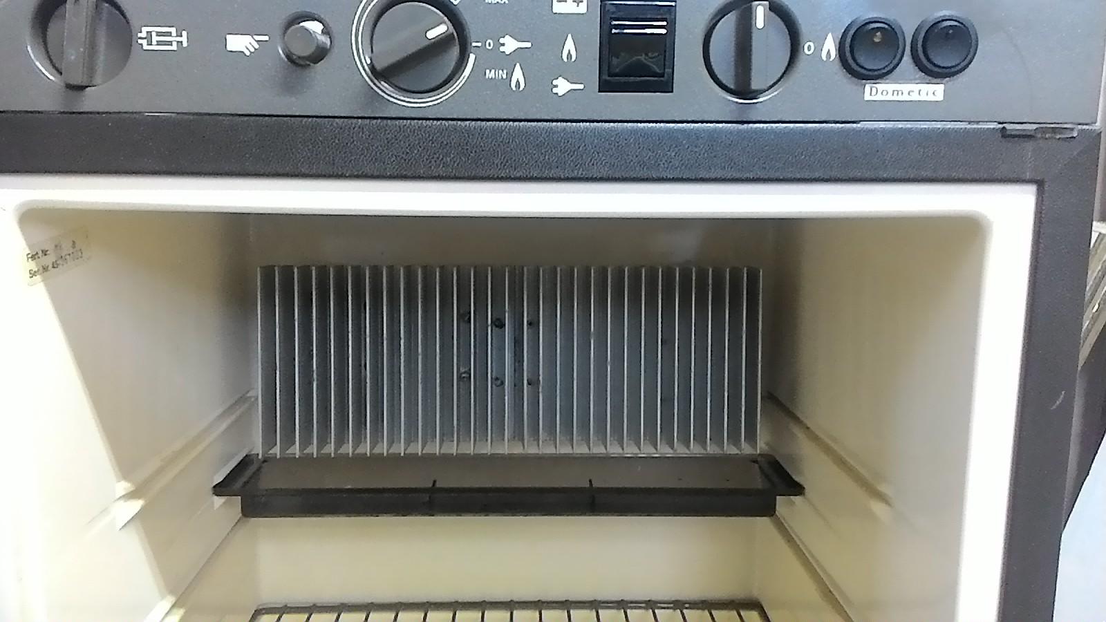

I am following up on this post because I followed thru on the modification of installing the second full size heatsink from another fridge.
(note on thermal paste- I scraped off the original paste and thinned it with a few drops of denatured alcohol and reapplied heatsink, only as this is a test.)
If you want to copy this and can not source a used westy heatsink just purchase new heatsinks from ebay and replace all original heatsinks
ebay "100x69x36mm Aluminum Heatsink"
I am also considering to add more heatsinks on the backside, from
ebay - "heatsink 60x150x25mm" these can be cut and added.

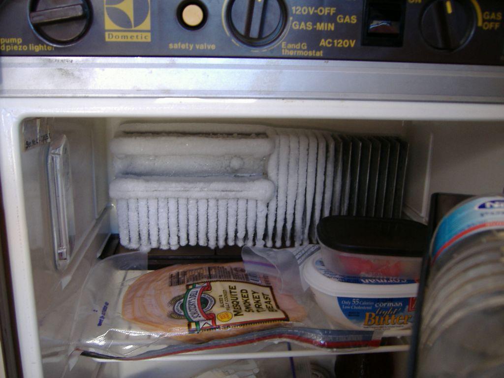

One thing I noticed on one of my 182's was that ice tended not to form on portion of cold plate below the small cpu fan I installed. I wonder if, and how, fan speed (how fast air is moved) relates to efficiency of the cold plate(s)?

It seems the left end is the colder end on mine.
