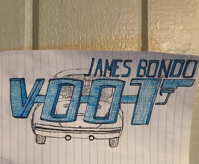

I found a 68 Bug that had a crushed roof due to a tree falling on it. I brought it home and commenced to my first chop top endeavor. Since all cars need a name, and due to the amount of body filler used to fix my welding imperfections, the 68 was christened "James Bondo V-007." I drew some door art using the VW script. I flipped the Volkswagen "L" to make the "7".

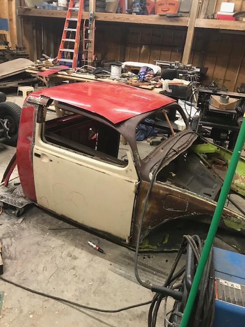

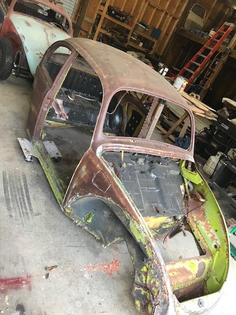

And just like that project V-100 was born. I found this body
and found a wrecked Ram for $200 and the surgery commenced.

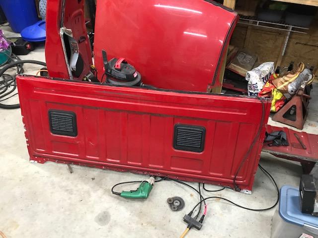

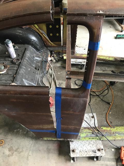

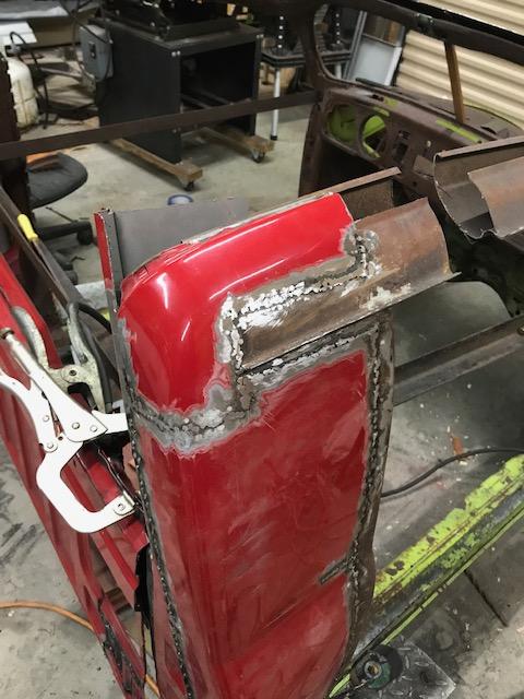

Parted most of the Ram out and made my money back +++. Cool I still have plenty to do but I'm happy with my progress so far. Th Ram had vents in the rear section of the cab, which I wanted to keep. Luckily they were narrow enough that I was able to save them.
I cut out the rear cab corners
and transferred that to the V-100
Did the same for the roof corner too

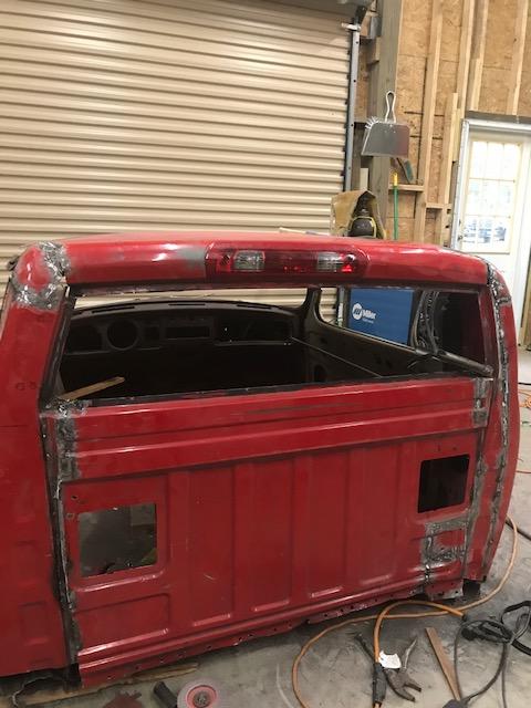

PostPosted: Wed Jan 27, 2021 6:50 pm    Post subject: Re: My junk Reply with quote
Somewhere along the line I ended up mis-measuring or mis-cutting something, which put the driver side an inch shorter than the passenger side. This caused the back glass area to be all jacked up. So I cut out and rewelded two days worth of work. I got the sides within an 1/8 of an inch, which is good enough for me.

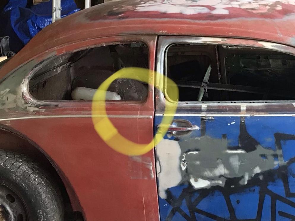

Nice work. Is the roof widened and stretched on the first bug?
11.41 et buggy. Long gone
The first bug has a Fernon's chop, so the roof is laid down, the a-pillars canted in, and a pie cut behind the two back windows.
