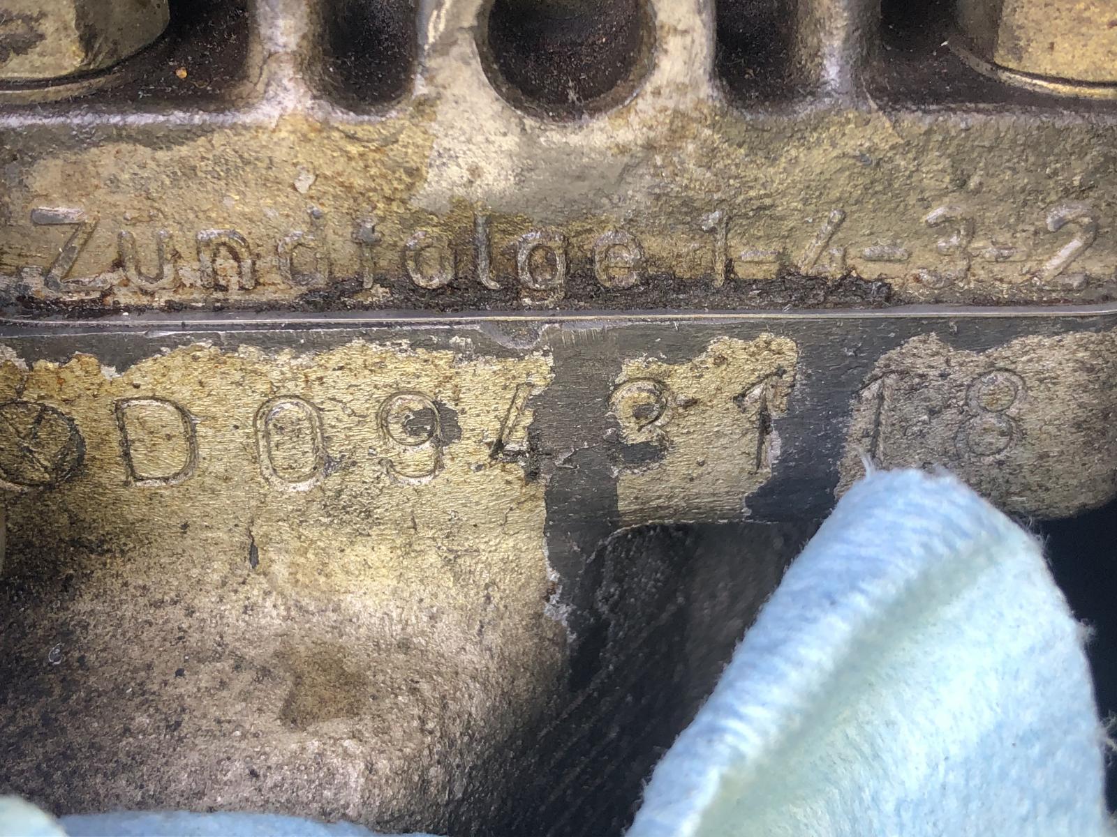

So my engine stamp below the generator says D0943118. Does that provide the engine size to purchase all my tuneup parts?
As I said she’s a ‘72 with a VIN code preceded with a 142........

142 is a ‘72 Ghia. If the AD 0 engine has been basically left alone, it’s a 1600 Dual Port, dual relief case.
Do the basics first, adjust the valves, compression test, set the timing, verify spark and dwell if you have points, clean the carb and make sure the choke and idle solenoid are working, fuel pump too.

If it’s a D engine it’s a 1200 which definitely will feel lacking in power although it should still run smoothly.
If it’s an AD then the manifold from the carburettor will go down to two rubber joints which connect it to cast aluminium end pieces bolted to the cylinder heads in which case it is a 1600.

Double check that engine number.
72 Ghias should have an engine number that starts with AE.
https://www.thesamba.com/vw/archives/info/chassisdatingkg.php
AD series engines were in beetles and busses.
Both AE and AD engines were 1600 dual port, so no harm in that swap if it is an AD that you have. If you have a D0 series engine, then as mentioned that's a 1200cc with less power than your car should have.
It's not uncommon for our cars to have had their engines swapped at some point, since they're mostly all interchangeable. Also be aware that the engine number doesn't necessarily tell you the size if the engine has been rebuilt, because engines can be rebuilt to larger displacements fairly easily. Pics would help in determining what engine you have.

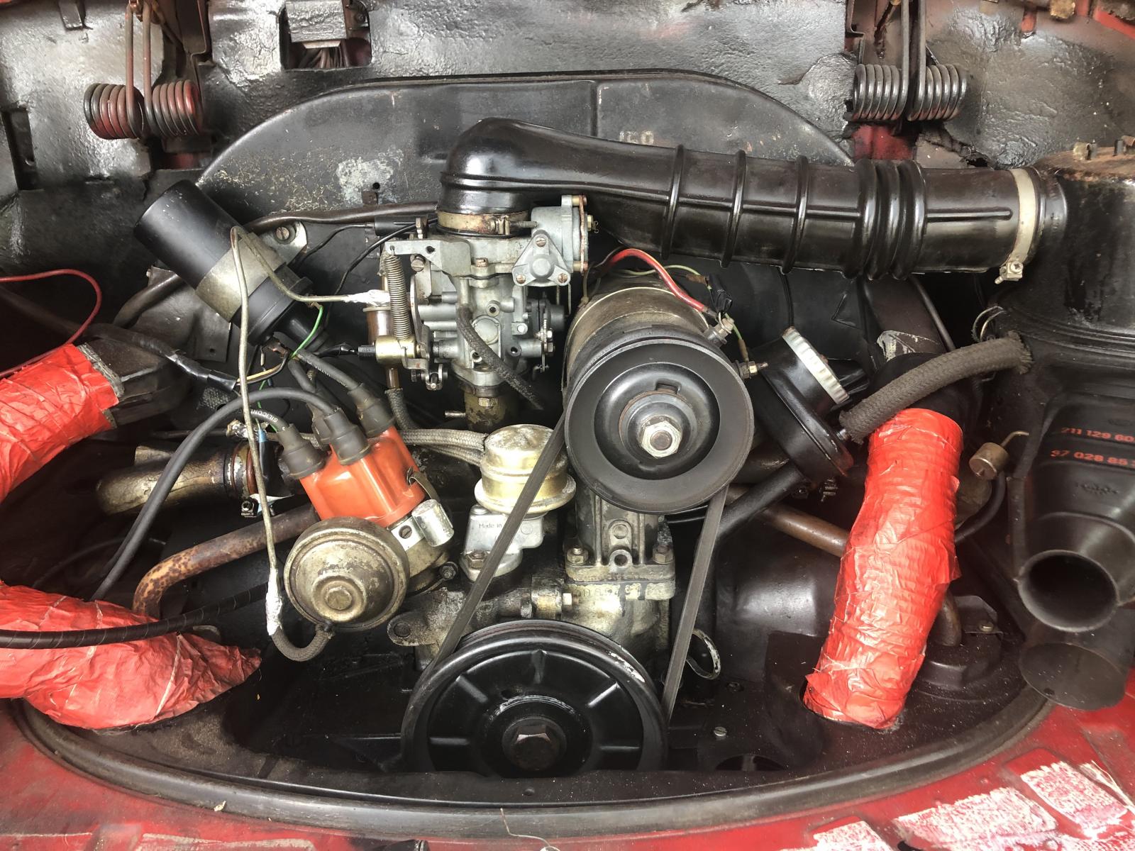

Great information and feedback. I’ll post pics as soon as I get to it today. I’m mechanically inclined with an auto hobby shop (military base) full of tools and lifts about six miles from my house.
Pics coming soon for more clarity. I’m not too familiar with (points), etc.
It’s definitely apparent the previous owner did not change the oil and bits lately, so that’s the first thing. Any suggestions on oil for a humid, really hot climate...we do get a cold snap at times during the winter season.
Any links to tech manuals for spark plugs gap, etc?.

PostPosted: Tue Jun 23, 2020 8:33 am    Post subject: Re: all New to Me and Rearing to Go!!!! Reply with quote
Here are two pics. One closeup with the engine number and another pic of the entire engine....hopefully this will help you help ME... Shocked !!

I am a newbie in training but let me be the first to say that a fuel filter in the engine compartment can be problematic.

Got it. I’ve read that in other post. Any suggestions on a more robust fuel filter. This is the same type filter my rider-lawn mower uses. Major fire hazard; I know Confused
It seems to be fine to use the same type of filter in the line underneath the car. There is even a special bracket for one: https://www.thesamba.com/vw/classifieds/detail.php?id=1901747

Yeap, I just found a video suggesting that exactly. Now gotta replace all the lines, so I’ll reconfigure it all to set under the car. Thanks for the detail look at the pic Laughing

Definitely a D0 engine Pics below. Either way, I'll work with what I have for now and go on a quest to find an AE engine for a swap later on....

The engine has definitely been reworked. You can tell by the dual port end castings it has dual port heads on it so who knows what’s been done. I lived in Florida for a lot of years, kind of similar weather to Louisiana except maybe not as humid. We ran 10/40 and 20/50 usually but that was before they took all the zinc out of the oil so you want to be sure to add some of that back in.

Lloydjr72 wrote:
That is a D0 case that's been converted to dual port, so there's no telling what displacement that engine is. If the seller you bought the car from told you that was the original engine, I'd give them a serious word or two if it was me Cool
A 1200 case would likely have smaller oil journals, and also only one oil pressure relief valve. It would be interesting to see if the fan shroud would've been converted to a doghouse fan shroud. A doghouse shroud will definitely be a benefit for cooling in the southern heat.
