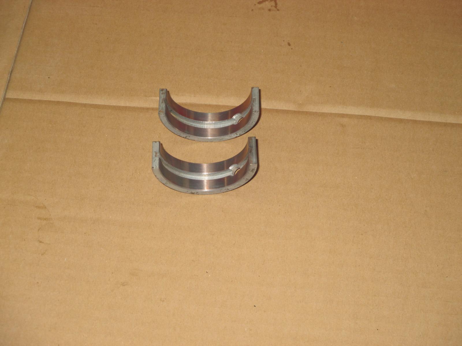

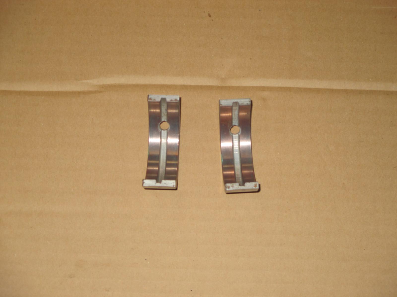

I have a NOS set of std/std/std main bearings and the #2 split bearing is steel backed with internal oil groove which I like for my straight drilled crank. But the bearing surface has a "copperish" color and Have not seen this before other than on some thrust surfaces of the #1 bearing. Is this normal? These are from the clevite Mexican bearing set

I wonder if someone swapped their worn split bearing into a new set and turned it back in for a refund. Get the part number and contact the person that sold you the bearing set. Have them check sets with same part number.

Those are either copper or beryllium copper plated. Its not "new"....but I have not seen it much (not that I build so many engines that I would constantly be in the know).....but I have seen them before.
Here is an example.
https://www.ebay.com/itm/1934-59-Dodge-Plymouth-21...ke%3ADodge
and another:
https://www.daidometal.com/product/engine-bearings-half-shell-bearings-4-stroke-diesel-marine/
As this one notes...mostly used in diesel and two stroke engines. Some of that may be for load...because copper was used a lot in bearings.... because it has high temp range , is softer than ferrous metal and...in most cases with "bearing grade" copper ...is alloyed with lead. Think of it as a high temp harder version of babbit.
The other reason why one would like to have something like copper in a diesel or two stroke is that their oil is MUCH more acidic.
Copper is typically used somewhere in these systems...even if its just a plug of copper on the end of the oil pan plug or a small block or a plating somewhere in the system...because it acts as a sacrificial electrochemical anode to neutralize acidity when it gets excessive.
This is common in transmissions and steering gear boxes as well.
Those are cool! Ray

thats not a aluminum backed bearing...unless it's been copper plated...witch I doubt they do. I think it's missing the top coat/layer of material.

indeed some bearings are copper alloy right on the face, not common but some, and others like many from federal mougal have only a very thin flash plating which is so thin it really does not matter if it is there or not, so I don't know.
Maybe one of our members in mexico would look it up if they have a catalog from when clemex existed.
As I noted...virtually all bearing companies I have seen....copper plate for certain applications. Why would you say they don't?
As I noted...Clevite has numerous copper coated bearings out there. Mahle bought Clemex in 2008. Mahle owns clevite or is at least merged with it. Their technology is now "one" even if they are seperate factories still. You could find anything in the boxes from those three brands now.
As Modok noted.....the copper flash sometimes listed as "brushed copper"....is REALLY thin. Its designed.....I would suspect...as a start up sacrifical coating. Copper is really soft and depending on the alloy....self lubricating. Much better I would suspect than the lead/tin/copper top layer most bearings have. Ray

Inside groove is German Kolbenschmidt.
You see the brass when it is worn down on the #2 bearings.
My take on it -someone machined an undersized bearing set to accomodate a journal. Or..someone got desperate and tried to remedy something.

So, now not sure what to think or do. Should I use this #2 bearing as pictured above with my straight drilled crank or use a #2 bearing that has the oil groove on the out side and drill a one additional oil hole in each bearing half of an external oil grooved bearing.
The bearing pictured is absolutely steel backed.

If it's steel backed I'd use it.

I don't mean to be Captain Obvious here, but ultimately what matters is what the clearance is, not what the box says, right?

I do not like the steel backed bearings, but I use them,I would coat it before using it...as i do all bearings. Ive used clemex,never had any issues with them.i figured it was clevite of mexico...so i may of been rong it may be cleavland of mexico...or just a bearing manufacture of mexico that uses the clevite method of over lays ans is licensed to do so...or....just the name of the company trying to be passed off as clevitte like somany off brands tend to do. as far as the al on the box that looks like a sticker/label that was allpied for a generic term part# I do have a sort of NOS fedralmougol al bearings..and they were infact dfl coated by the factory probably 35 + years ago...bearing coatings are nothing new and they were trying to address the issues they these bearings have....gaulding.

You mean....galling.... Wink ...yes. and that is exactly what copper plated bearings are for as well. As I noted earlier...these are not uncommon in diesel applications.
Copper is one of the best anti-seize/anti-gall metals. Ray
