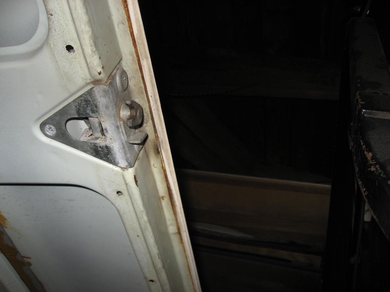

The hatch aligment and tension was good against the striker so I figured it must be somthing inside the latch causing the problems. BTW, The Bentley Manual 1963-1967 instructions for adjustment of the hatch strike plate are one of the rare things I've come across that aren't correct to nomenclature. In The Bentley section A-12 page 8 just reverse the wordage and you will get it right. I decided to take my latch apart and refresh anything I could to improve it.

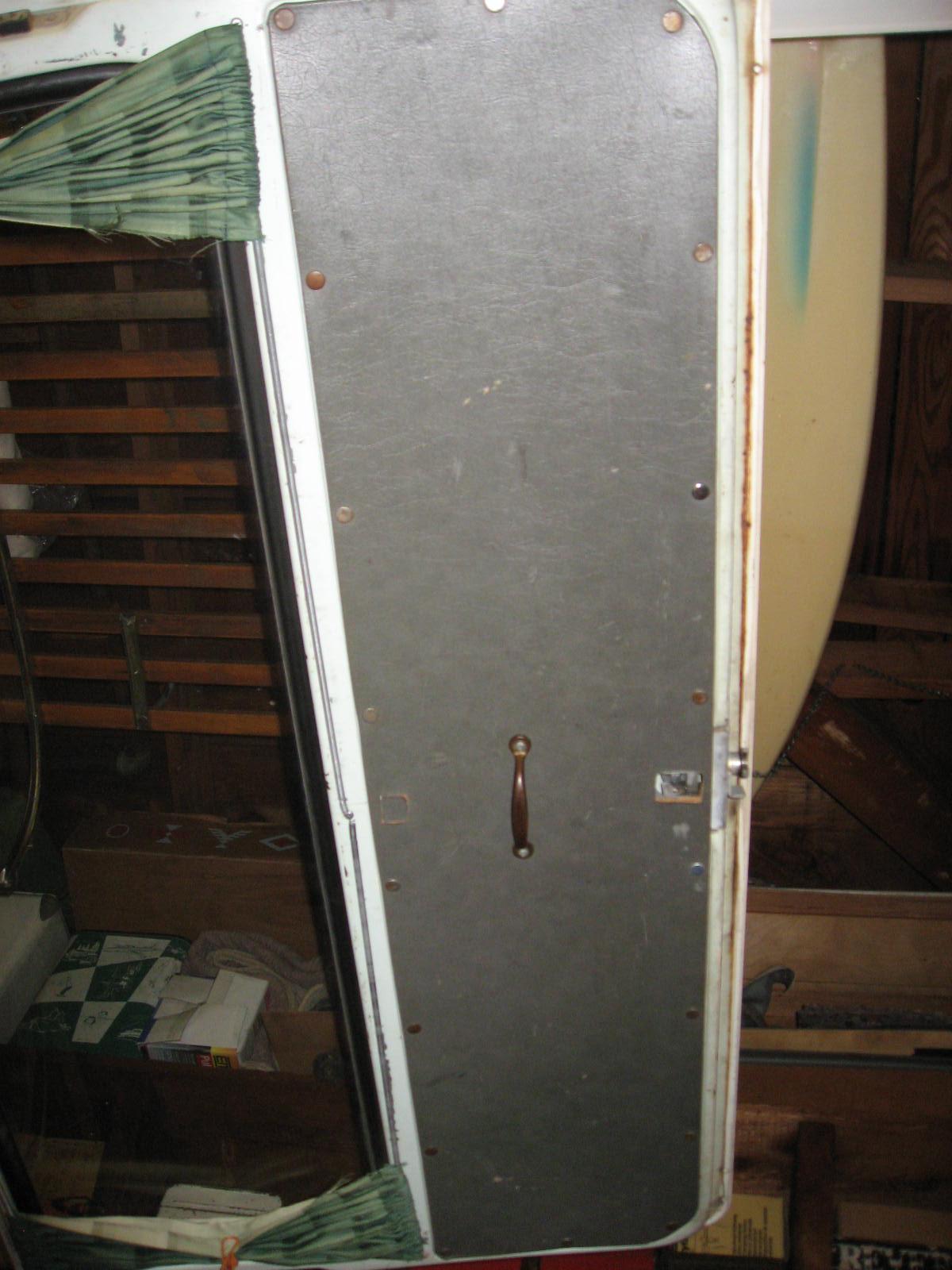

The hatch has a panel that has to come off in order to remove the mechanism. I use a door card tool and a folded piece of plastic heat laminate so the paint doesn't get scratched and the vinyl on the card panel doesn't rip. Go around and pop all but one button on each far side. Hold the panel as you take off the last two buttons so it doesn't break.

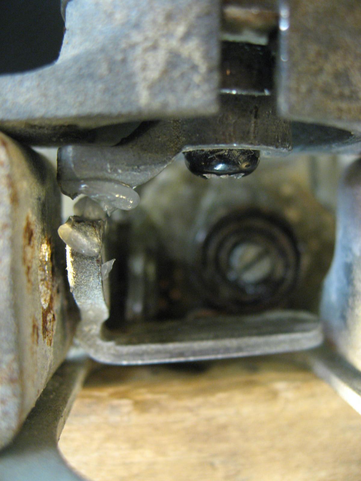

This is the simple latch/catch mechanism. When the hatch is closed the part in the foreground swings to capture the post on the jamb-strike and hooks under the pointed lever. This is where there will be wear as well as the shafts where there is motion. It can be welded and shaped but mine is barely worn so just a cleanup and lube for me. If you do weld, clip the welder's ground right next to where you weld, not where the current can travel through the rotational springs or you run the risk of the springs losing their temper.

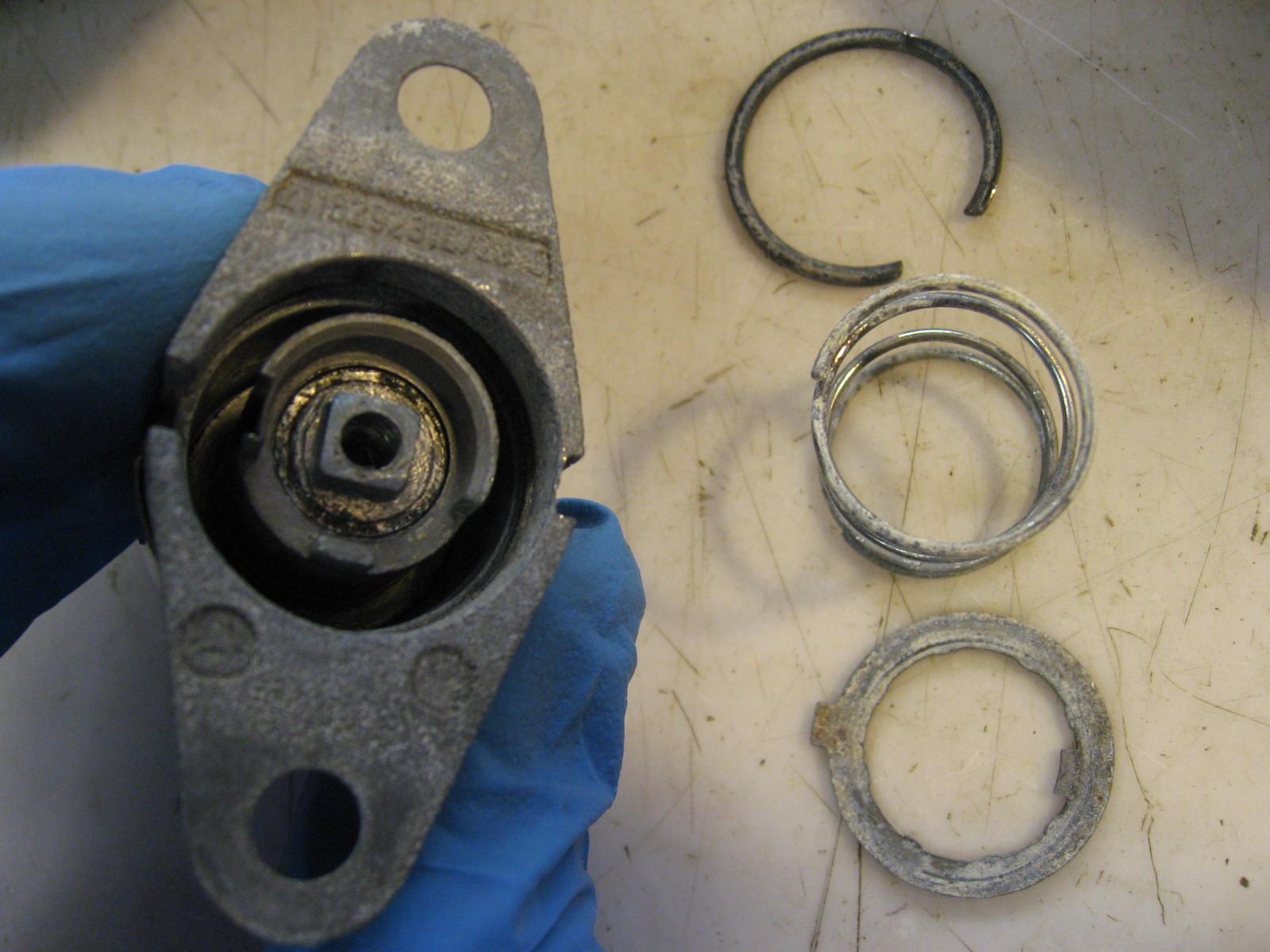

This is the push-button lock tab. This part is not weldable but can endure considerable wear. Take off the screw, beveled star washer, and remove the lock tab. My black screw is an improvement in length as the OG screws are Wimpy.
Next to come off is the internal snap ring. I used a small slot driver to push the ring at the casting side opening and stuck another tiny slot driver into the ring gap to free the snap ring.
Push on the button and all will come apart.

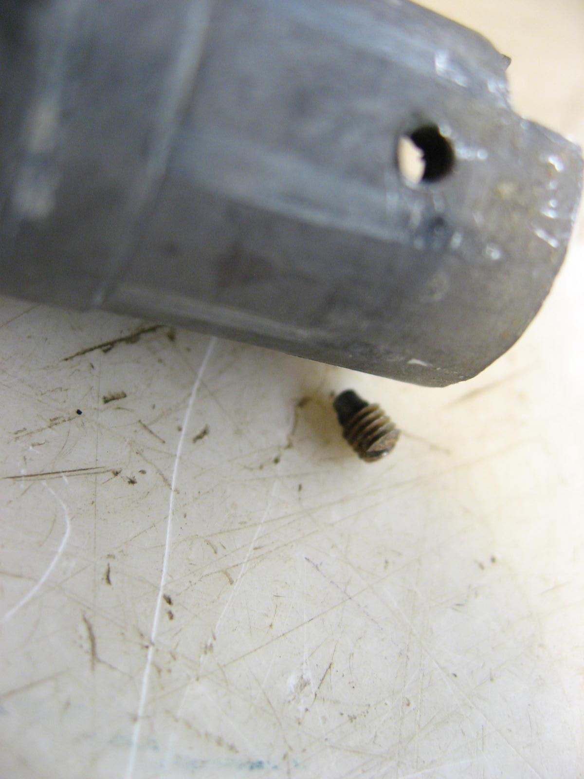

Find this tiny screw and remove it with an eyeglasses screw driver. Put it in a safe place for now.
Now put the key (if you have the correct one), another key (if you have a VW key that will poke into the lock all the way), or any key or piece of thin coat hanger wire that will go all the way in. Push out the lock mechanism and don't remove the key (or whatever you used). These locks are the same as front door locks, BTW.

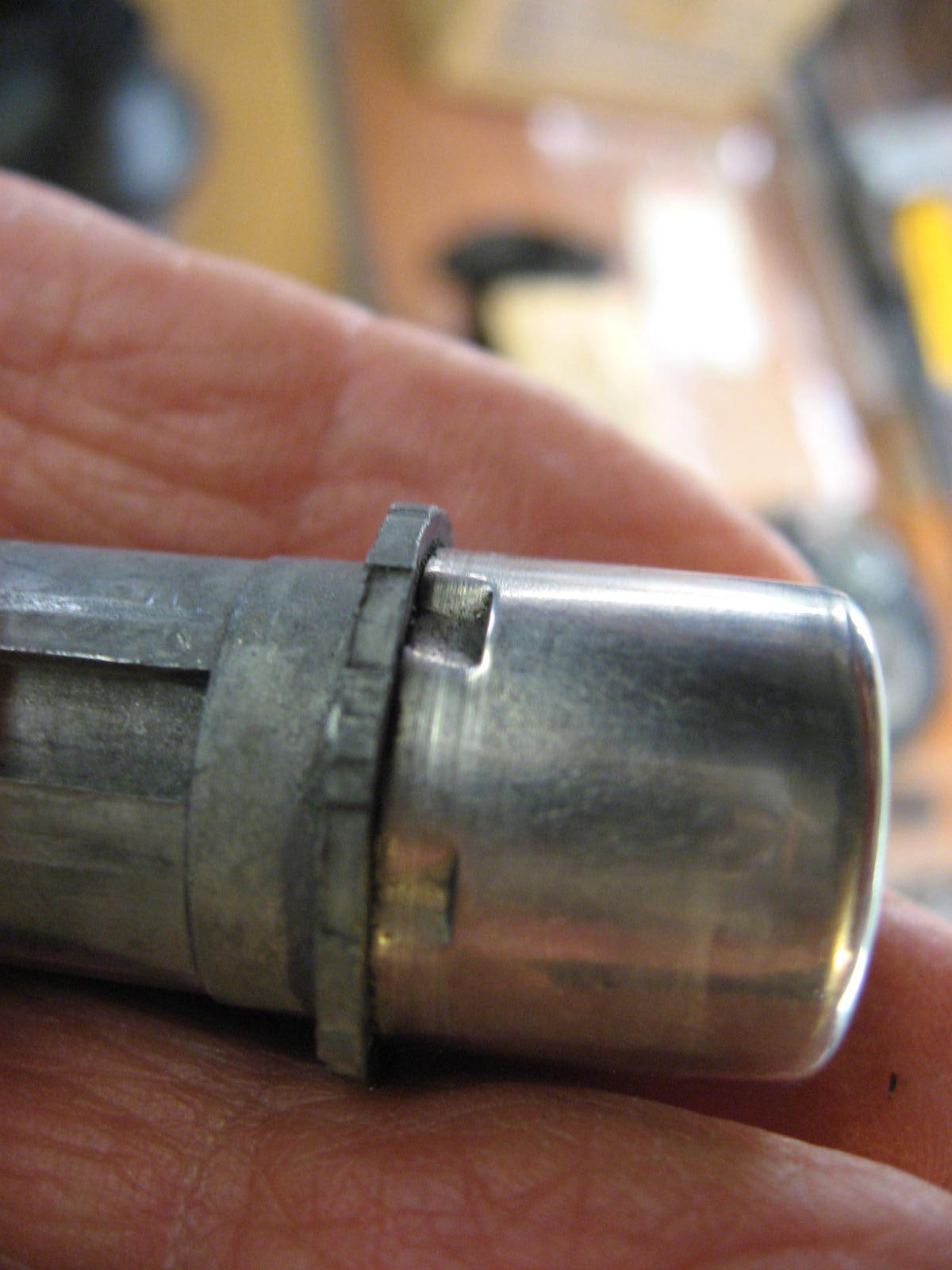

First is the escution sealing the hatch from the stainless steel cover over the button housing casting.

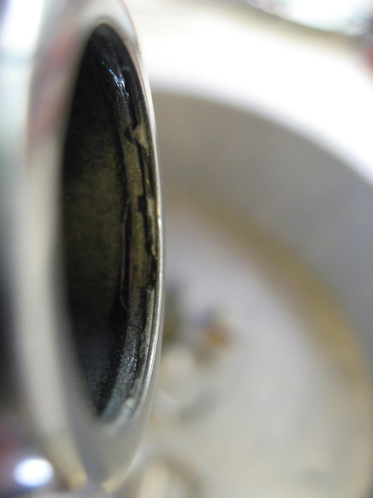

Second is a nylon insert between the stainless steel housing cover and the casting. The seal consists of a circumferal squeegie that rides along the outer
stainless cover over the button. Mine is disentigrated and not easily replaced as the stainless outer housing cover is peened in two places. If someone has an intact nylon seal I'd like a photo added please.

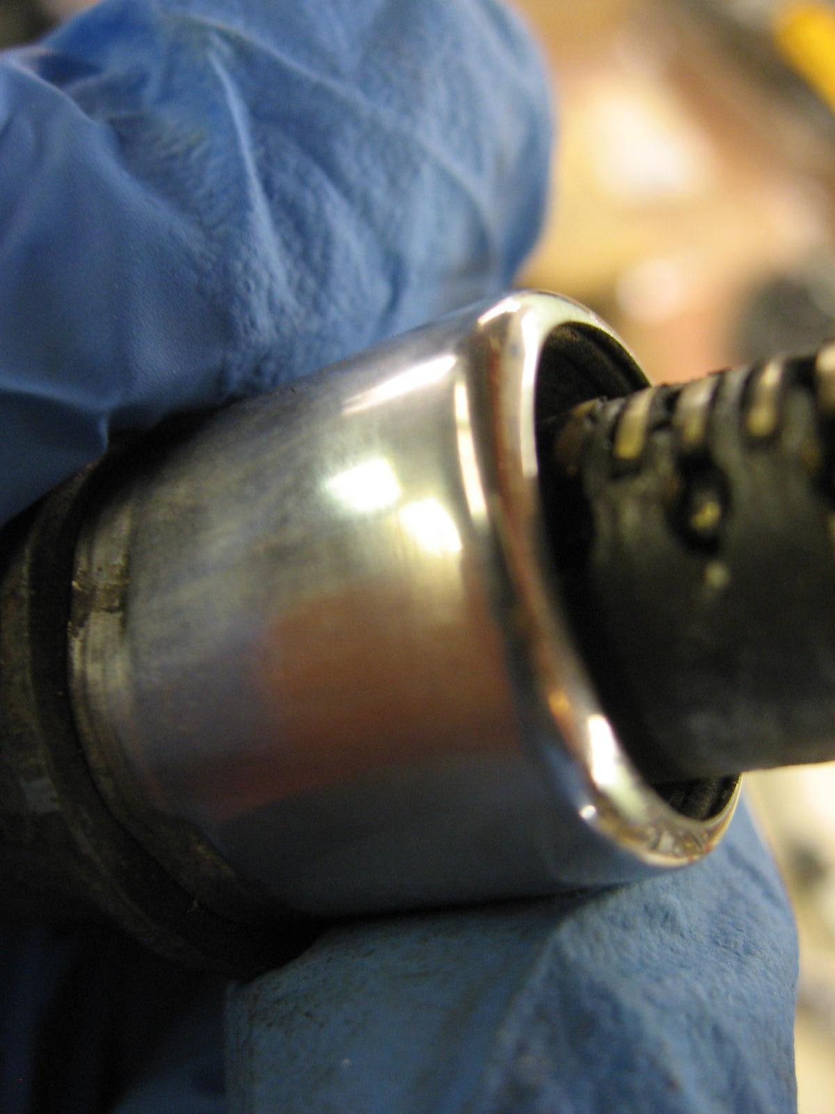

The third seal is the outer o-ring that seals against the outer button cover when the button is in the un-pressed or sprung-out position.

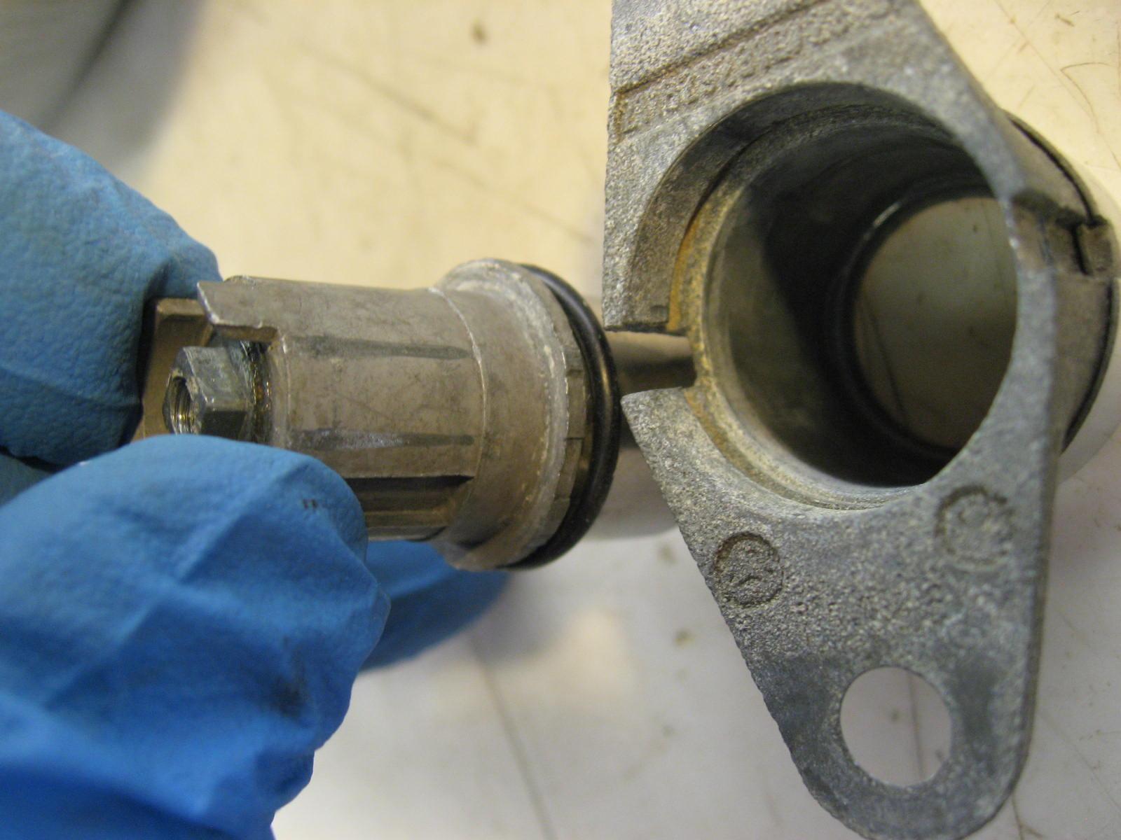

The fourth seal is the small inner o-ring of the button that seals against the lock outer stainless cover (see previous photo small inner o-ring). Luckily my inner o-ring was still good as this o-ring is hard to replace since the stainless button cover is also peened.

This is why my button was hard to press and hard to turn the lock; the outer o-ring had disentigrated as well as some of the nylon squeegie.
Reassembly is the reverse of disassembly. Put on a new o-ring. You can use two o-rings here if you want the button to not stick out as far but I use one. The o-ring is a hardware store plumbing o-ring Lincoln products part. Lightly grease the outside of the lock barrel making sure to get some grease into the setscrew channel then insert it having the key still inside.
Put in the setscrew until it bottoms out in the channel then back it up one half turn. Test the lock and make sure it travels 180 degrees without binding on the setscrew using the key.

Reinstall the fresh latch and test/adjust your striker.
