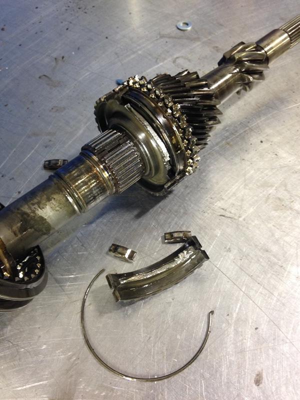

PostPosted: Fri Jul 10, 2020 1:41 pm    Post subject: Re: 91 Syncro - Stuck in 3rd - Tranny still works other gears Reply with quote
Mine shifted fine in all the gears. Was inside for an unrelated issue and found this.
This was out of an 87 syncro tin top with a possible 170K miles on it.
