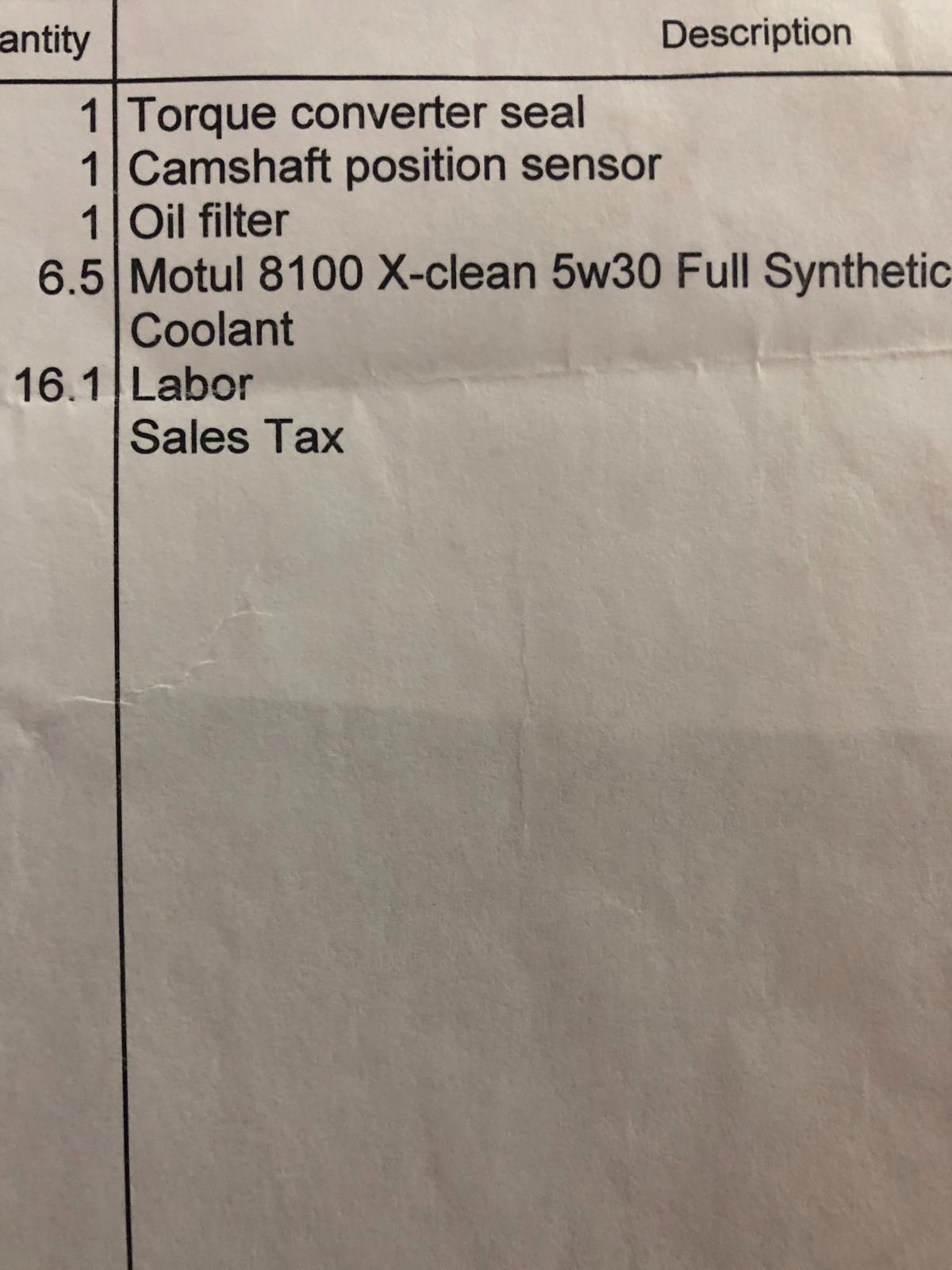

I have updated both of my cam positioning sensors with Bosch OEM and cleared the codes. I headed out for a weekend jaunt and the check engine light is back. Sad
Some of you may recall this work being done on my van with the previous owner:
Nancy, to make sure this thread is completely on topic, here are all of the steps that were taken for my timing chain repair. Replacing my sensors did not eliminate any codes for me. I am told that I might have a cam gear issue. I have started a thread on that back in December in hopes to learn more.
https://www.thesamba.com/vw/forum/viewtopic.php?t=728713

jmciii wrote:
When I called the shop that did it, the timing gear was not addressed alongside all of this work which is probably regrettable.
It says right on the invoice "intermediate gear". Perhaps you've experienced a failure with one of the other timing gears (I'm not suggesting you have), which would be surprising; it's the intermediate gear that is known to fail prematurely, and they replaced it.
jmciii wrote:
(Worth noting that one of the sensors that I removed is for a Porsche Cayenne and not a part number that I can attribute to my van at all. This shop is a Porsche-first place as far as I can tell and I reckon they just threw whatever they had in there for the previous owner.) Evil or Very Mad
The Cayennes shared the same VR6 engine, so the sensor is probably the same part but with a Porsche part-number.
Get the proper scan-tool and figure out what's wrong. Piecing together random part-replacements with non-descript CELs and then fuming about what the shop may or may not have done, when you don't understand what the shop may or may not have done, isn't going to diagnose or fix the problem(s).

Stripped66, please note that I have engaged the shop in conversation in addition to evaluating their invoice.
I might be wrong about "fuming" about the sensor. You've been right to call me out on that. But, the shop itself is telling me that they recommended that the previous owner replace the (a) timing gear and he declined. This was through phone conversations. I think I'm doing a thorough and responsible job engaging the shop, which is unfortunately in a different city, to understand what they did and didn't do. So, I think you're being a little dismissive and harsh in your response.
I have a set of detailed codes. I've shared them elsewhere in the forums. here. I came into this thread to ask about transmission fluid and I appreciate the guidance. -John

So, that is not the actual invoice of work that was previously done to your van by the shop in question?
Allow me to be a bit more dismissive: Start your own thread. This thread has never been about transmission fluid. Your comments related to the engine timing components were initially on-topic, but the whole transmission discussion is off-topic and not related to the original poster's inquiry in the least.

jmciii - I definitely recommend getting a proper scan tool or getting in touch with someone who has one. The generic readers give you generic codes like "cams out of sync" or "O2 sensor failing" whereas the VCDS tool will tell you which sensor is failing, and where. It's a LOT easier to pinpoint issues. Often times there are other issues that might not be obvious, like transmission codes which may signal some other impending problem.
Looking at the shop invoice and hearing about your dripping I'd be a little worried that it's the torque converter seal. But the best thing to do is to clean the area very well and then see where it's dripping. It could be as simple as a drain plug that needs to be snugged.
Remove the belly pan if it isn't already removed, and then it's pretty easy to slide underneath. Being able to work on the Eurovan without jacking it up is one of its many charms. Smile

I apologize again for introducing trans fluid into this thread. I absolutely invite commentary on my cam gear thread and I've rekindled an original inquiry specific to that topic.
I read the following comment from you as rude and dismissive and not something I've experienced here yet. If I read it wrong so be it.
I have an invoice. I have phone conversations with the shop. I have feedback from the prior owner. I have codes, however vague, so I'm doing what I can to understand what the shop did and didn't do. I don't think I'm asking for clairvoyance. I think the shop that did something to create a transmission leak when they repaired the timing chain. I think the sensor codes that Nancy is experiencing has something to do with the timing chain repair on my van as well. I think it's all related.
