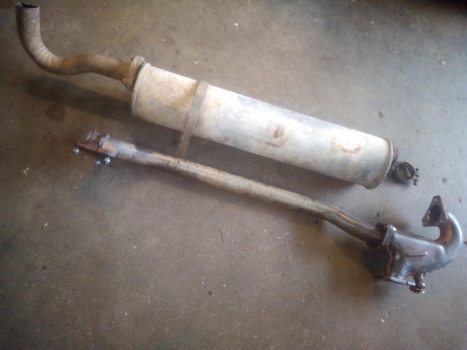

Here is a stock setup i pulled from a 1978 engine. Muffler is a Liestritz dated 1983. I still need the short pipe from muffler to the manifold

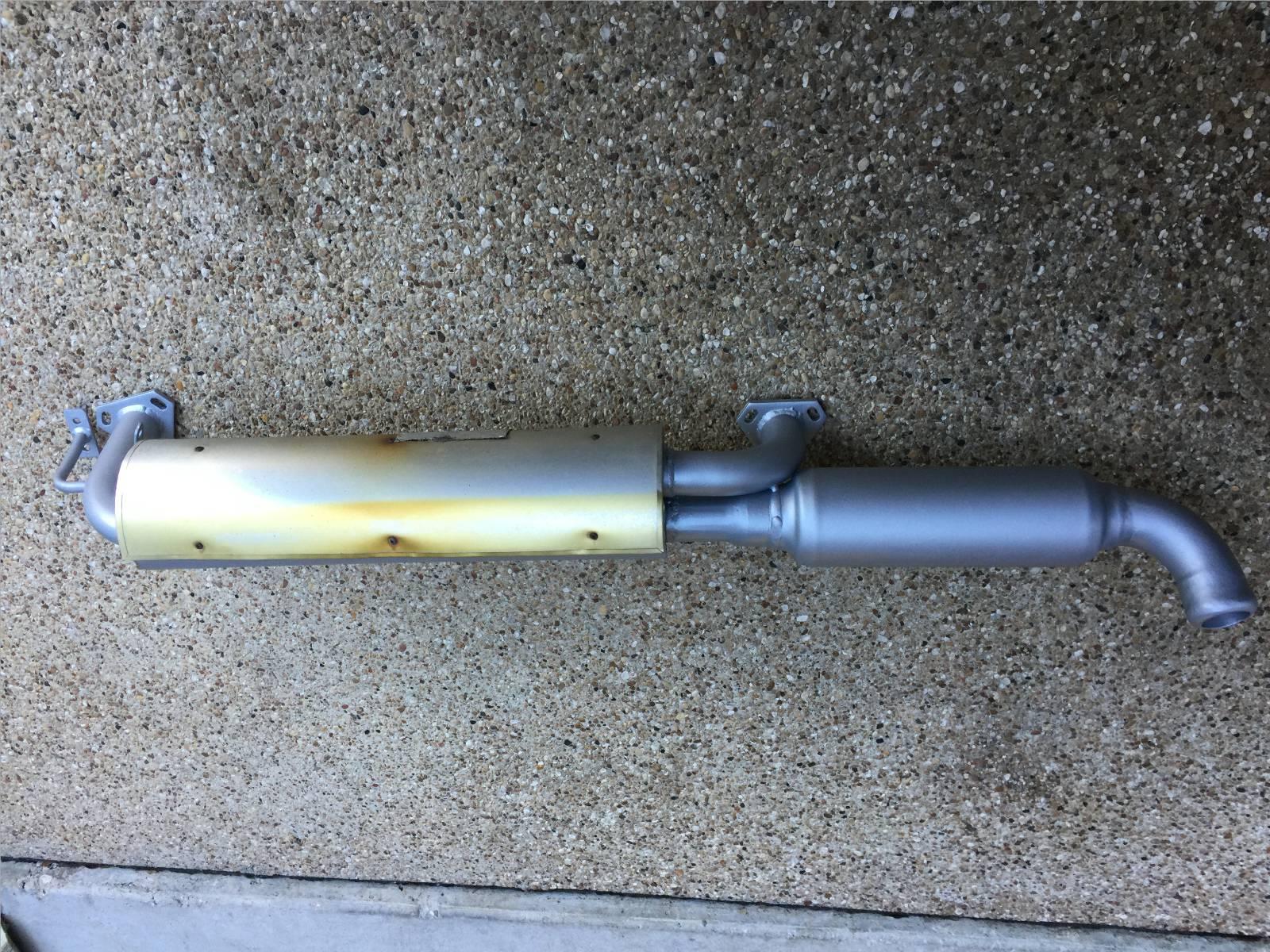

I welded at glass pack on my Pacesetter exhaust and it makes it much quieter. I’d say 95% as quiet as stock, which is as quiet as you will ever get a bus.....

I will talk to the muffler shop about this, and will bring your pics.
You mentioned " ....and adding a small resonator and additional stinger tailpipe."
what does the stinger do with respect to sound?
When I scheduled the bus for the muffler shop, they said the will be looking to put a resonator on it.. but will have to see the layout that I have...

If you go back to that first link you referenced, the resonator is the can shaped extension that replaces the original pacesetter tailpipe; most people refer to them as a “glass pack” so I do also. The “stinger” refers to the tip of the exhaust pipe, where I added a baffled inner pipe to reflect sound waves back against and theoretically cancel oncoming sound waves. Sometimes perforated metal cones are used for this purpose, but those can also add back pressure.
The stock pacesetter is obnoxiously loud at full throttle, and the fiberglass packed resonator attenuates a broad range of those frequencies. The longer the resonator, the better, but you’ve only got so much room to work with. If you want a really quiet ride at cruise rpm and load, you could consider a Helmholtz resonator, as those are better at eliminating specific frequencies

Yes, I did test with just the resonator and it’s highly effective. I added the baffled tip to the end and it also made it a little quieter, but not nearly as much as the resonator. I also tested two resonators With the second one being 75% longer than the first one) and that made a really big difference but I just didn’t have room to put the second one in place without perhaps curving the pipe up under the battery or something And then put a U pipe on that to turn the exhaust back towards the rear. That would also involve rubber hangers to hold the system in place which adds a little complexity but from my testing of the two resonator system I believe it could be even quieter than the factory set up

Back from the shop, and it is a lot quieter, so still a bit louder than I would like, but I think it is just below the threshold for an attention getter.

Pacesetter with a resonator is still not as quiet as stock setup, but for the money it’s pretty close and it will probably last the life of your bus.
