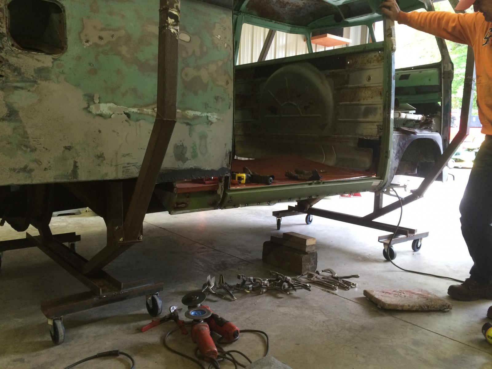

I just got in from welding new cargo floors into this bus. Even though it's been blasted clean there's still remnants of green in lots of corners. The green steering wheel is something I've never seen before either, I'm waiting for a picture of it to come through..

PostPosted: Fri Jul 29, 2016 6:21 pm    Post subject: Re: 1964 Split bus Turkis/Blue-White interior factory color? Reply with quote
That is an odd one. Not even a really early 1962 as in a late 61 production year. Someone must have been hung over from the night before.
