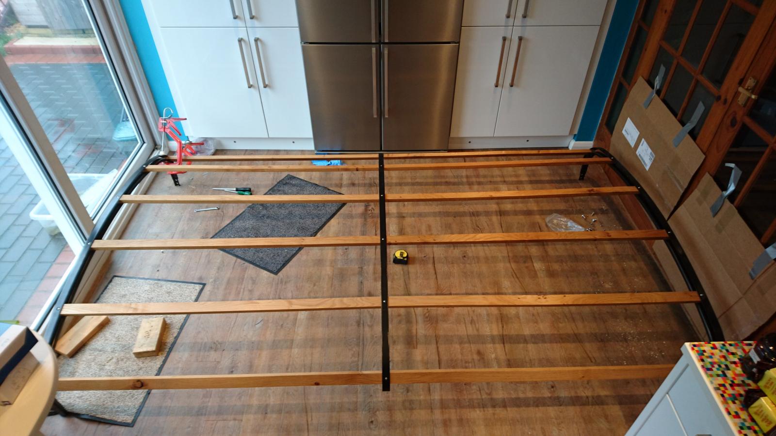

I had some hoop slats made from local English Oak. I used a satin Decking Oil.
I chose it because it's for outdoor flooring, so copes with some wear and resists water sitting on a horizontal surface. The brand was Barrettine, but I'm in the UK - not sure if that brand is available in the US.
Most of the outdoor weatherproofing oils that I looked at were only designed for vertical surfaces where the water will run off, rather than sit on the surface.
I also filled any knot-holes in the timber with epoxy resin to stop water getting inside the timber. I stained it with a black dye that enhances the knots. The resin flowed in to the knots that ran through the timber and filled them.
This is what it looked like before I sanded it back and applied the decking oil...

Never heard of Barrettine in the US, but we'll have an equivalent (Thompsons water seal). Thanks for the tip!
