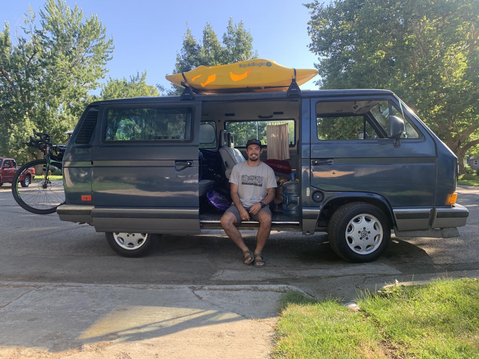

Hey all I am the proud owner of a ‘90 vanagon GL converted to a Subaru 2.5. Professionally done by the PO at Metric Motors outside SLC. I’m curious to know insight on electronic issues anyone has had post conversion? Currently my brake lights are not working, or any of the turn signals; but, clicking the running lights on. All four blinkers are illuminating as daytime running lights! Bulbs are not the issue here. The indicator light on the dash is a solid green, no audible “clicking” occurs when the signal is engaged in either direction. Hazard flashers do not work either. All visible fuses in the box are clean and not blown, the larger black “cube” fuses, IDK how to check those so see if they are blown?
