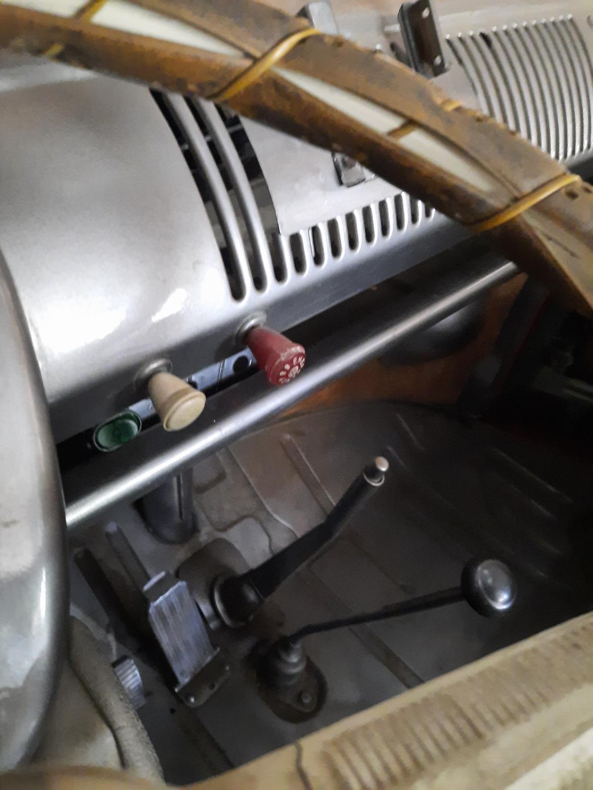

Is the dash pull-switch no longer for sale new for spit-busses? Mine is bad.
I have 2 different issues as to why the emergency flashers aren't working. Tested the switch and then tried using Matt Roberds troubleshooting guide and I think I will have to run a 2 or 3 prong universal flasher switch. I'm running a dual relay system I put in some 12 years ago from ??? and the turn signals work, but when I bypass the flasher switch nothing happens.
Not sure.

PostPosted: Wed Nov 04, 2020 1:25 pm    Post subject: Re: blinker / e flasher problem 67 12v Reply with quote
Helps to know the year of bus.
