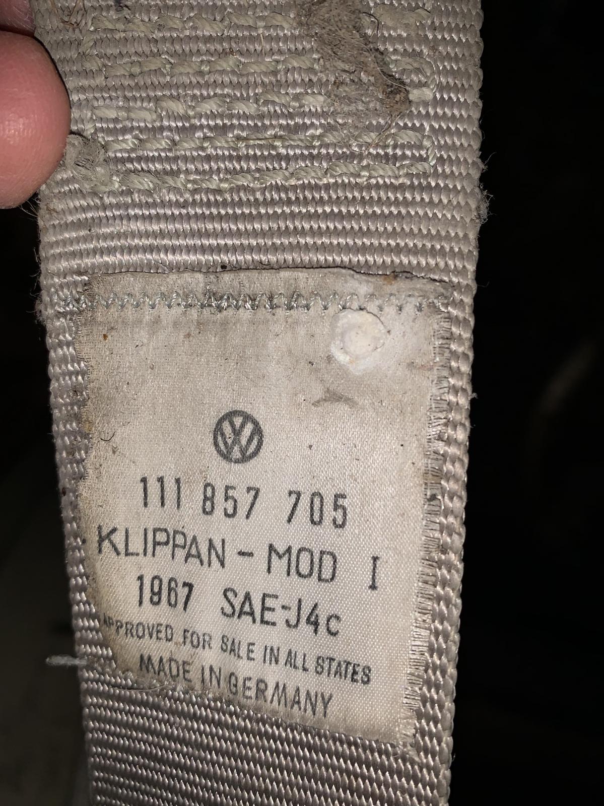

PostPosted: Fri Oct 16, 2020 7:01 pm    Post subject: Re: 1967 front seat belt labels Reply with quote
This is the tag on my 1967 sedan. 111 857 705
Just thought I’d share.

PostPosted: Sun Oct 18, 2020 5:56 pm    Post subject: Re: 1967 front seat belt labels Reply with quote
Yes sir. I'd assume that's from your drivers side on a sedan. The ending of an odd number is drivers side and the even number is passenger side. So the 706 would be a passenger side reel.

harrymarlin
Joined: June 07, 2018
Posts: 782
Location: Washington, DC
harrymarlin is offline
PostPosted: Sun Oct 18, 2020 6:12 pm    Post subject: Re: 1967 front seat belt labels Reply with quote
Oh my goodness! How did I not know this up to this point? It looks like I only have labels for one side of the car!
<sigh> oh, well. Goid information, Jos! Thanks!

Snotraveler
Joined: October 16, 2018
Posts: 11
Location: Minnesota
Snotraveler is offline
PostPosted: Sun Oct 18, 2020 6:16 pm    Post subject: Re: 1967 front seat belt labels Reply with quote
Yes, it is the drivers side. So many little “details” to these cars! Thanks for the info.
Jos.Hall
Joined: January 29, 2011
Posts: 348
Location: Sunny So Cal.
Jos.Hall is offline
PostPosted: Sun Oct 18, 2020 6:26 pm    Post subject: Re: 1967 front seat belt labels Reply with quote
harrymarlin wrote:
Harry, my mind must not have been working all those times we were discussing it. The nomenclature only triggered in my mind when I saw the 705 and the 706 next to each other. I believe the only difference between left and right seat belts though is the adapter bracket.
